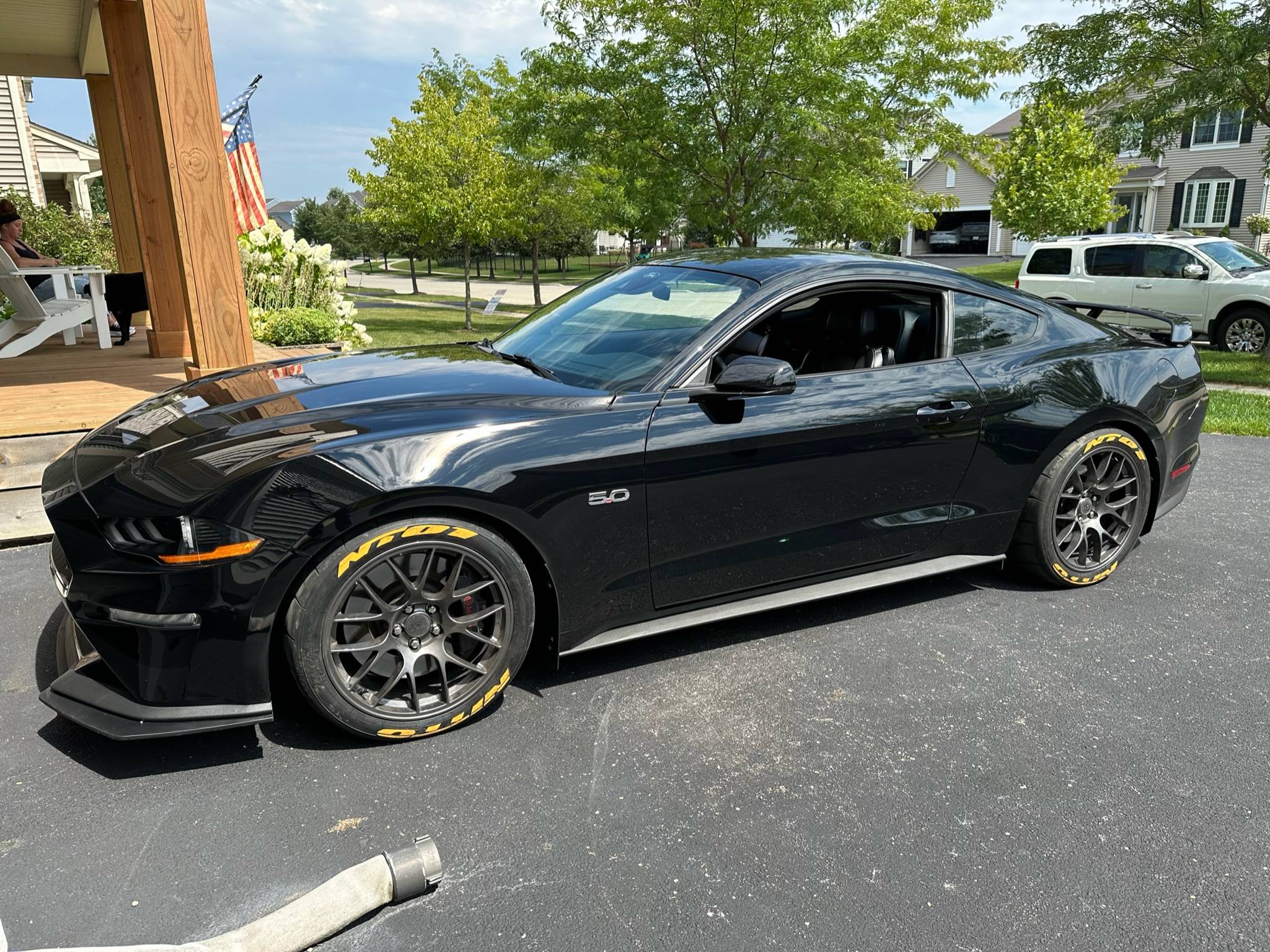

I have 19x10 with 285/35/19 PS4S and much prefer the look over PP1 staggered. The tire fender gap is a bit larger with the smaller diameter tire. My plan is to go to FP track springs, shocks, and bars and that will lower the car slightly. I prefer to lower as little as possible since I drive the car on the street as well.

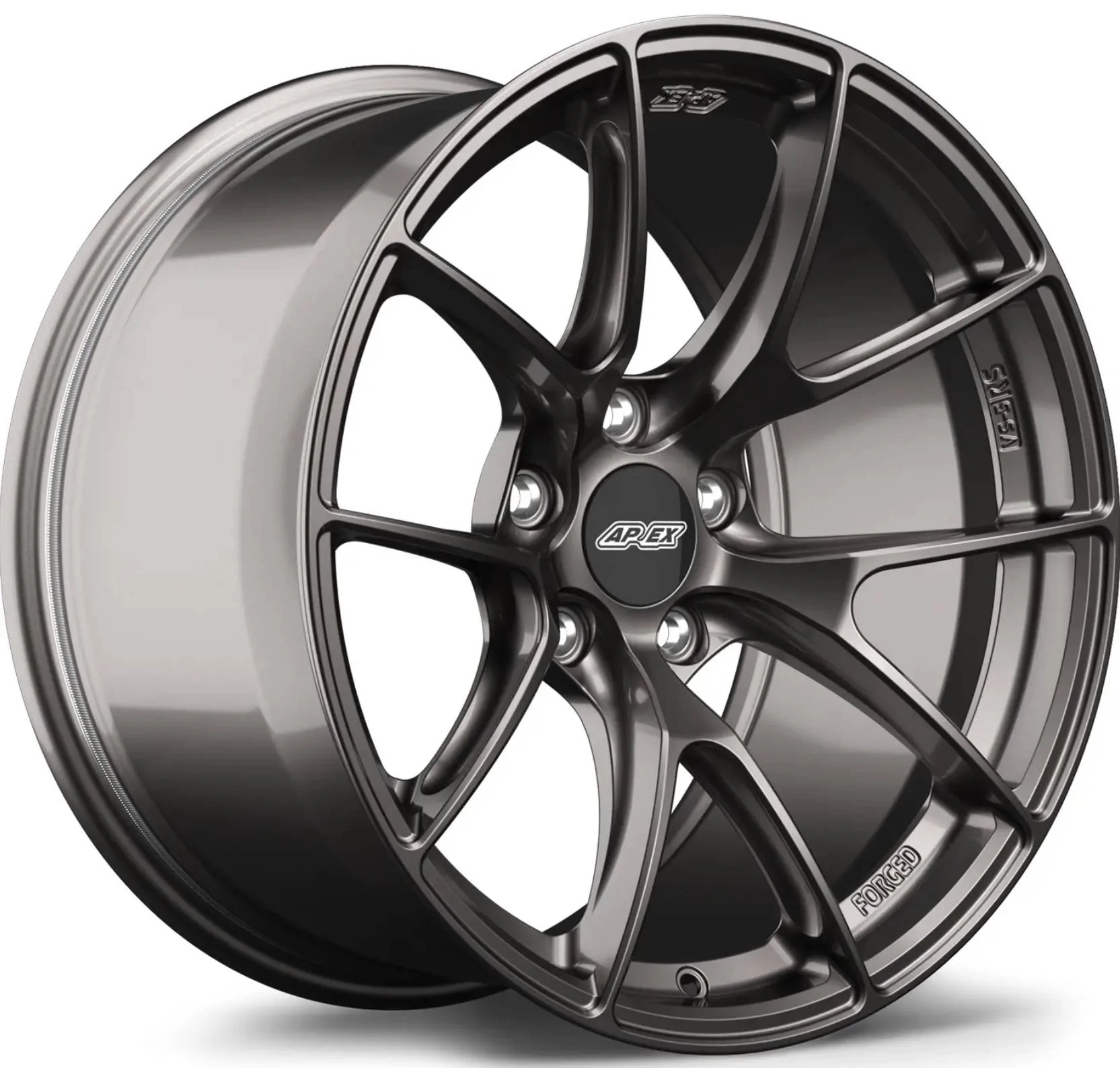

I have both a 20x10 (Project 6GR Tens) and 19x10 (Apex EC-7) squared setup. The 20’s are my street setup with 285/35/20 PS4S. The 19’s are my track setup with 285/35/19 Nitto NT01.
I‘m lowered on Eibach Pro-Kit lowering springs. I like the wheel gap and stance of the 20’s, the 19’s look good as well but a little too much wheel gap for me for daily use. Track wise they’re perfect.
