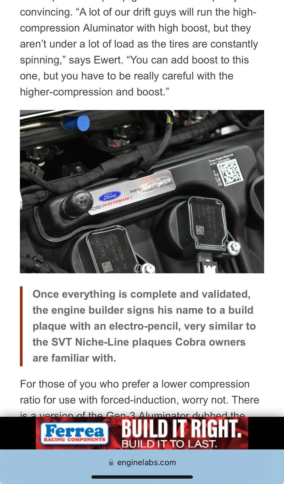

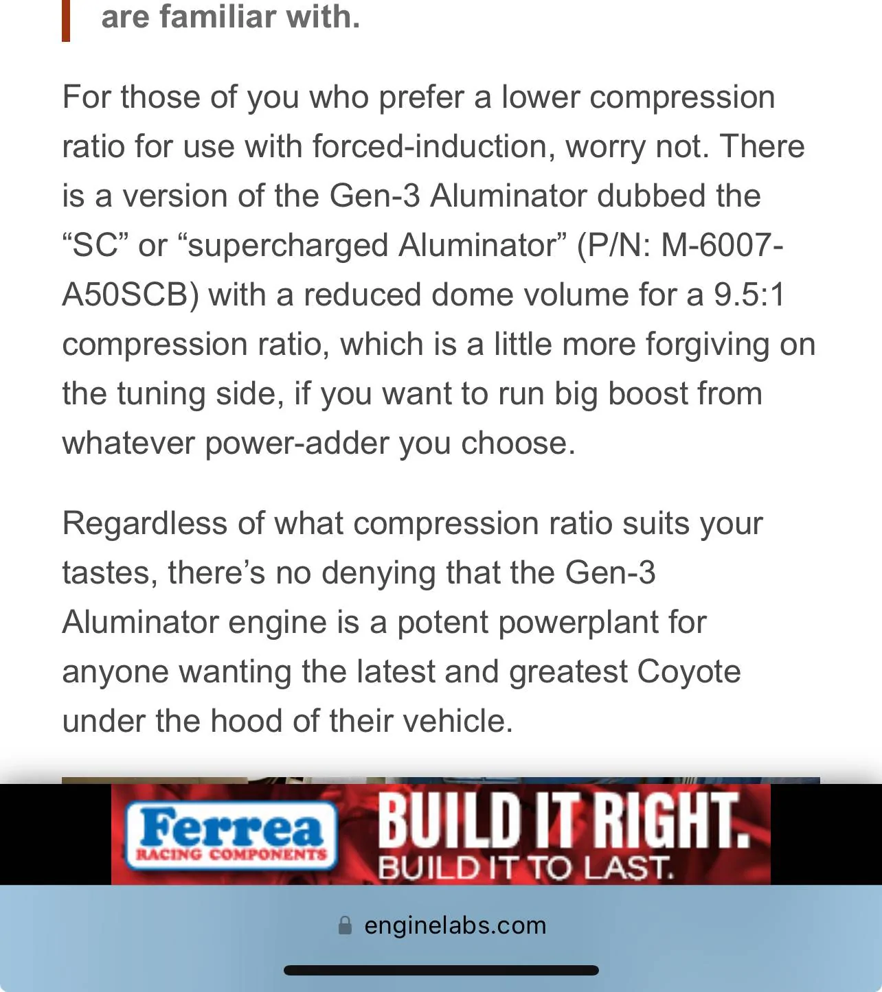

I wonder why Ford made a 9.5 alluminator motor for boosted applications and a 12:1 for N.A. I guess it’s for warranty purposes 🤷‍♂️

Directly from a Ford Engineer
