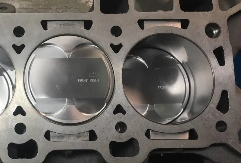

I got this built bottom end from RPG with the ARP studs and billet OPGs. made 980 wheel at 5500 rpm (before my charge pipe blew off) on about 17 psi. RPG said this block can handle 22-24 psi. Make sure you get 12:1 CR. kept my gen 2 cams and heads. RPG customer service is also on point

On a gen2 block it’s recommended that you get the supports in the water jacket to make 1200whp but 1200whp has been done on a sealed gen2. on a gen3 you are good at 1200whp on stock block as long as the cylinder coating doesn’t come off.
On a supercharged engine valve springs and not a issue. You can build your short block to handle 1000+ for under $3000

I ordered the same Gen 3 level 2 short block from RPG but got the block sleeved and o ringed for an additional $2700. They suggested that I’d be fine till 1200whp without sleeving, but being that my factory block failed at just 500 miles after Whipple install and had cylinder scoring on #8 on just 11psi running pump gas and boostane (Lund tuned), I didn’t want to take any chances.
