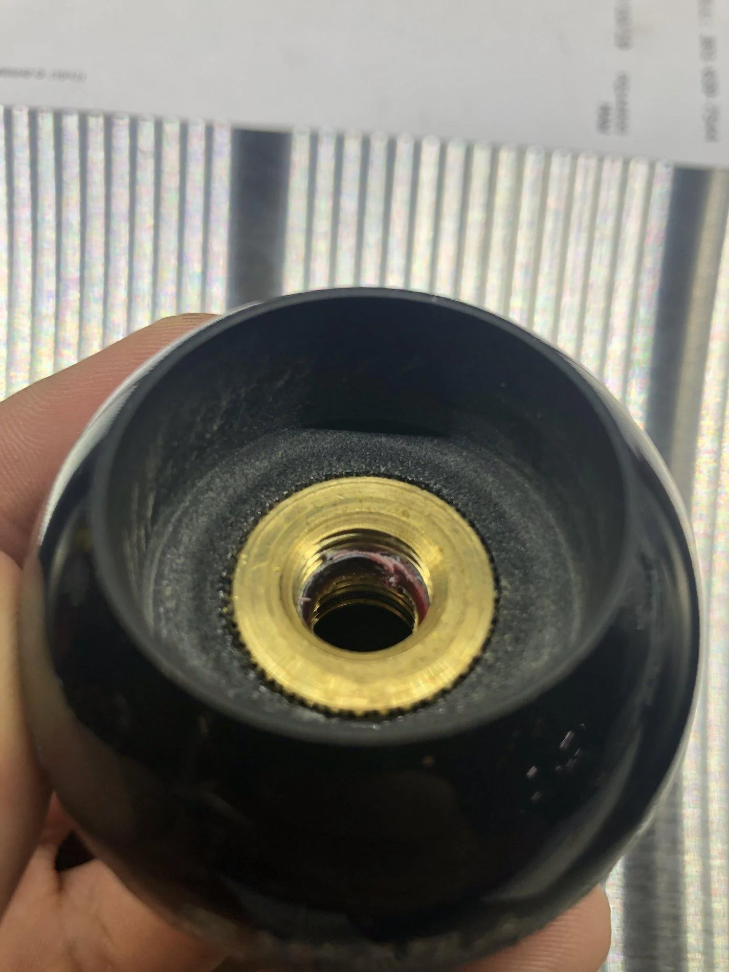

Had the same problem on mine. Previous owner used red loctite. I used a heat gun to heat the knob up. I wanted to save the knob but after some time of trying to get it off, I said the hell with it. I put a pair of channel locks on it and it still didn’t come off. I ended up turning the shift lever inside of the shifter body itself. That’s when I used the heat gun to heat it up, had a buddy hold the lever with a pair of vice grips, while I went to town on the knob with the channel locks. It came off after that
