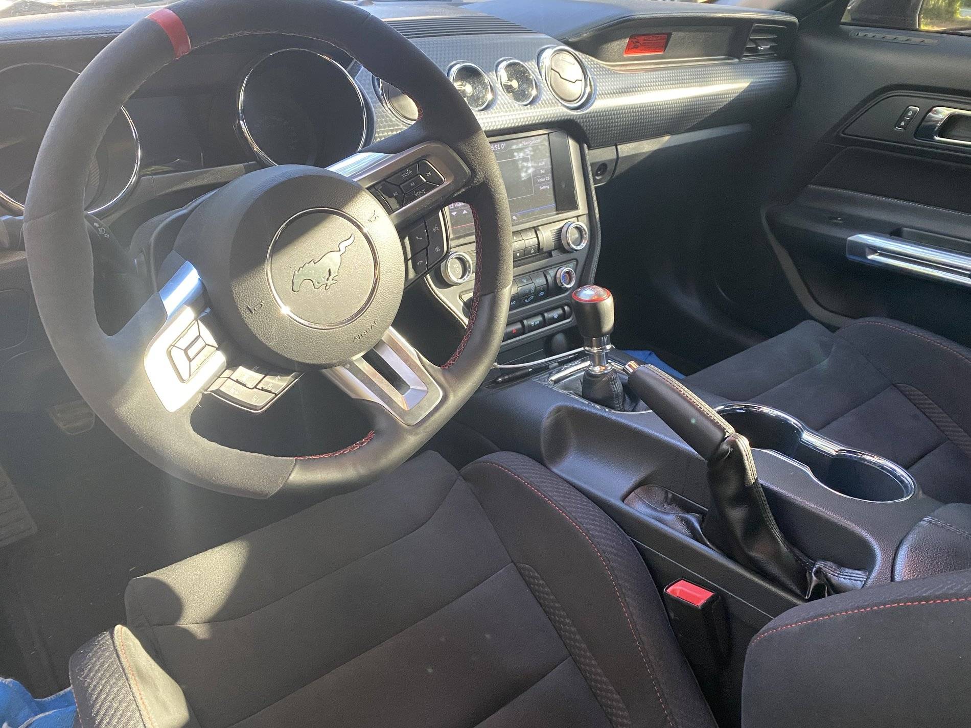

I balled up pieces of paper towel and stuffed them in there and compressed them until I got the perfect clearance for the reverse lockout. No loctite which means it will screw off when I need it to and paper being somewhat of a vibration damper.
