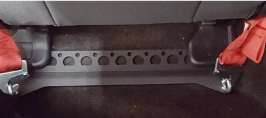

You will need a harness bar for the Schroth harnesses (stock seats? 4-point ASM is very good).
Otherwise, if you have racing seats, go with the 6-point harnesses.
Cipher Racing Harness Bar Ford Mustang (2015-2023) S550 CPA5018HB-BK
Watson Racing Harness Lap Belt Mounts, WR-HARNESSMNT

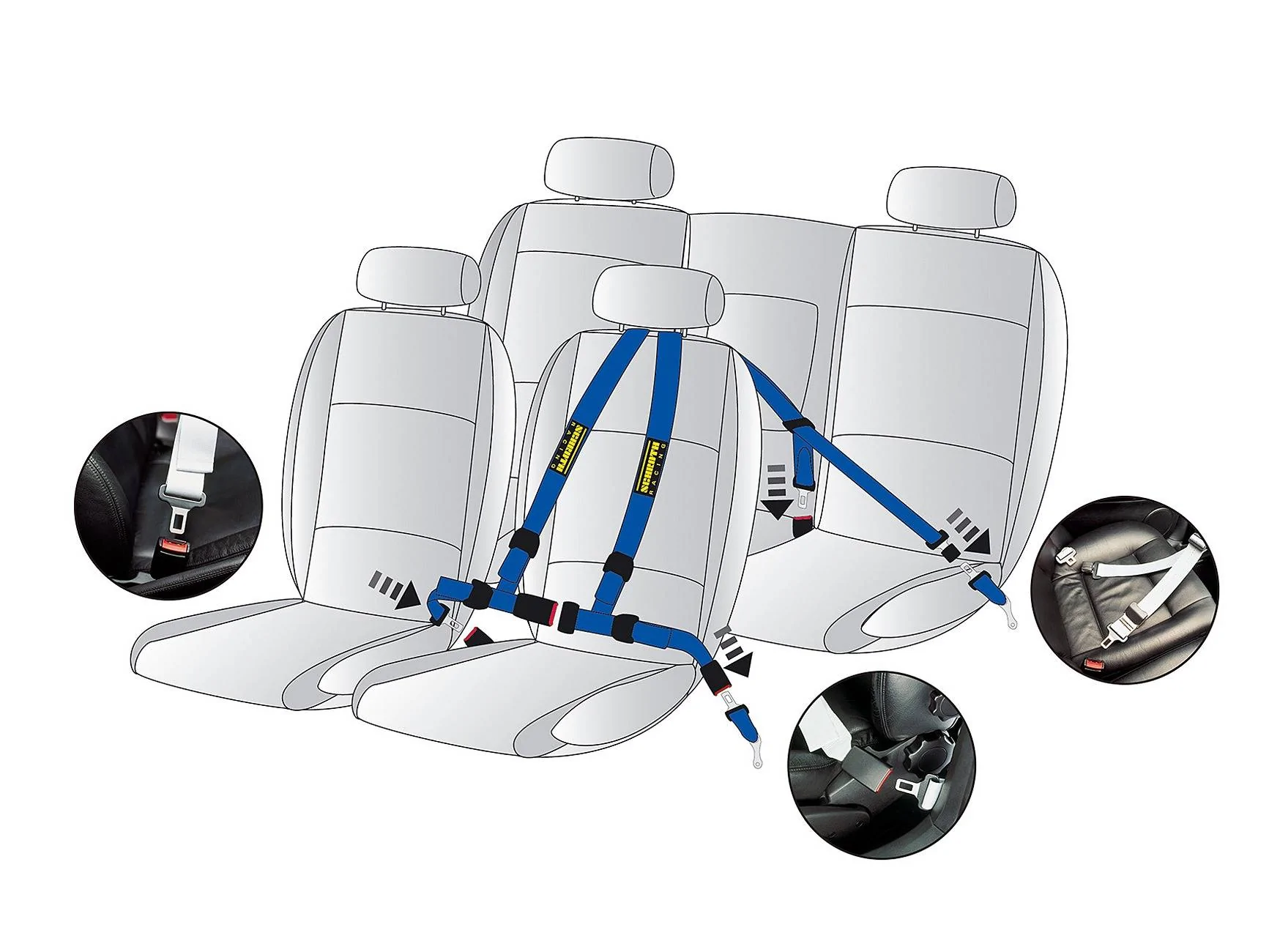

If you use a Schroth Quick Fit you will not need any of this. I ran this belt in my very early days and set it up like like diagram provided by schroth.
