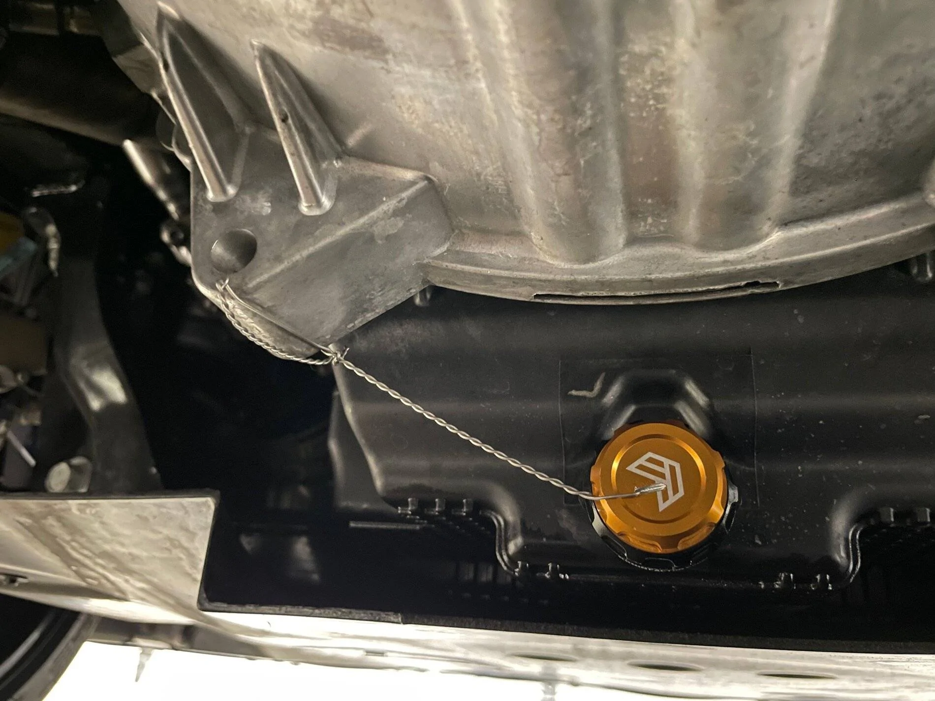

I had one as well. Cap came off on track. Went back OEM because there's no use in constantly replacing something that can't stay on.

It’s funny, just 5 minutes ago I got another response from customer service saying of the thousands they’ve sold, I’m one of only three people they know of who’ve lost a cap. Sounds like there’s at least 4 just on this one thread.
You may consider sending customer service a note. I bet they’ll send you an entirely new unit for free…. Which you could install or sell. Just sayin.
Edit: I wonder if simply wrapping tape around it would keep it from backing out? I plan to safety wire mine, but tape would certainly be faster.

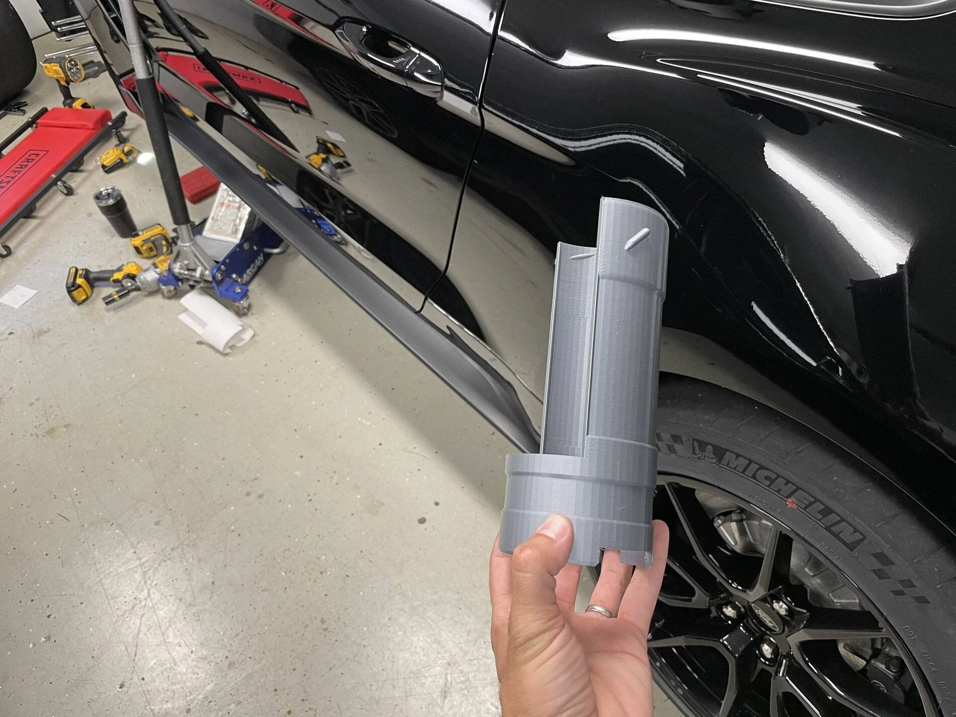

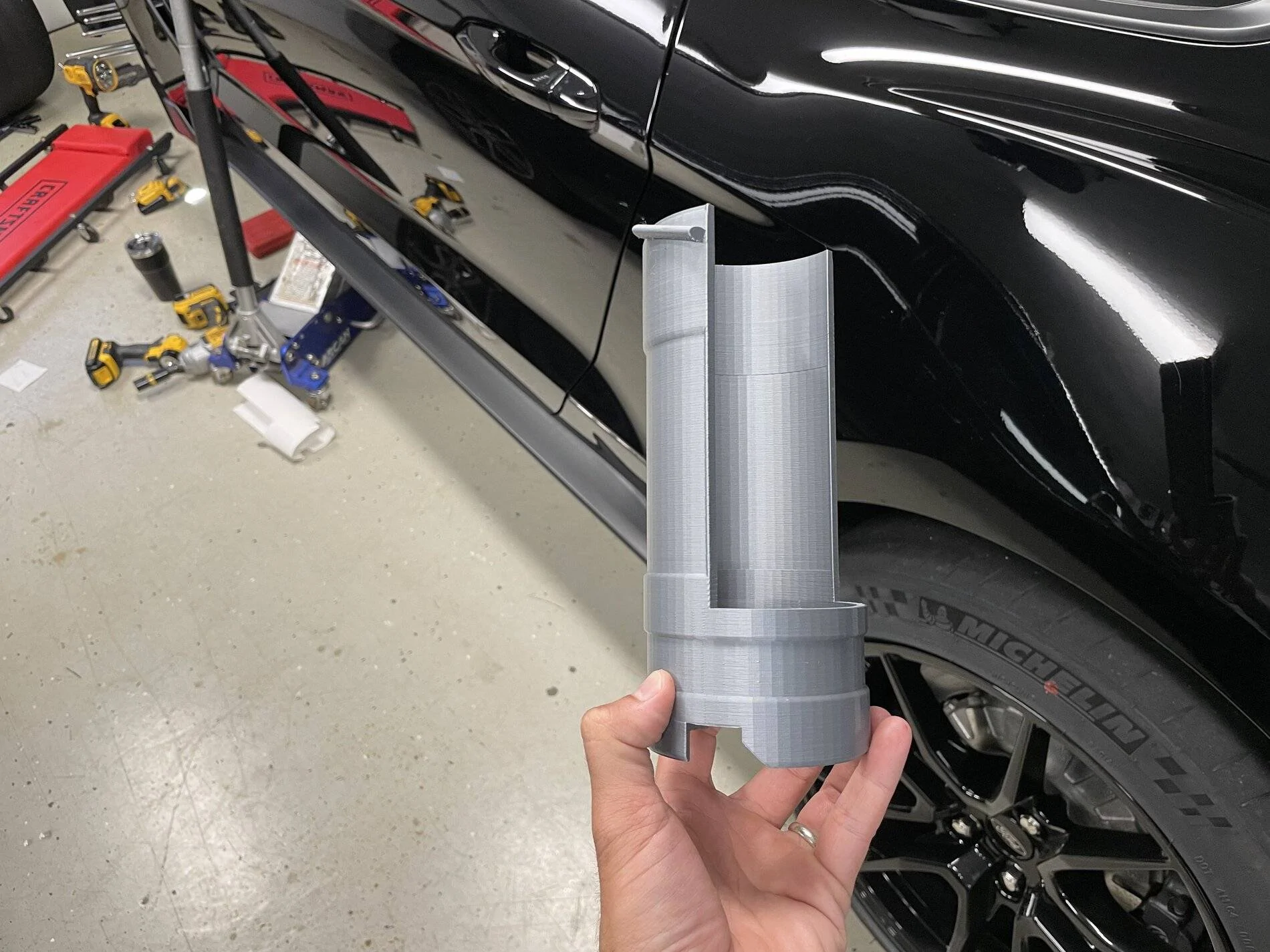

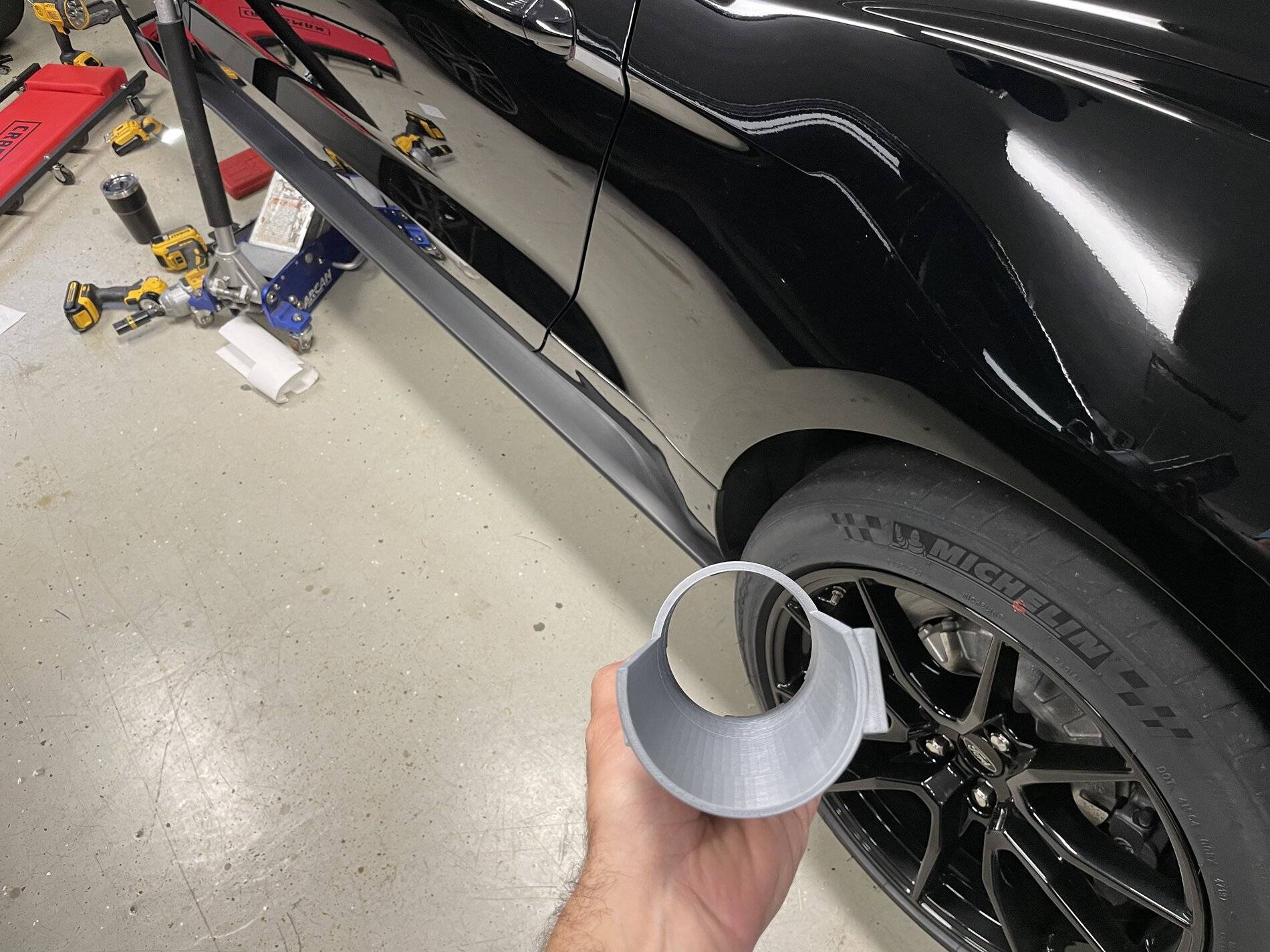

Form-A-Funnels work very well, but if you happen to have a 3D printer and are proficient in 3D CAD, you could whip out something like this:
I got wind of these a while back here on the board, and originally the seller had them listed for the '18-'20 cars. I inquired about it fitting a '15-'17 and he had no idea if it would, but offered to send me one if I would verify fit on my '15 so he could expand his fitment range; he did and it fit like a glove (with the big FP filters also) and works better than any of my Form-A-Funnels since it stays in place while you flounder around with the filter. No mess, and I'm usually a master of fouling my shop floor with oil change dribbles.
I have no idea if the filter to frame relationship is anywhere close to the same on a GT350 but it might be worth a shot to contact him.

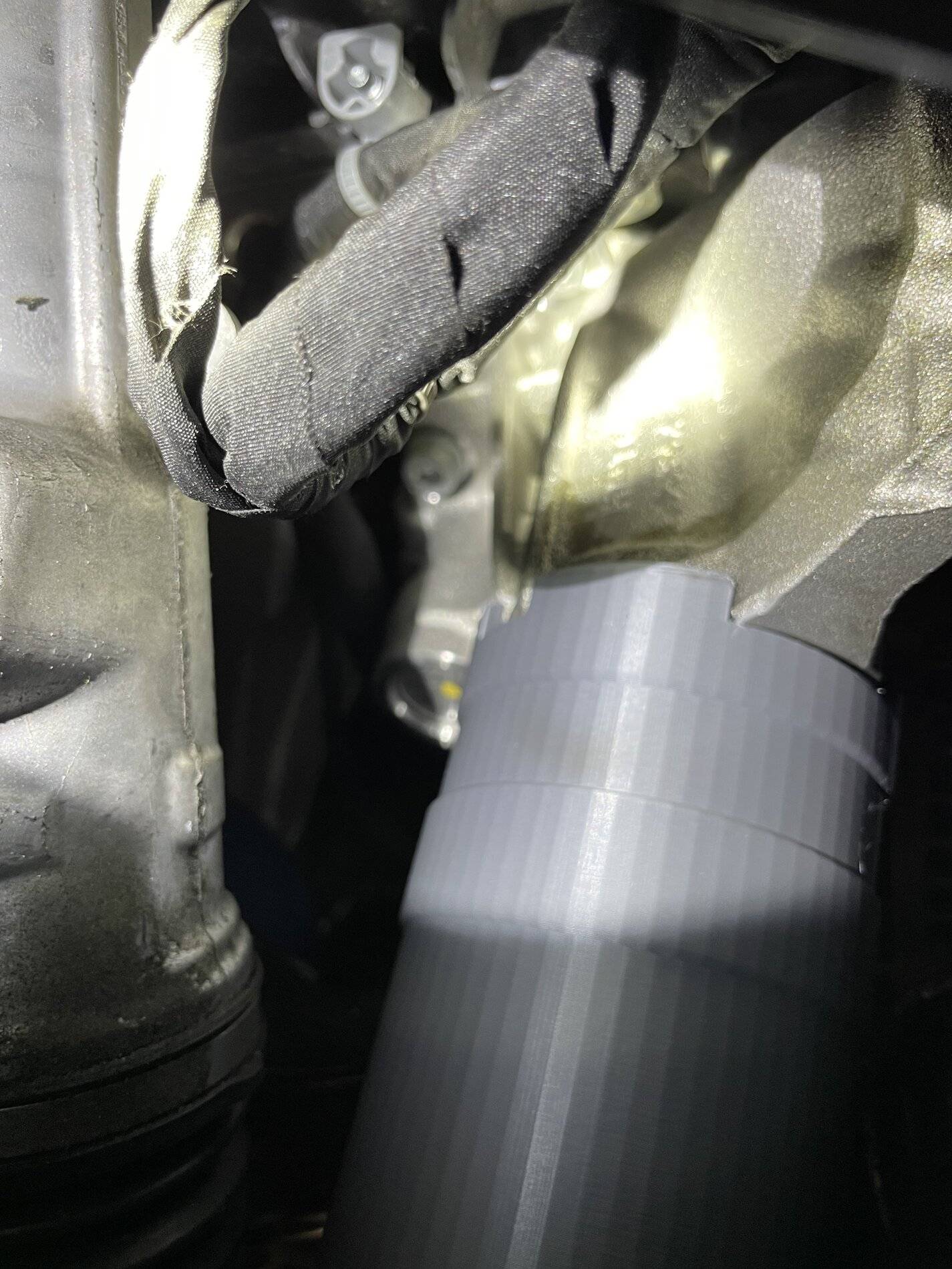

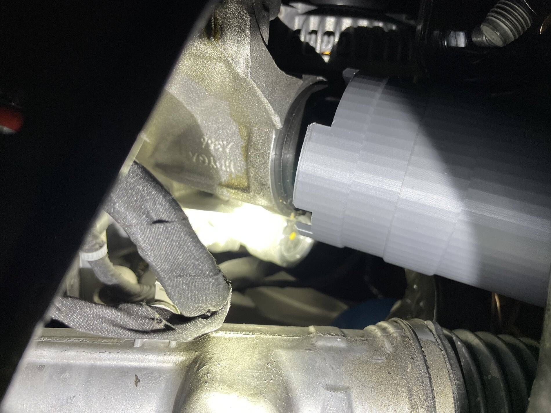

Unfortunately that funnel doesn’t work for the 350 due to orientation of the oil filter housing, and castings in the block… so I made this.
