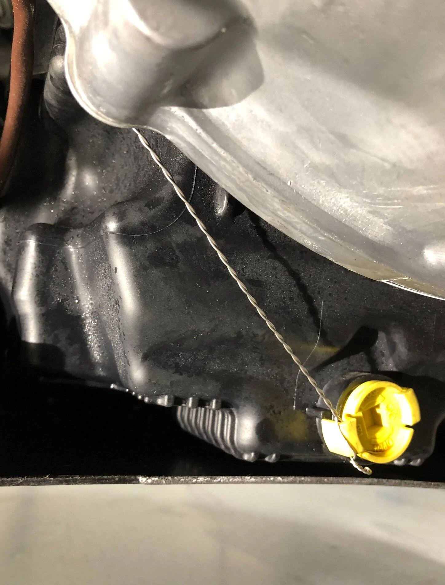

Never came back to this thread, but since it's back up - my safety-wired Ronin plug popped out of the pan on track in September. I've replaced with an OEM style plastic plug, no problems.
That’s now 5 that I’m aware of. Did you inspect the plastic nubs inside the oil pan to make sure they were intact?
After mine shot out on track (also safety wired) I bought a new plastic plug from the auto parts store, refilled with oil, and finished out my track weekend. When I was recounting the story to someone else at the track they asked if the nubs in the oil pan were ok. I told them they must be because the plastic plug was holding just fine.
When I did my post weekend oil change I decided to look inside the pan for sh*ts and giggles. To my horror I discovered that one of the nubs was completely broken off, and the other was damaged. How that plastic plug stayed in there for another 4 hours of track time is a miracle.

I wasn't able to look at them at the time (car was smoking hot), but will at next oil change. That was my concern. Plug seemed to seat and snug up well, so I'll keep my fingers crossed. I assume you had to replace the oil pan.
Understood.
I did indeed.
