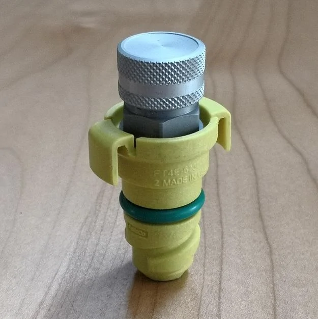

It's a stock plug drilled through and tapped M12x1.75 with one of these:
https://www.stahlbus-us.com/oil-dra...s-oil-drain-valve-m12x175x12mm-steel-set.html
I had the Stahlbus drain fitting on my 2014 GT500 and I got to wondering how it would work if I threaded it into the stock GT350 drain plug. Turns out that Ford's "plastic" drain plug is reinforced nylon and it's really tough and strong. When I researched Nylon PA66 (molded on the side of the piece) it turns out the glass-reinforced version is about two thirds as strong as aluminum 6061. For a dumb little plug, it's a bit over-engineered.
The task is only really half-done, though. The 12mm threads are just a little too small to fill the 3/8 square opening is in the middle of the factory plug, so to avoid the risk of a leak, I'm waiting on a set of Timeserts to take up the extra space and ensure that it seals. If I'd had an M14 threaded valve on hand, it would have been fine without the Timesert.
One of the things I like about this solution (aside from making it easy to attach a hose and avoid the torrent of hot oil) is that if the car needs an oil change and I don't have the Stahlbus hose fitting, I can just remove the whole plug the normal way.
Stahlbus makes some great stuff, by the way. I've used Stahlbus brake bleeder screws on my cars for years, including the GT350. They are the gold standard for one-man bleeders - they have an actual one-way valve in them and they're sealed with O-rings to keep air out. Nothing else comes close.
