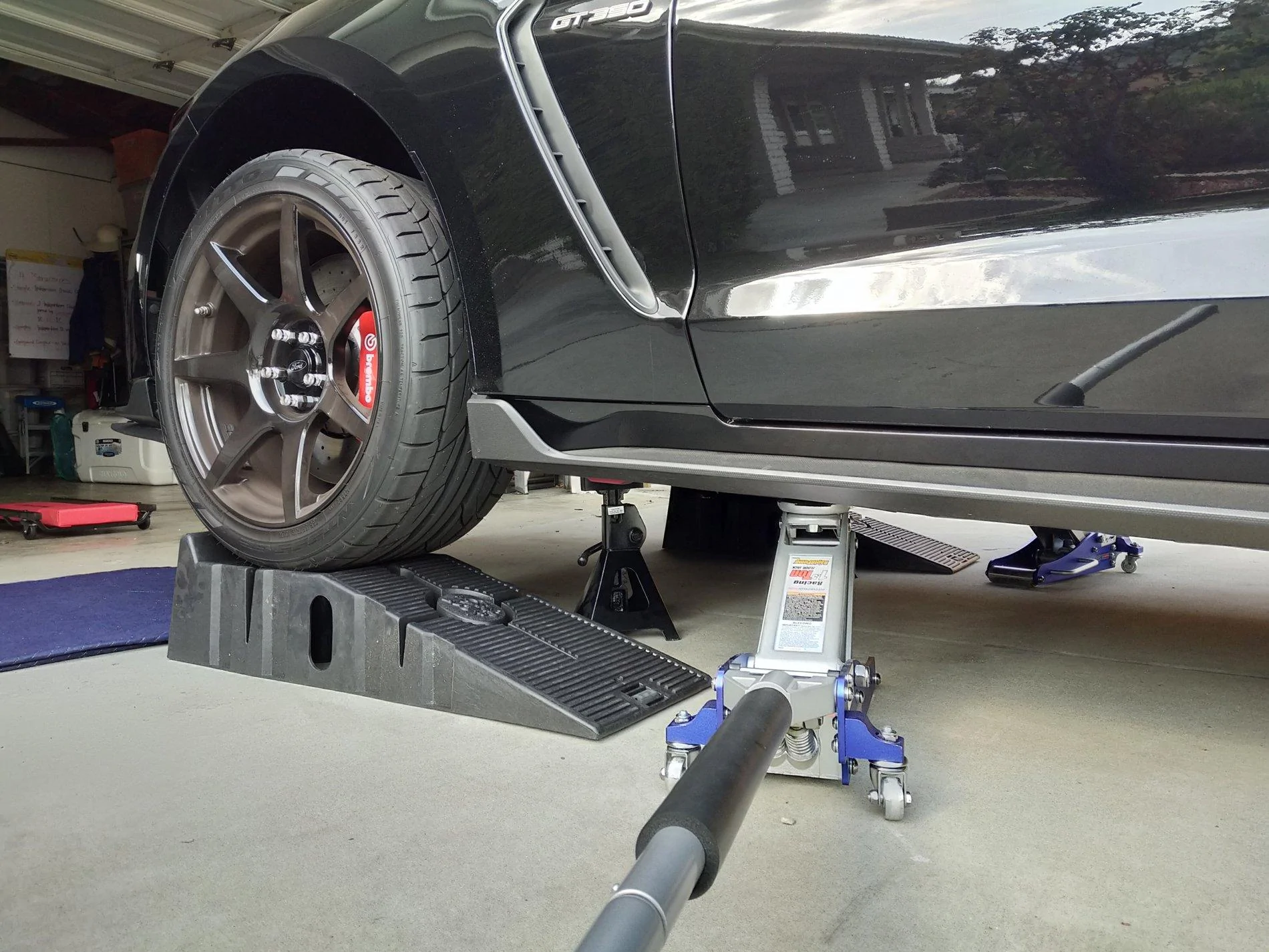

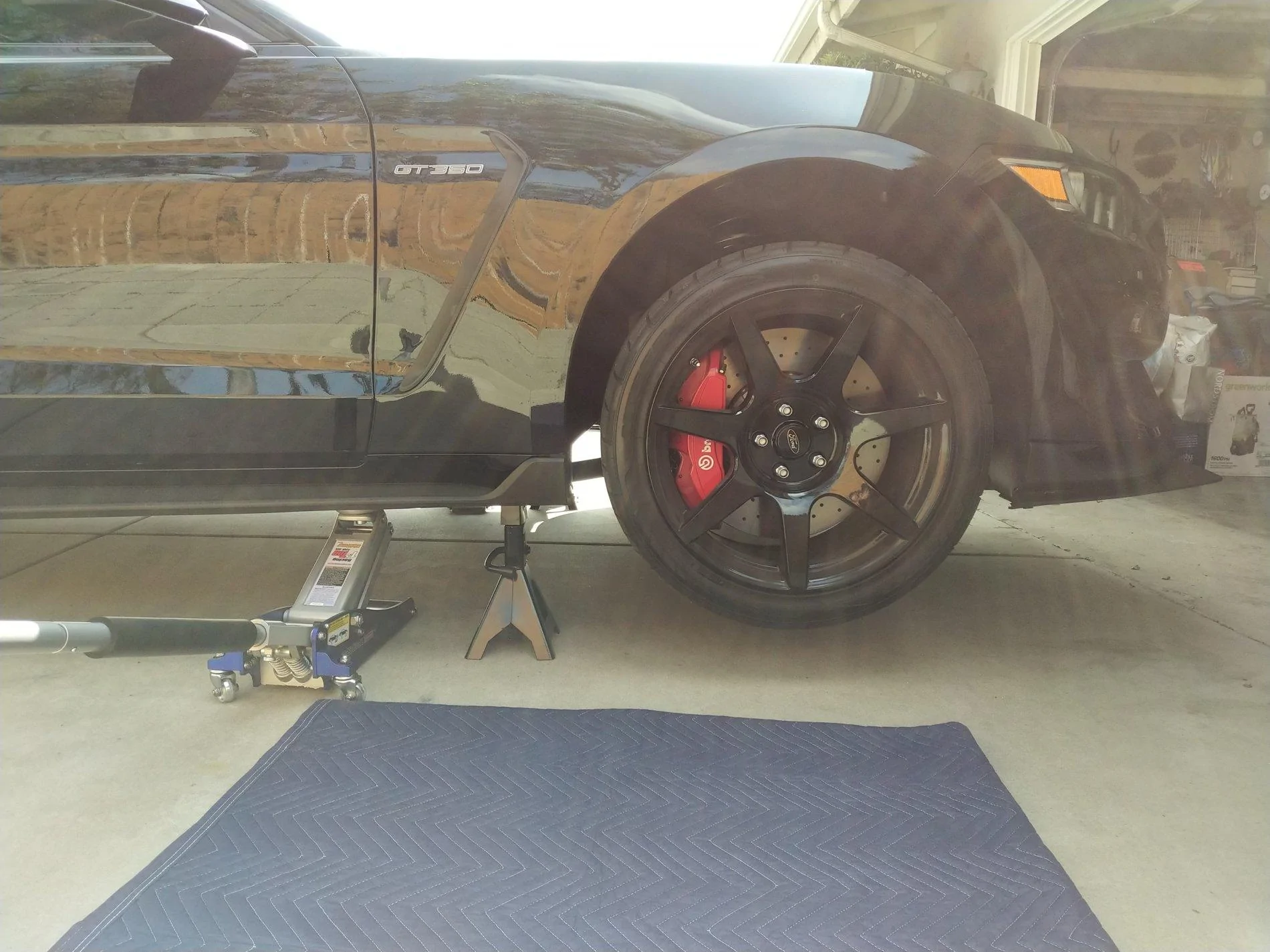

just propped up my Shelby for its first oil change right now, hopefully this is secure enough let me know if it's not. using a hydraulic jack as support but jack stands as primary on each side so there's four total supports on a front end.
by the way the hydraulic jacks are under the steeda jacking rails...

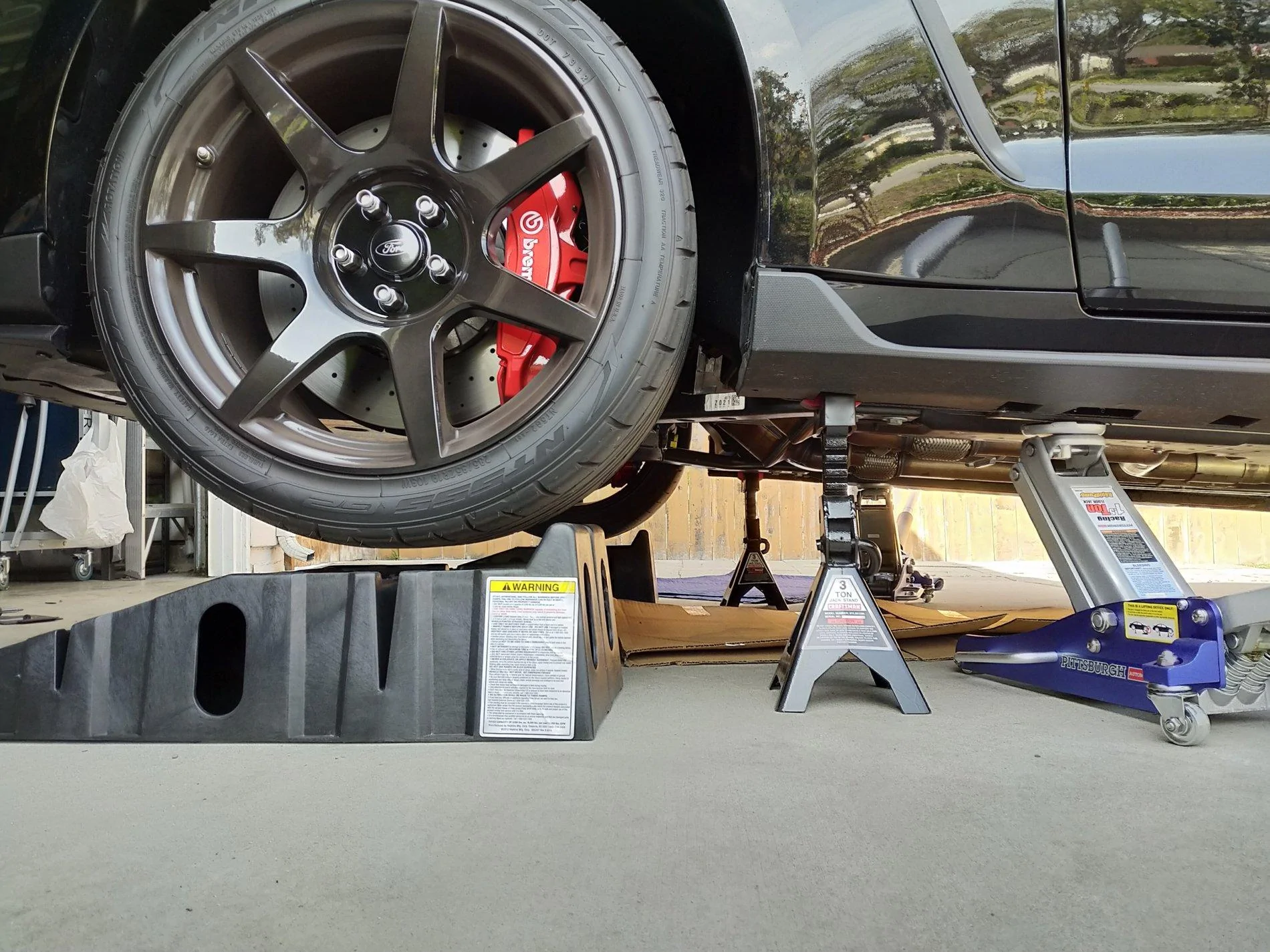

I ended up needing more height, so I went with this set up...
The ramps are only for emergency support, just in case both the jacks and stands fail. I figured I might as well shove them under since they were just sitting there and they could just slide in.
For some reason I still didn't feel safe. Maybe just because it's the first time getting under this car and knowing how low it is on the ground. I'd be interested to know which of you put all 4 wheels in the air using 4 stands. I'd like to see a GT350/R with that set up.
As for the actual oil change, the OEM drain plug came out pretty easy and, yes, the oil just blasts out. I was even worried my oil reservoir wouldn't drain the oil fast enough as it was coming out quickly. The filter was a bit messy, even with the "form a funnel" (Amazon). I'll do better next time.
3 things I'd like to know for you GT350/R owners who do your own oil change...
1) How do you jack your car for changing oil?
2) Do you pour 10 qts, then check your dipstick? Or do you pour 8-9 qts and check?
3) Do you find it hard to "see" the oil level on the stick? With the clean new oil I had a hard time seeing where the oil level was, even after trying 3x.
