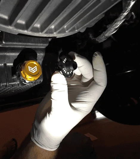

I installed the Ronin on my '20 GT PP1 early last year at the first oil change ~1,000 miles.
I love it. Best $80 I spent. I also don't track my car. In fact, I haven't even washed it yet - lol.
