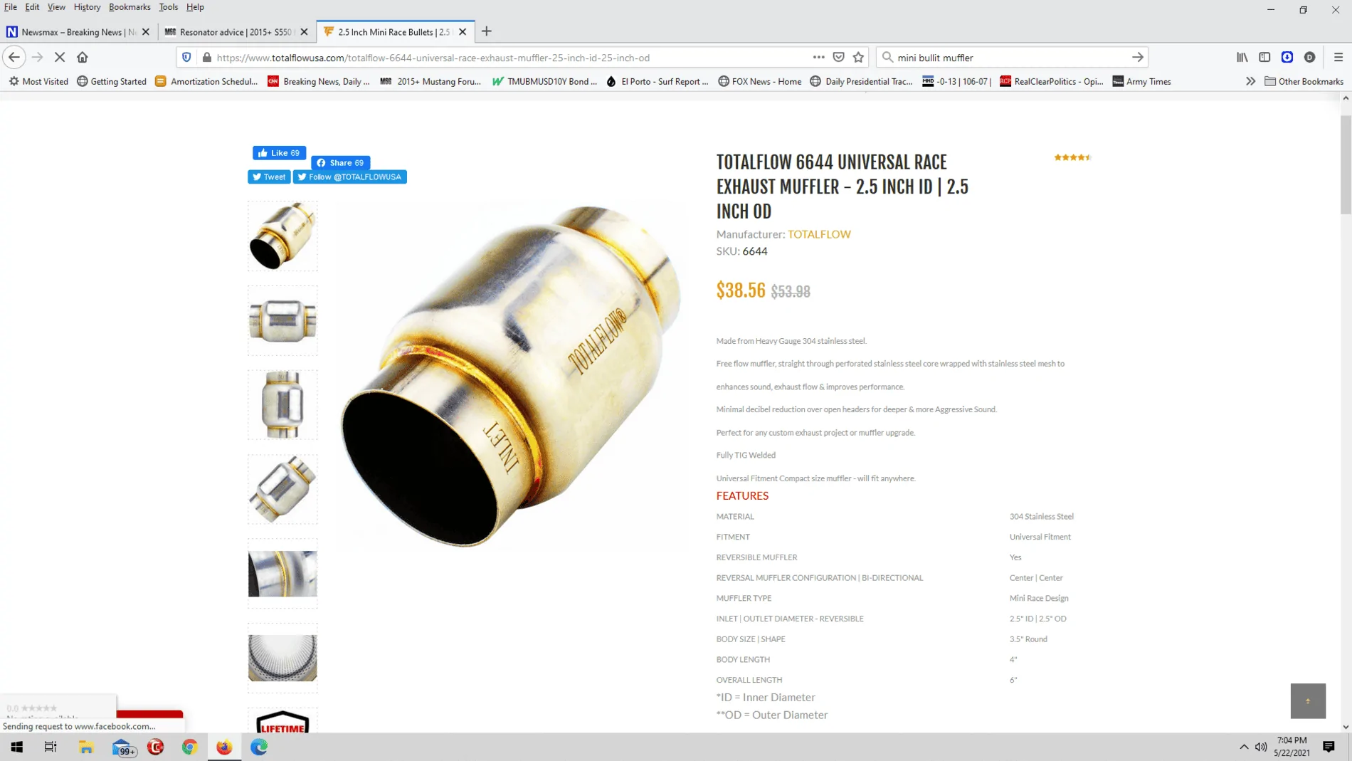

If you want to go with something smaller I went with these...
