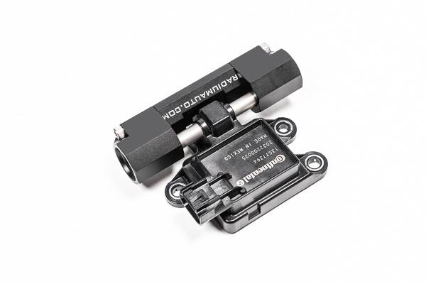

I would recommend getting an ethanol sensor kit/setup (like the fuel it) if nothing more than simply checking the quality of the E85 each time to know whether it's tip top or trash.
It varies from time of year, station to station, at the same station depending on fill up, etc. I've filled up and received 82% one week and then went back to the same station 2 weeks later and have it be high 60's.
I recommend using a tuner that's familiar with PCMtech and going down that path. Then you can integrate your ethanol sensor and you can actually run "user input" flex fueling. You fire up the car, it flashes you a reading of the ethanol content and you instantly switch the tune mapping accordingly.

If you go PCMtech and integrate the ethanol sensor, you don't need to buy the Fuel it module, just the ethanol sensor itself and the sensor housing/fitting.
If you're not going to run a return line as Mike suggested, I'd suggest getting the quality ethanol sensor fitting (like Radium) that doesn't restrict the flow as you're going to have to put it on the feed side.
You can pick up the ethanol sensor (there's a few of them that will work/fit) off amazon for around $60. The Radium fitting and whatever connection fittings aren't that expensive either. If you don't go PCMtech, then you can buy the Fuel-It module and it has a blue tooth connection to an app on your phone so you can check the ethanol content (and fuel temp if that blows your hair back) anytime you want.
No more dealing with test tube interruptions or hassles at the pump or guessing/calculating if you mix fuels. With the sensor, you simply fill up, drive for a bit and let the mixture make it's way forward to the sensor and you'll know exactly what the ethanol content is.

I put in the sensor adapter from Motion Raceworks which is another good option. I just need to get the fuel-it setup.
https://motionraceworks.com/product...-sensor-mount-for-feed-or-return-6an-8an-10an
Just remember the further away from the pumps you place the sensor, the longer you'll have to wait for the new mixture to arrive across the sensor and arrive at steady state. It's not a long time but it's not instantaneous.
I have mine on my return line so it takes a couple minutes of idling or less if just normal driving before I turn on the app and check it. (or I used to, my fuel it module is gone now because the signal is integrated into my ECU now. It flashes me a value on one of my gauges now, which is useless because again, it only does it momentarily just after startup so the reading is not accurate. I don't really care because my PCM is now flex fuel tuned, so whatever it is the tune adjusts).
