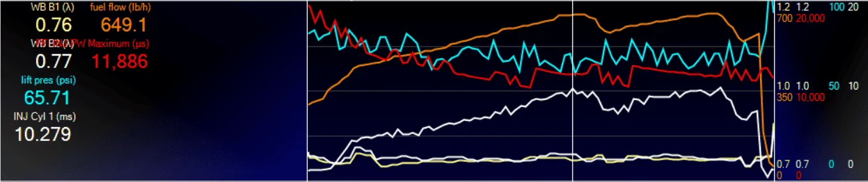

Just a datalog from this morning. This is a Whippled gen3 with the 3.25 pulley. Hasn't been on the dyno but others with this combo make 850 rwhp, sometimes approaching 900.
This is a 4th to 5th gear pull. Fuel lift pressure at the rail is blue and fuel flow is orange. This is a single DW400 running at about 20 volts, and 55# port injectors. The max pulsewidth seen on the port injectors is 10.3 ms, which equates to about 64% duty cycle. The red line is what the logic determines to be the max pulsewidth, and the gen3 will not let you exceed it (~75% duty cycle).
