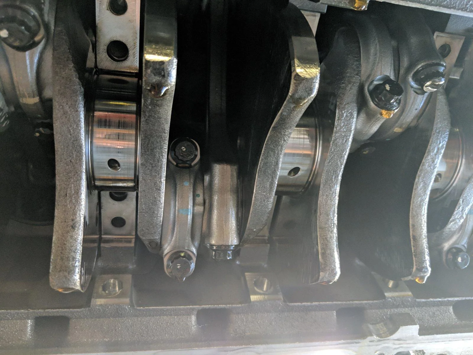

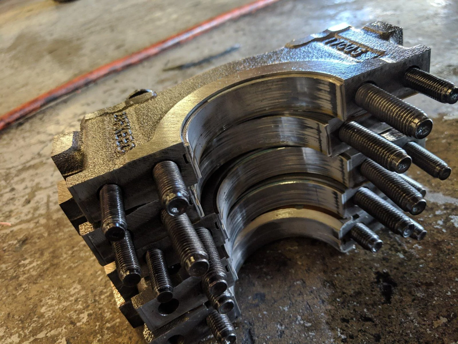

Update on my motor. I stopped by the dealer and discovered that I not only had the intake valve issue, but also the main bearings are showing significant wear. They are not allowed to take the heads off, so speculation is perhaps a deformed or dislodged valve seat. Again, this is conjecture.
The main bearings however, was a huge surprise to me. I'm religious about adding oil even though the oil consumption is imo abnormal. I never let it get to the lower mark. I would speculate again that this is an oil starvation issue since it shows wear across all of them. It could potentially be bad tolerances as well. This is pretty sad.
I read the engineering response from Ford and it stated that no engineering changes have been made to the motor and that it likely was a careless customer not checking oil. It really put me back when I read that. They don't seem to be owning up to it or its all in secrecy as some of you guys have stated that the oil pan has been revised twice.
I will see what I can observe in terms of part numbers when the new motor arrives.
I'd be so pissed if I were you.
So your dealer is tearing down the motor a little? They took the pan off and rod caps off? I thought they're not allowed in at all.
Holy crap! How did you get the photos of the bearing and crank? Ford does not allow to crack open the motor if you want a warranty replacement. Damn!
