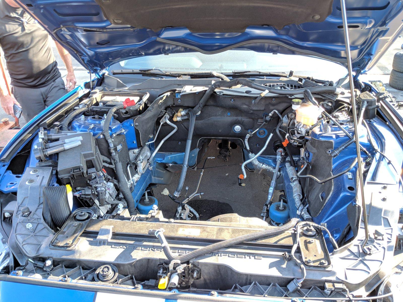

Looks like they already tore up some of the insulation by the battery. You should have that ordered before they replace the engine. You should also look for any other damage.
