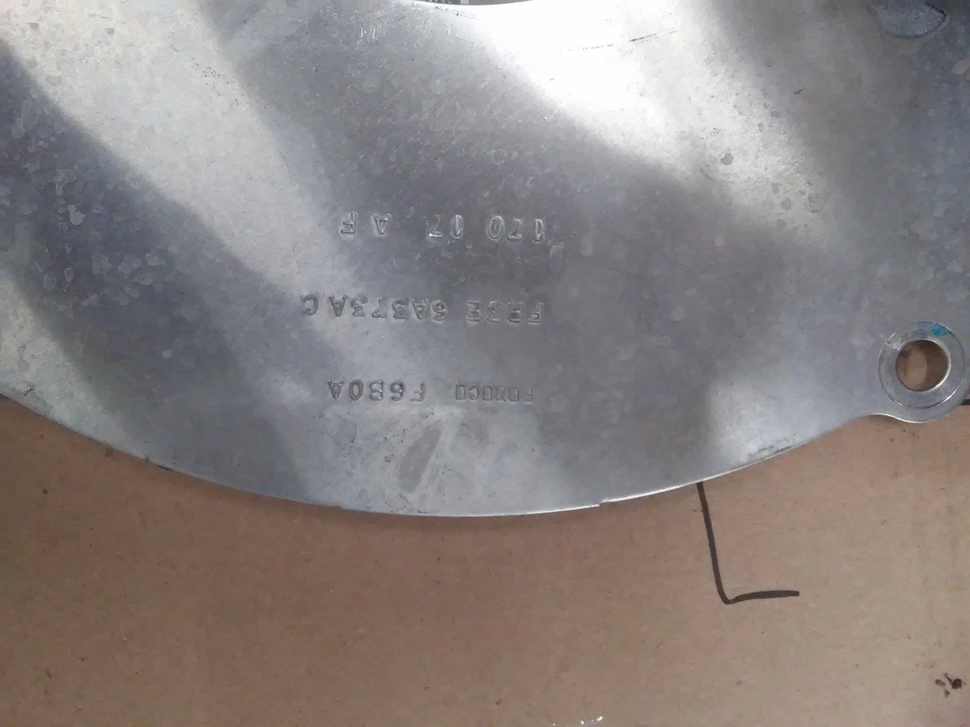

Got it. I am happy to pay for the part at that price if it makes a difference. Can you post a link to the thread that discusses this. I’d just like to be informed when I talk to the dealer.
I posted pictures that I still have copies of. I had Ford change the plate in my 17 GT350.

Does anyone have the updated part number for the new cylinder block plate?
This was the newest part when the replaced mine. I would check with a Ford parts person to make sure they have not updated this one. This part solved the rattle noise I had at certain RPMs.
