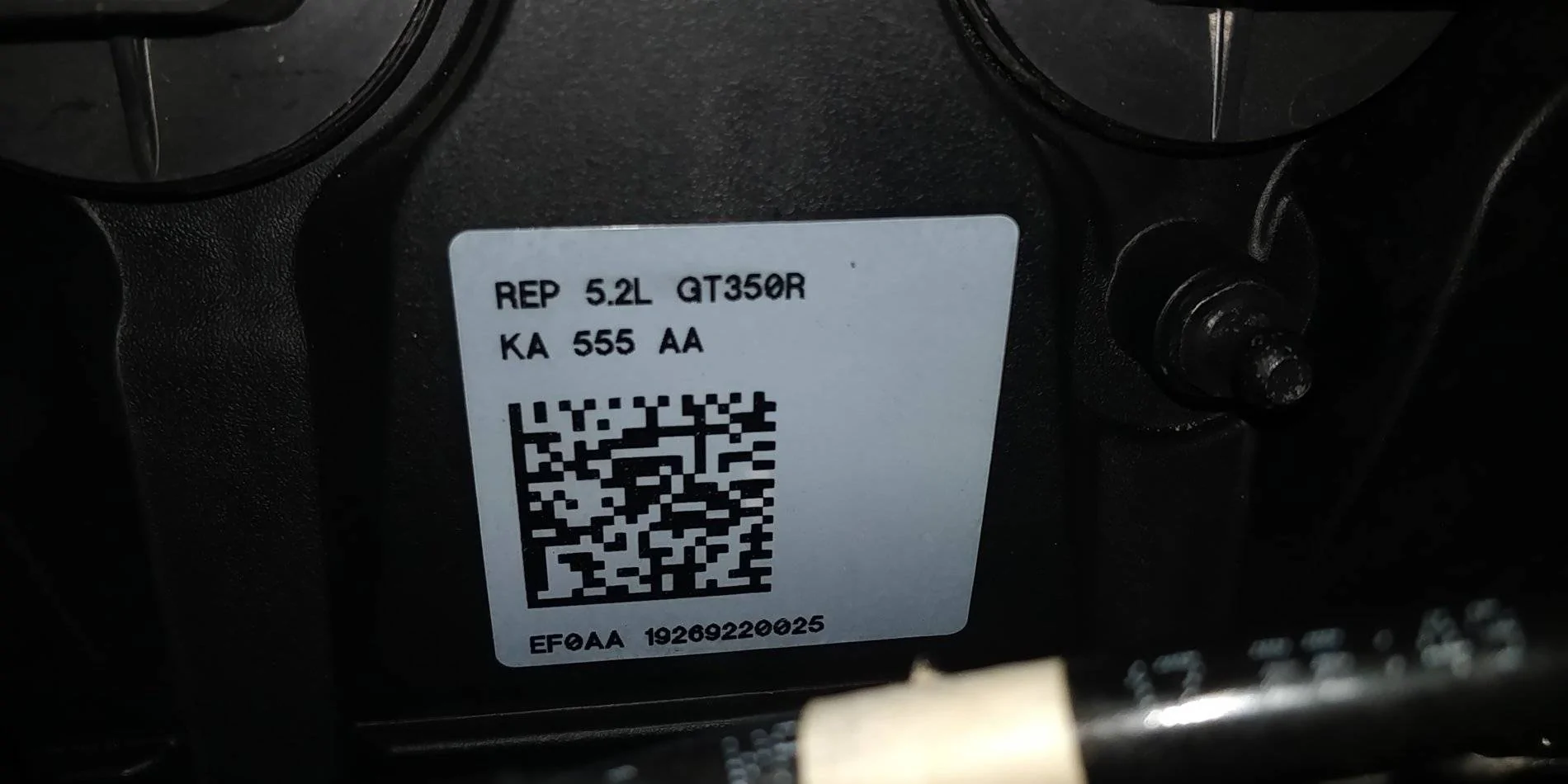

Which dealer are you dealing with? I just checked the ID tag on the motor and they put a 19R motor in built 9/23/19. Long block should be a whole new motor while maybe using some of the accessory parts from the older motor. You scared me so I had to go check my ID tag half naked in the dark.

Did you check your engine tag?
Just checked and it shows 19 year REP GT350R.

the motor build date is 3 days after mine. Looks new to me.
