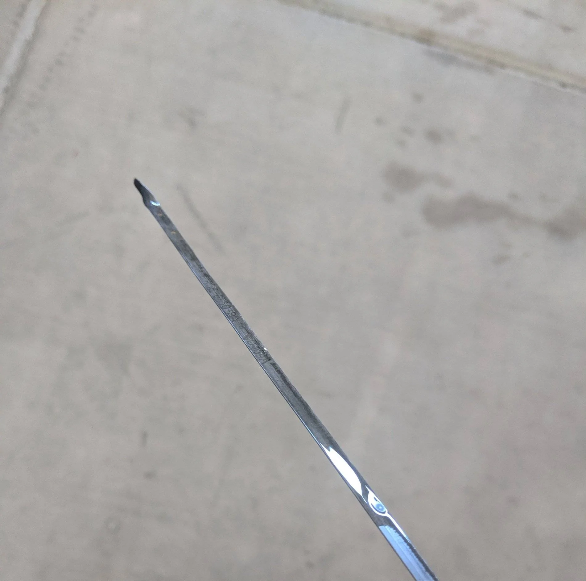

If anyone needs proof why they can't even trust a dealer to do an oil change.
This was my oil level on my first replacement engine, 20 quarts...

Holy fucking shit? How did you first figure it out? Jesus! Look back a few pages on my story. Not this bad but the told me I was only 0.5 quarts low after 325 miles when I was really 2-3. Insane! You would think the people who get paid to do this stuff would know better.
