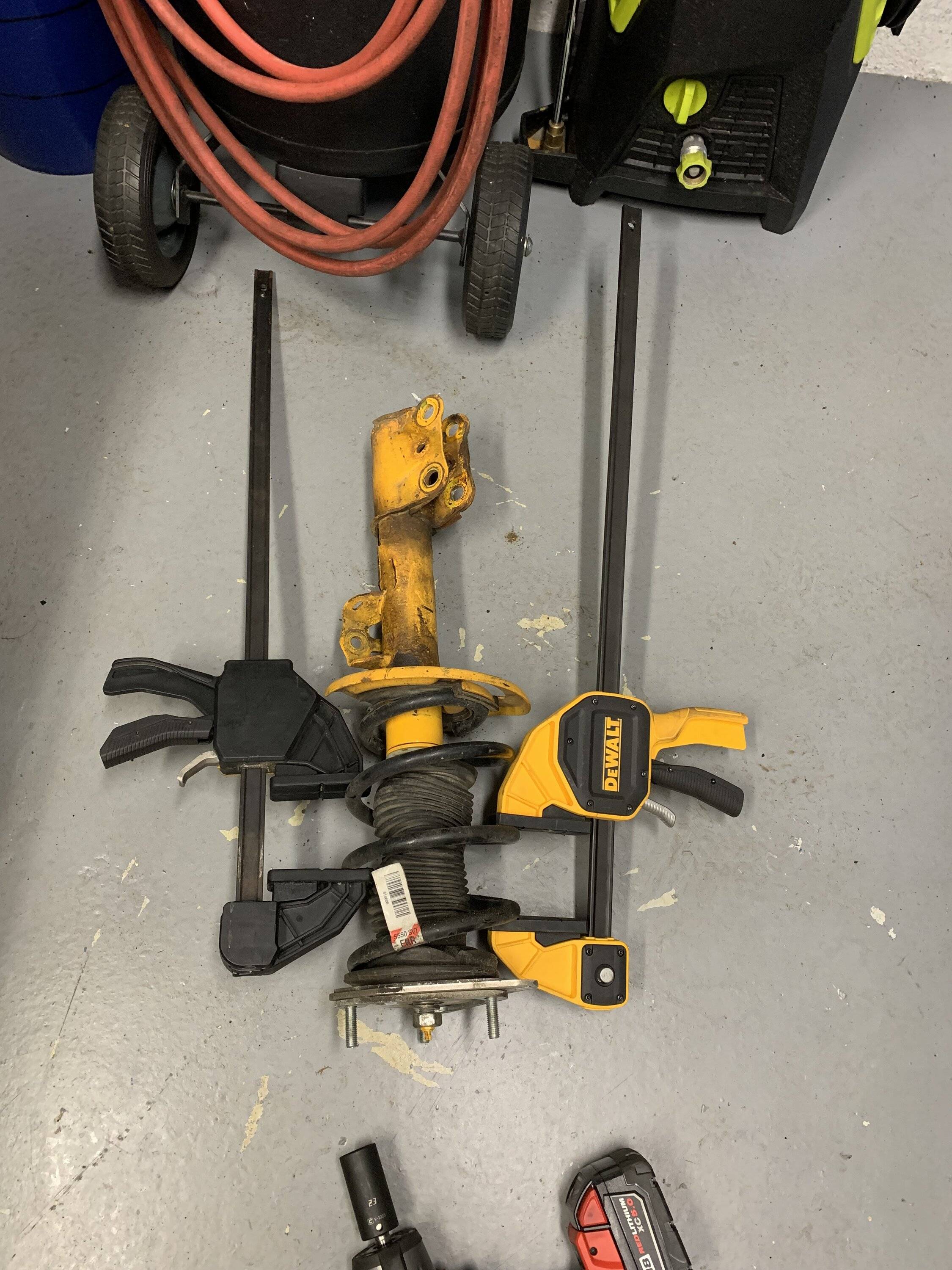

With lowering springs or gt350r springs this is sufficient.
OSHA hates this one trick.
