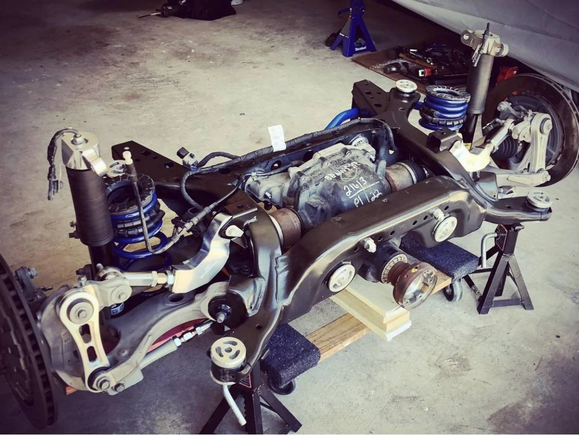

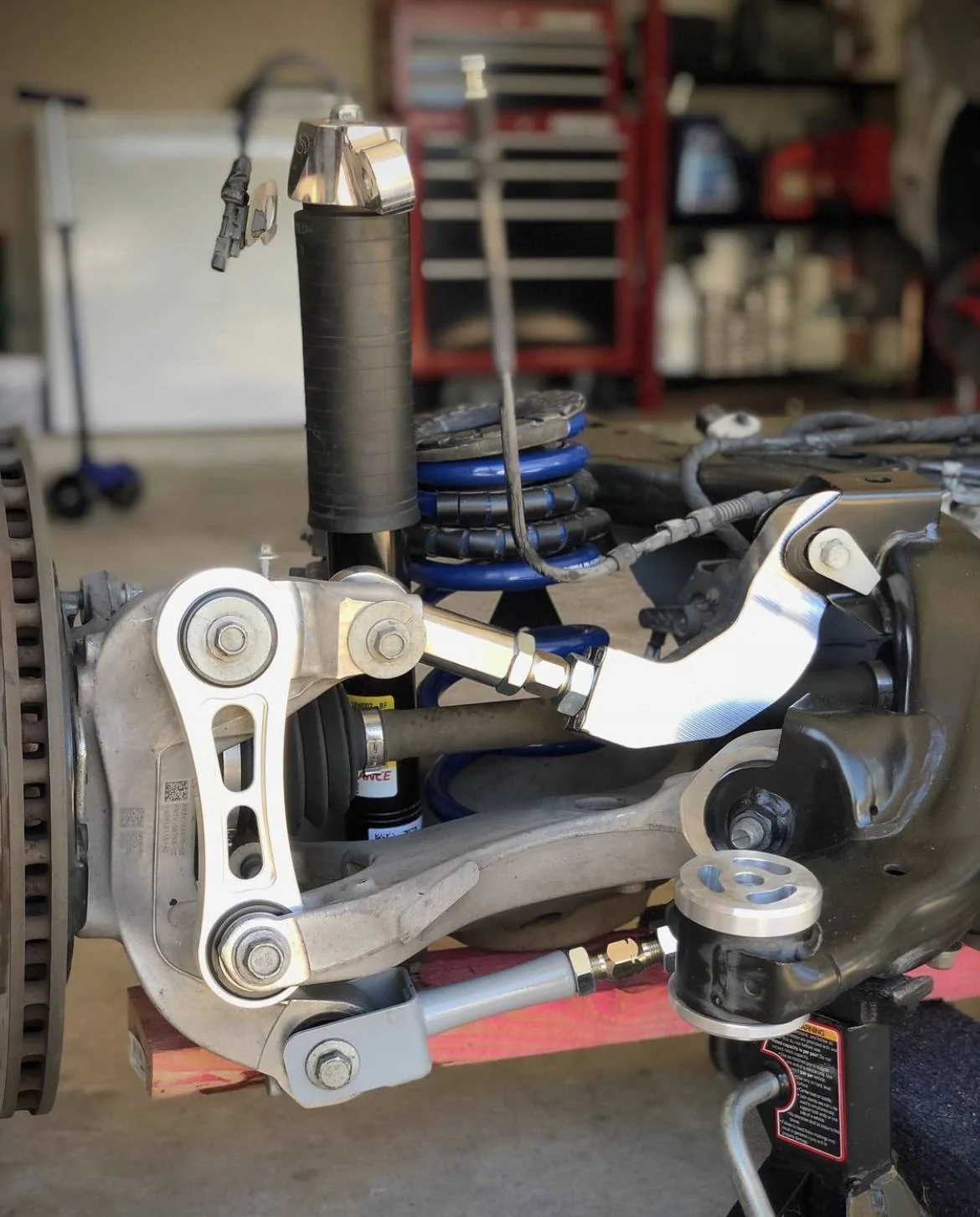

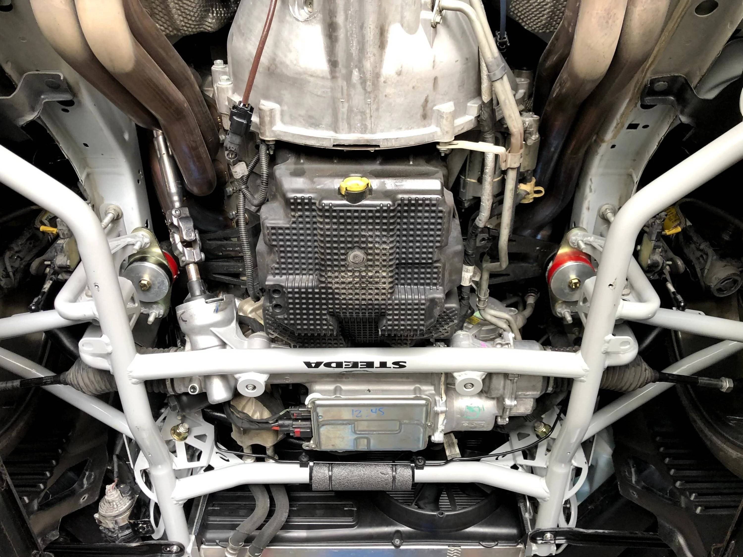

If you need more, I went Steeda tubular front K-member and Mike Maier lightweight tubular front control arms. I have to look for my book of weight savings but I believe it was approx 30 - 35 lbs removed for the k-member and another 10 lbs shaved from the control arms alone.
I installed Steeda’s billet suspension pieces at the back and shaved more weight with every piece over the factory parts. The Stainless Works LTH’s shaved quite a bit as well.

Steeda road race tubular k-member

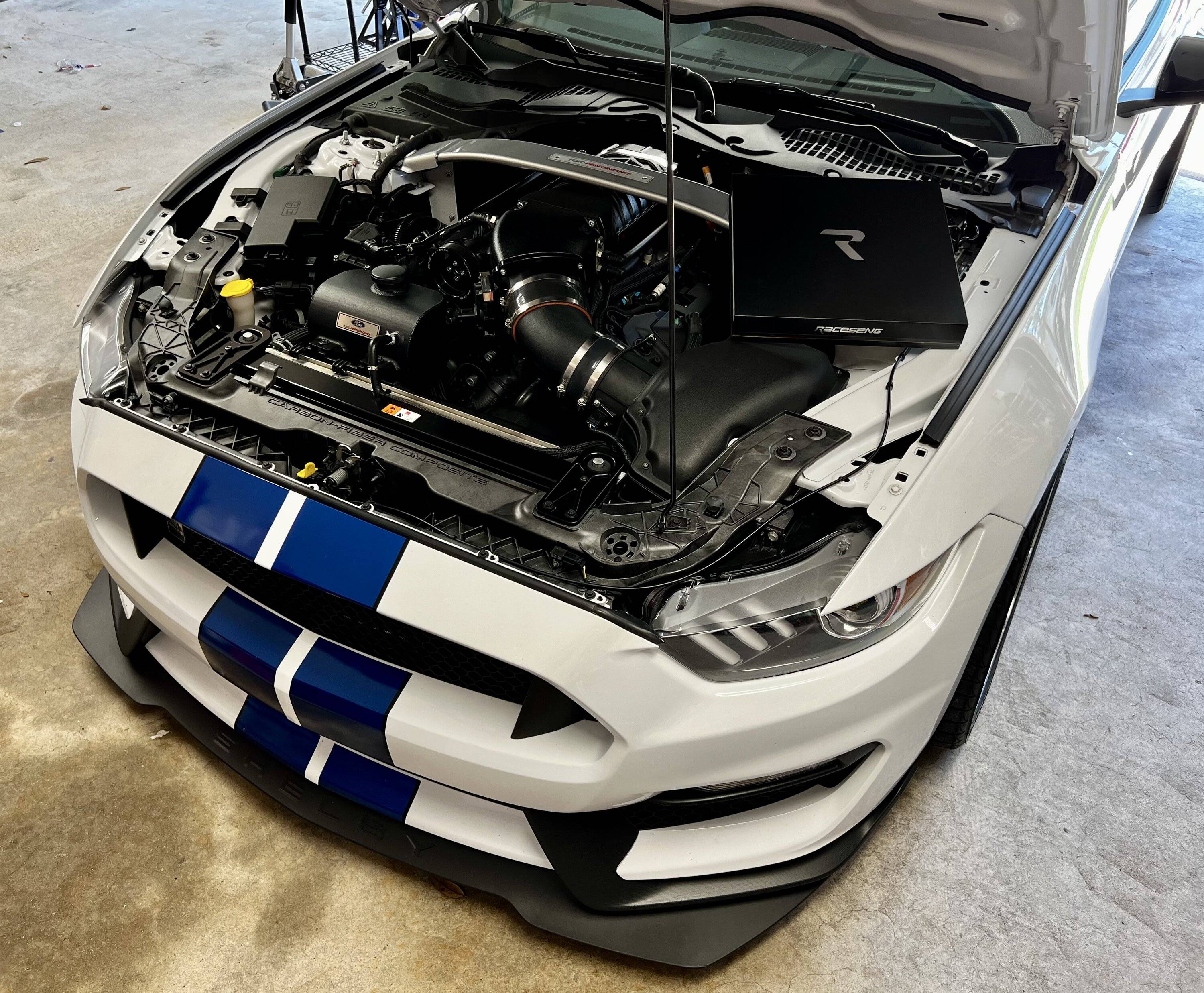

Livernois billet radiator brackets
Hi,
I think the above is what I had seen on some cars at Daytona, but not been able to source in the U.K.
Is this the type you got :
https://www.livernoismotorsports.co...by-gt500-heat-exchanger-brackets-black-finish
And do they fit a non 500 OK ? With the rad cover fitted ? (Any pictures ? :like:)
I had only found the UPR type - but they either weren’t in stock, or from sellers that wouldn’t ship to the U.K. :frown:
Cheers,
WD :like:

Correct, that’s what I have. Everything fit perfect on the GT350. Closest shot I had on my phone is below.
A Shelby buddy of mine added the SPE brackets and the quality was very nice as well.
