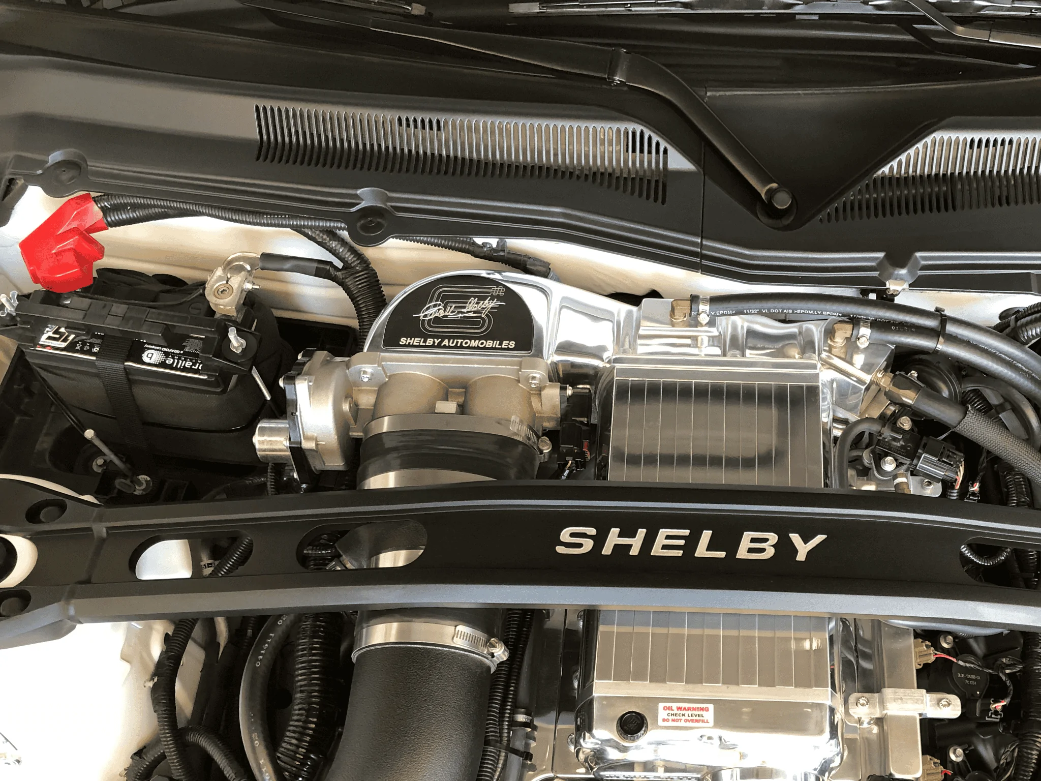

All of this is a exactly right. Only thing to add. OP, you have mag ride. DO NOT go LiPo. 9 time out of 10, our cars reject those batteries. It's something to do with the BMS in the car vs the BMS in the battery.
I went through it, as have tons of other folks with mag ride cars. It's an easy expensive mistake.

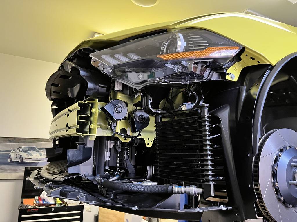

An Antigravity battery saves lots of weight up front for not too much money.
Grab titanium lug nuts with the light wheels to remove more rotating mass.
Lighter front and rear crash bar, I went BMR on this.

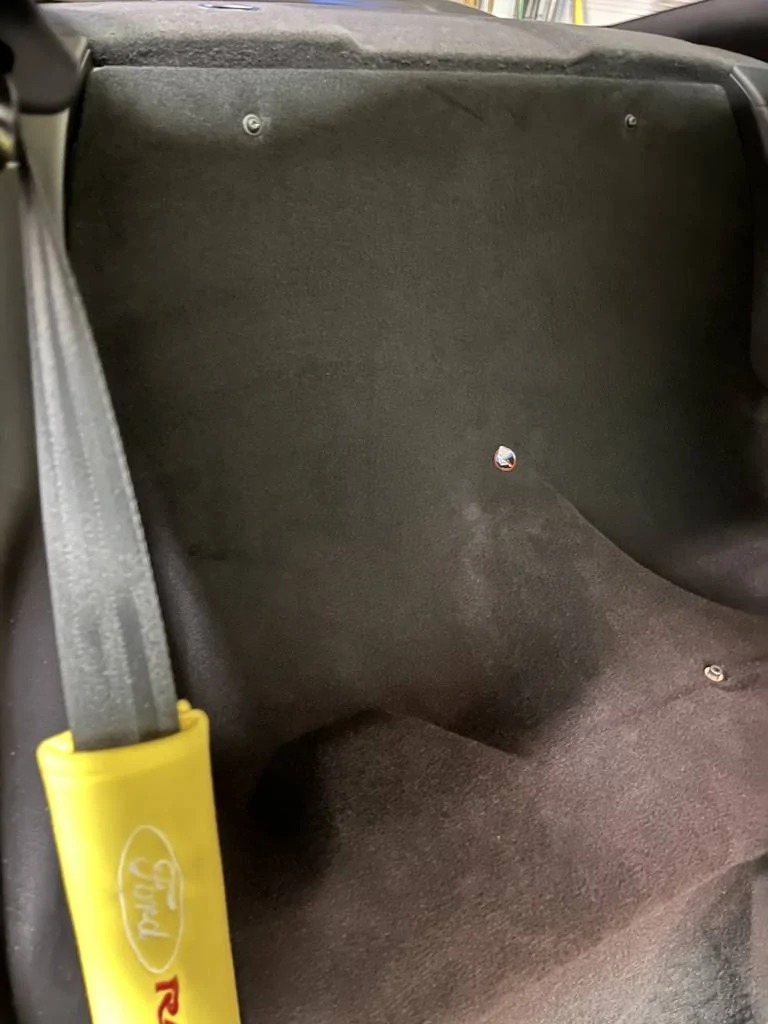

Rear seat delete, remove seat belts too.

Losing weight without removing interior is tough. You can reduce ~70-ish lbs by removing rear seats. I was down to 3636 before I started adding aero.

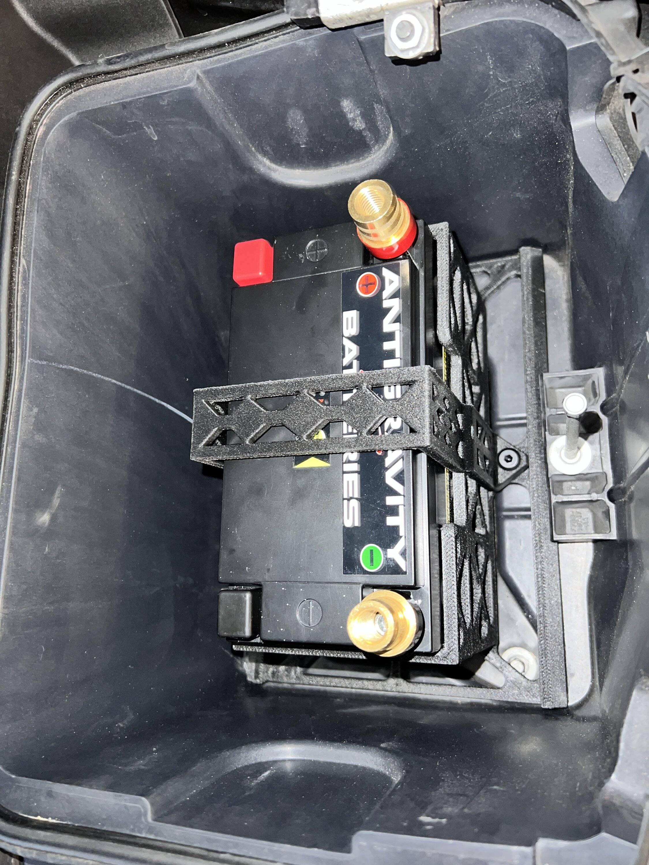

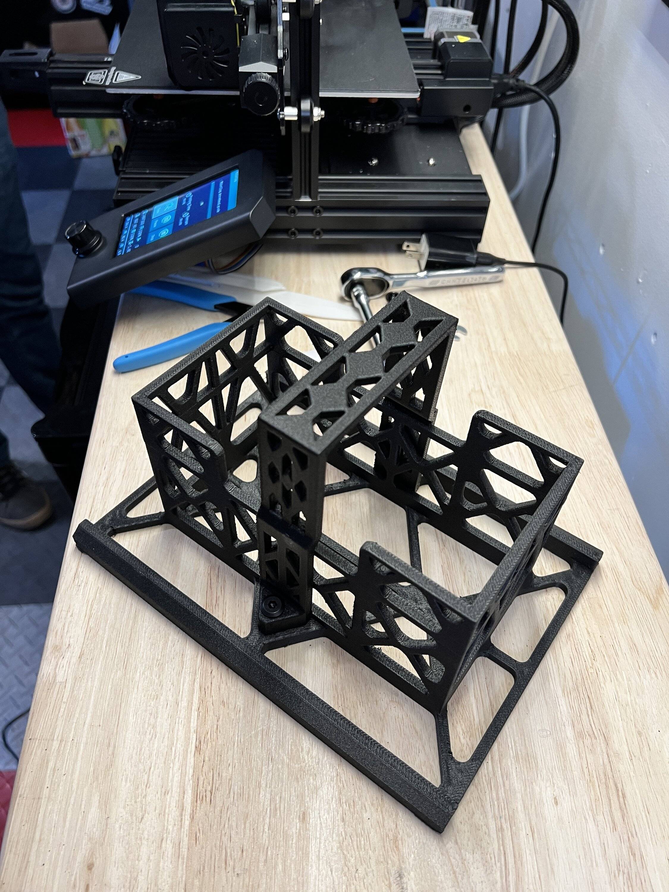

I installed a Li battery and saved ~20 lbs there. I 3D printed a CF battery holder that weighs 170 grams.

Cut out all that spare plastic in the original battery box, you lose a shade over a pound. If you are going for grams and whatnot...

True but the tech nazi’s will all come out from under their holes
For? Knock on wood, mine has never been questioned. My battery is in the trunk though for other reasons. But even when I had my LiPo in front, never had an issue.

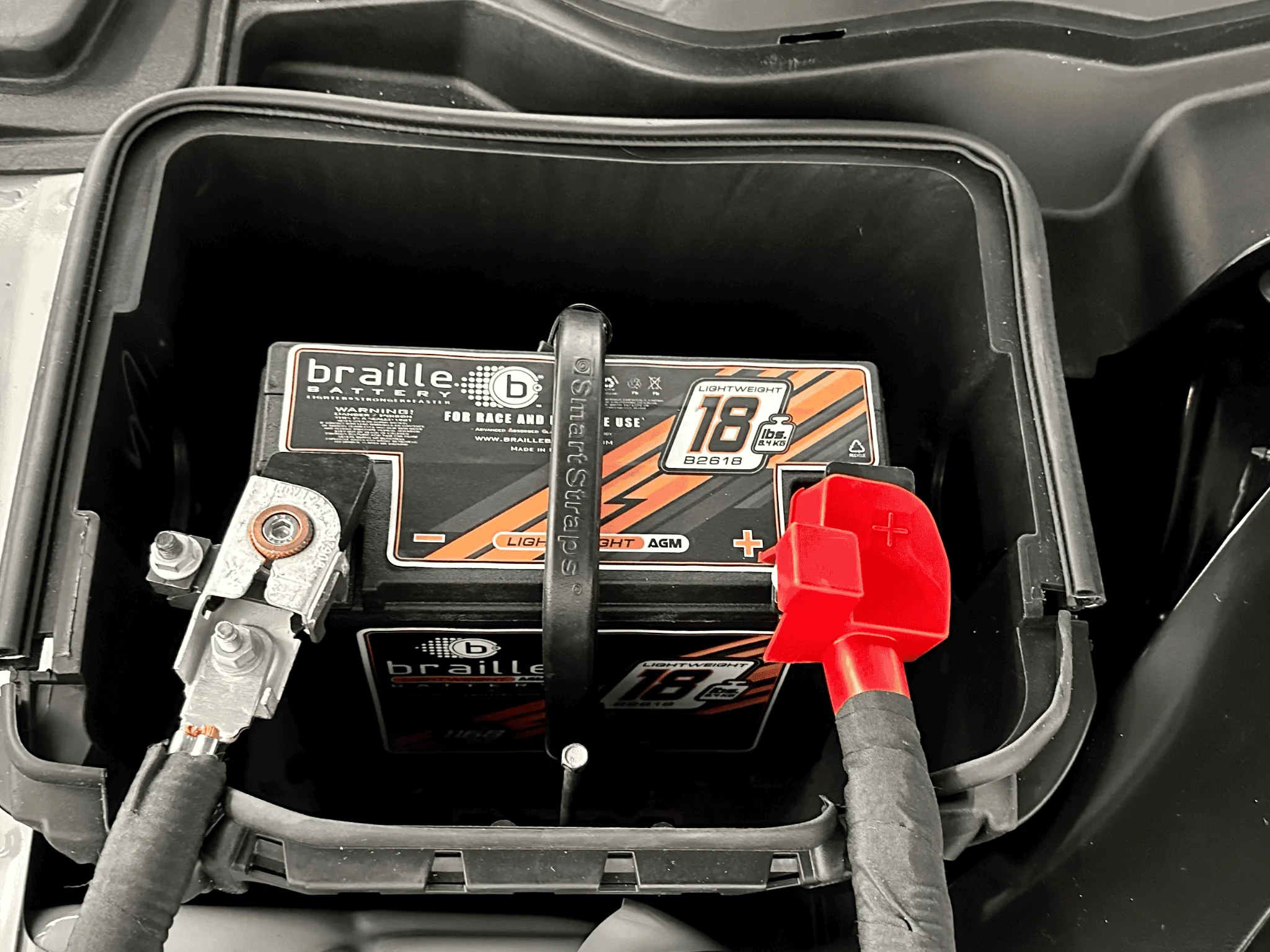

These cars definitely need to go on a diet. Little things I did to lose some weight for the track was everything comes out of the trunk including the speaker, rear seats are gone, around 32 pounds, I don’t drive it in the rain so windshield wiper fluid is gone and also the windshield wipers, a braille battery lost about 14 pounds, project six GR wheels lost about 38 pounds. I would say close to 100 pounds!
which braille model did you get and how has it been holding up?

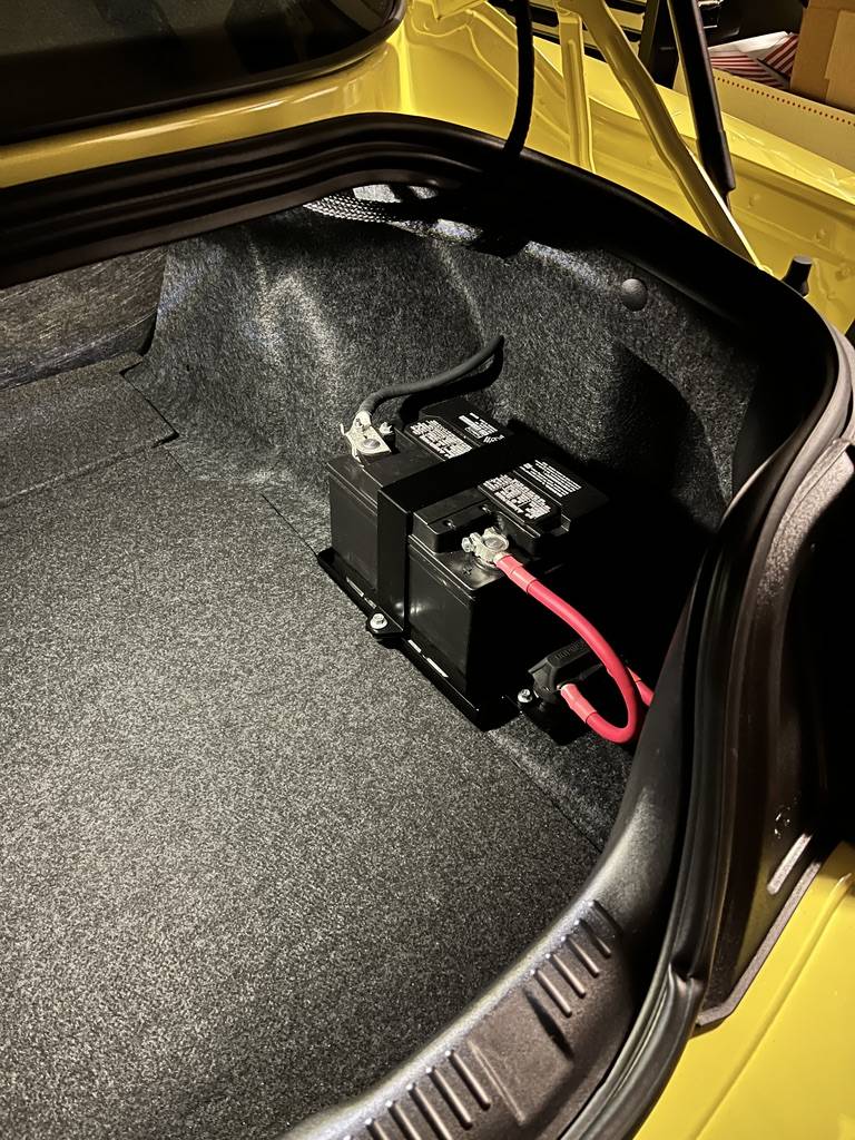

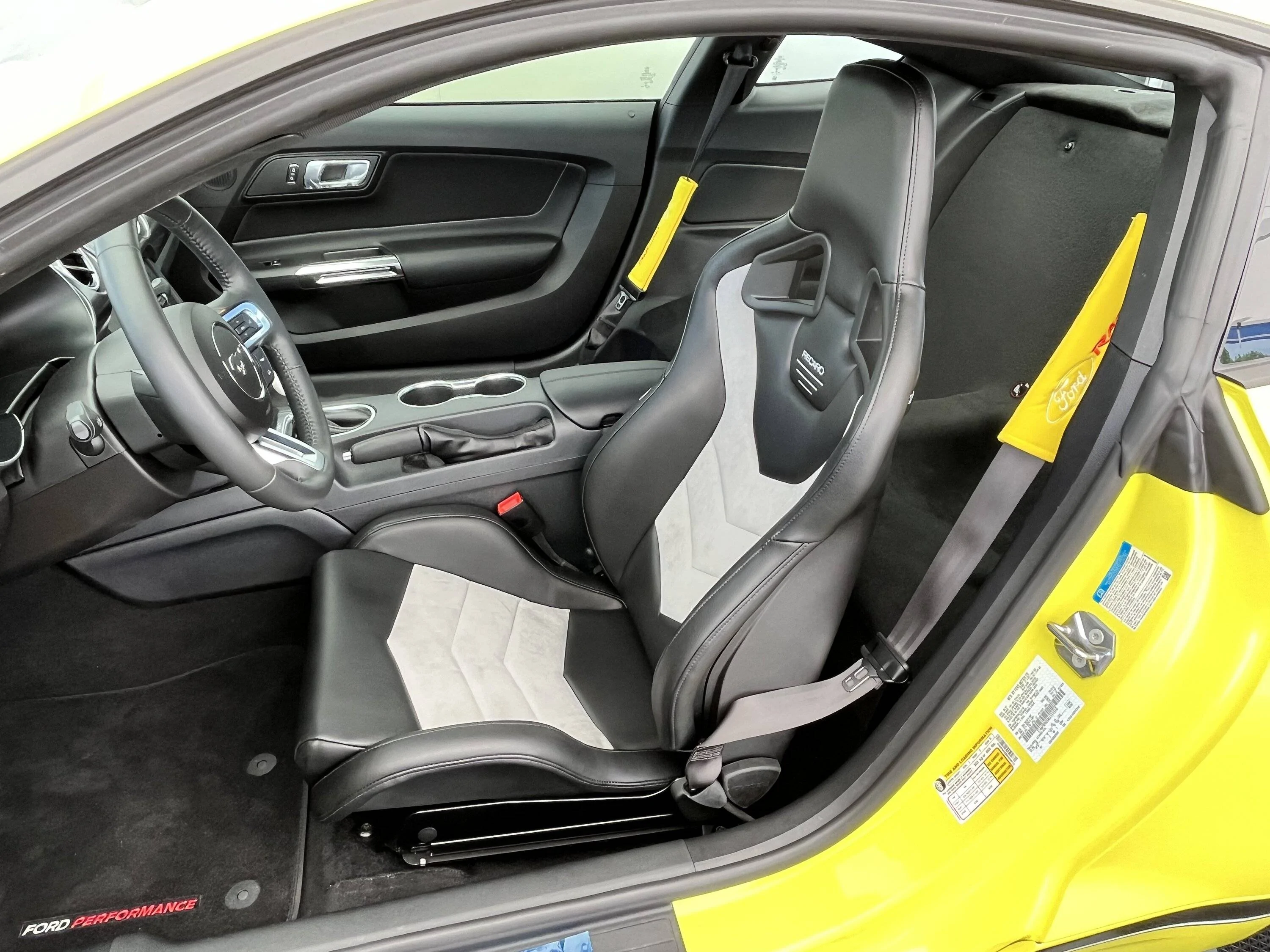

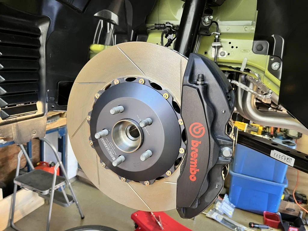

I gotta slim down my Mach 1. I already swapped out the factory hood for a carbon fiber replacement. But now I need to go to the next level. I'm thinking Lightweight Series Velgen wheels, DBA two-piece brake rotors and QA1 carbon fiber driveshaft. I cannot delete the rear seats and my standard front seats are too comfy to change as well.
Absolutely need to lose weight:
-22lbs Giro 2-piece Front Rotors
-8.4lbs Giro 2-piece Rear Rotors
-12lbs Kooks Headers
-9lbs Kooks x-pipe
-18lbs Kooks 3” ss exhaust
-32lbs Apex 11 x 19 wheels
-8lbs Front Bumper bar
+3lbs Ford Motorsport tow hooks
+2lbs Gorilla wheel lug nuts
-40lbs Rear Seat Delete
-34lbs Front Seats Recaro (non-OEM)
-7lbs Trunk spare components
-10lbs Misc plastic panels
-195.4lbs = 35hp gain approx
Watson Trunk Battery mount kit, shifts 35lbs to right rear.

They are very good batteries and hold up well. I had 15 on a Shelby GT/SC and on my 350R and Mach1 I use an18. I do keep it on a battery tender though.
