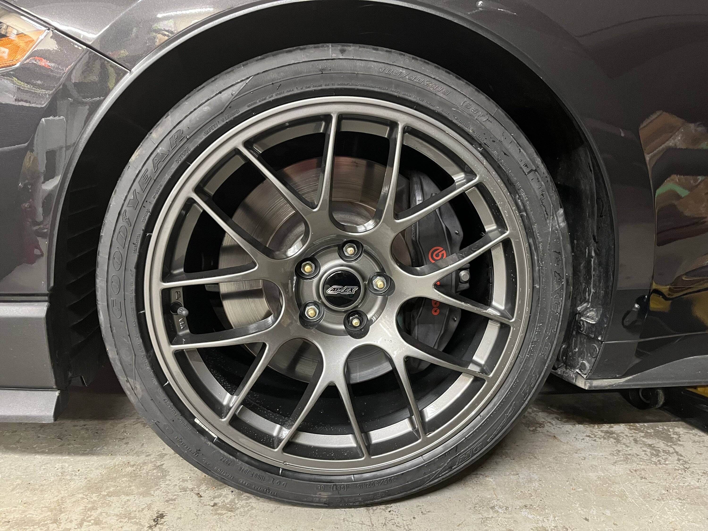

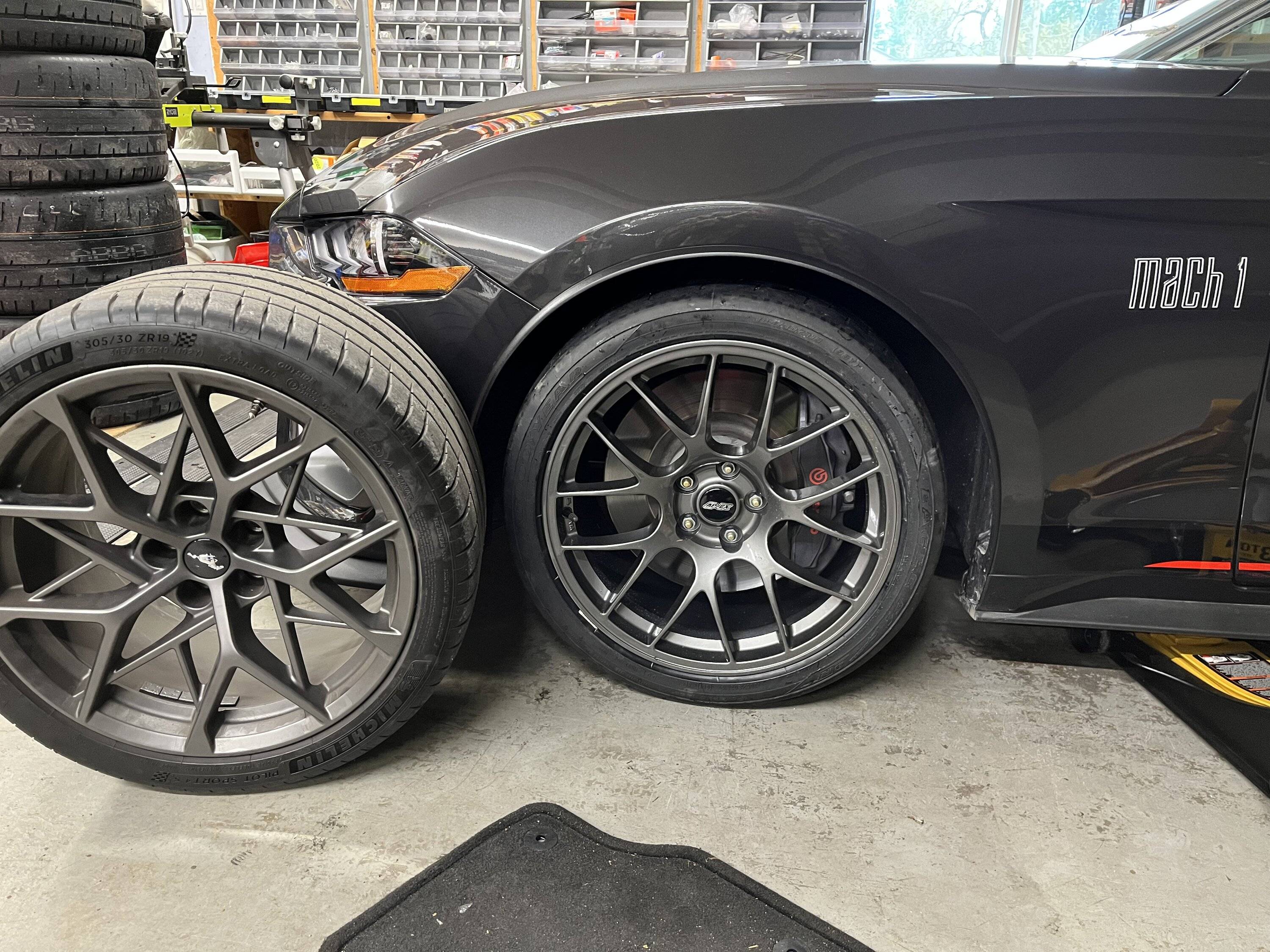

Here's the pic. One shows the FP wheels next to the Apex for comparison.

They look good! How do you like them so far?
The clearance between the top of the tire and the shock is 5mm. So I was concerned that it is too close with tire flex. But the wheel alignment center and APEX said it would be fine and 5mm is plenty. It's been wet here so I haven't had a chance to try them on the track yet(I have GY Eagle Supercar F1 - dry on them). Hopefully by the end of this month I'll get to try them.

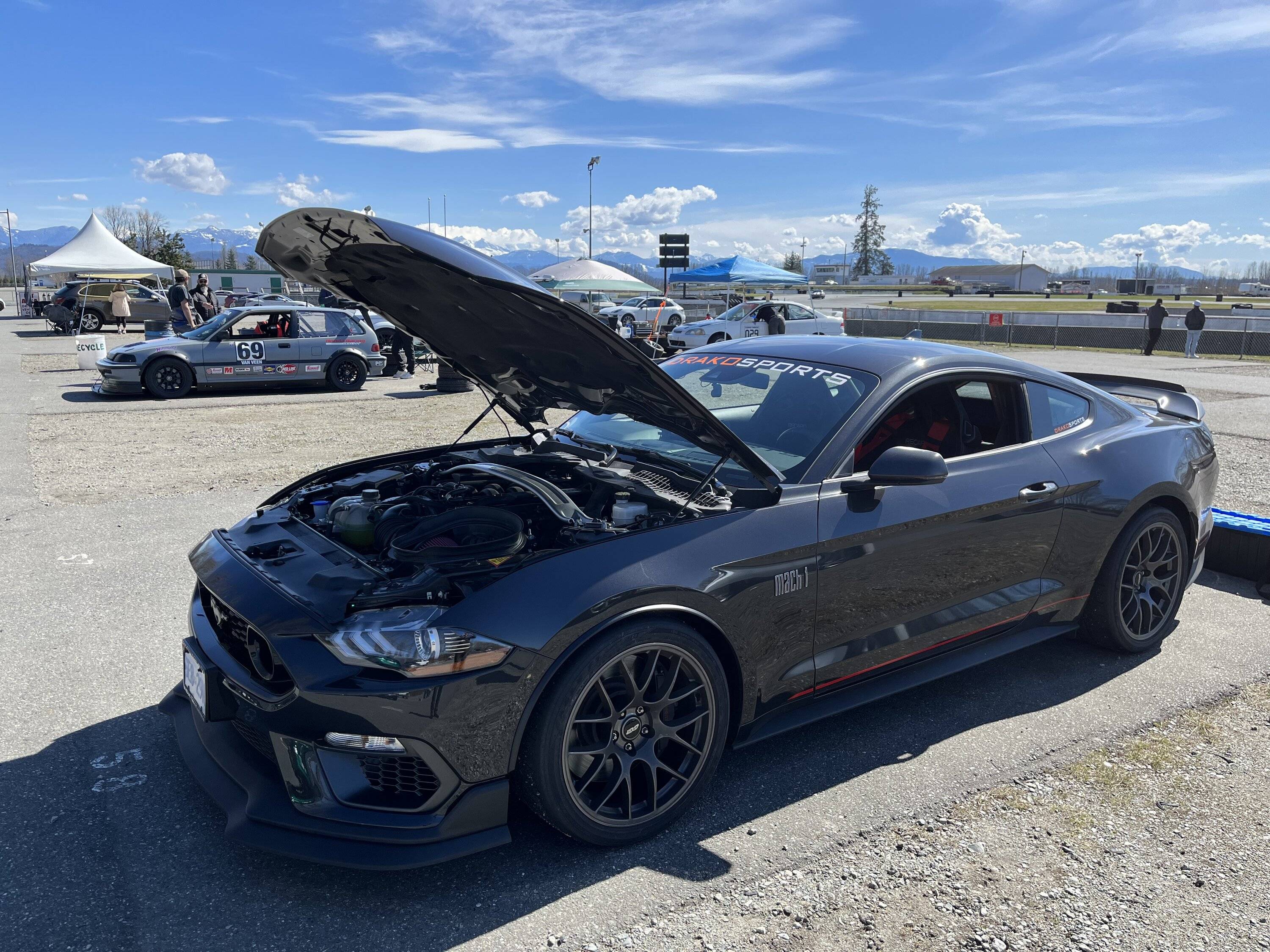

Tried the Apex wheels out last week. They worked out quite fine. It was cold so in the beginning stages a bit cautious but as they heated up they performed much better. The clearance was good. Found no scrapping or scuffs anywhere in the inside front wheel well. So all good.

Ian, they look good! Mine should be here in a week or so. How did the Garmin perform?

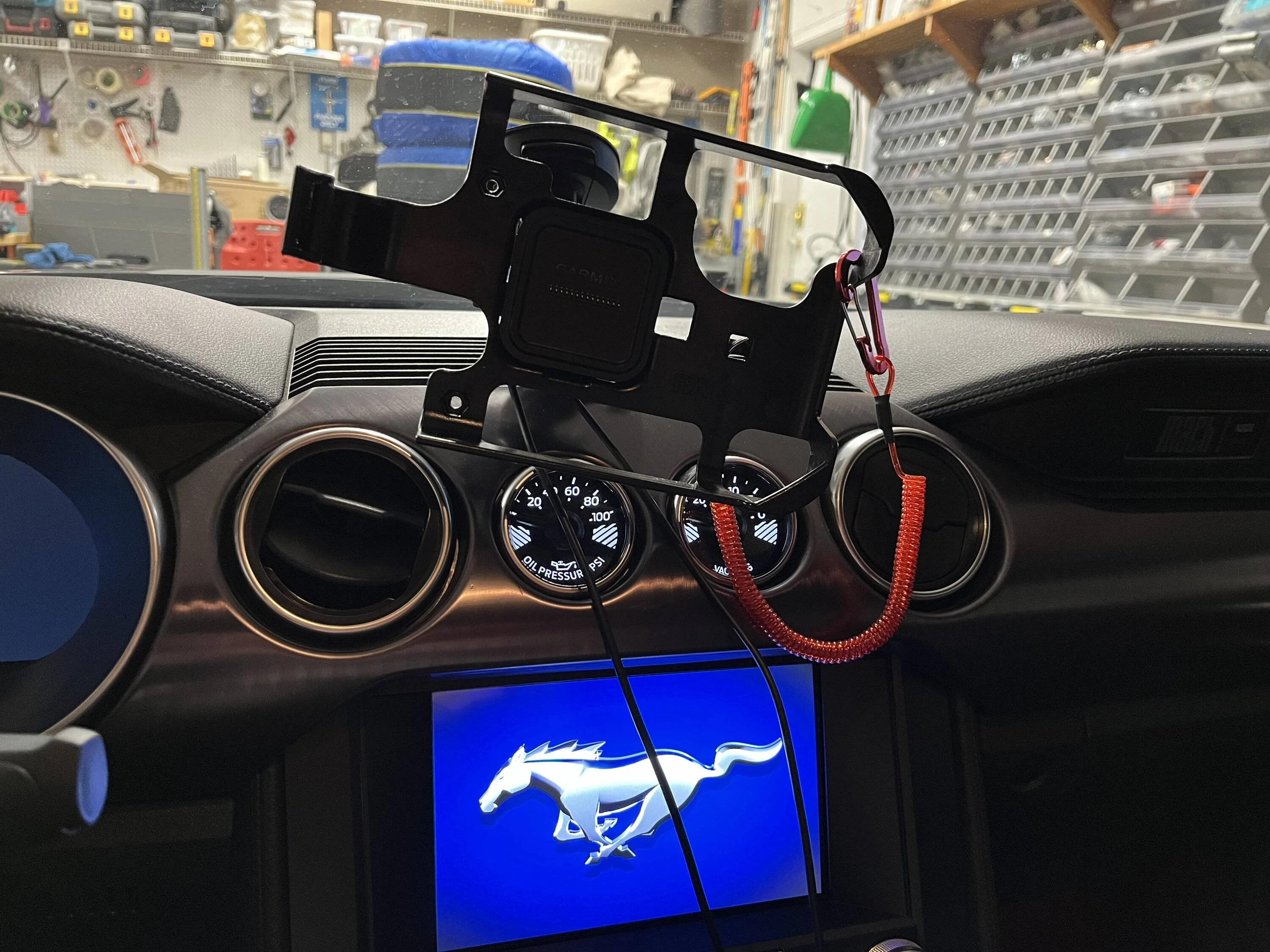

Garmin Catalyst was great. I never got the car speaker to link while driving so I couldn't turn up the volume. But got me some earphones so I can hear the 'advises' from the device next time. I'll also play with car speaker set-up. Reviewing the data is impressive and everything the reviews claim. Well worth it. I got the cage as well for added stability. I thought by sucking it to the windshield would obscure my view but it did not.

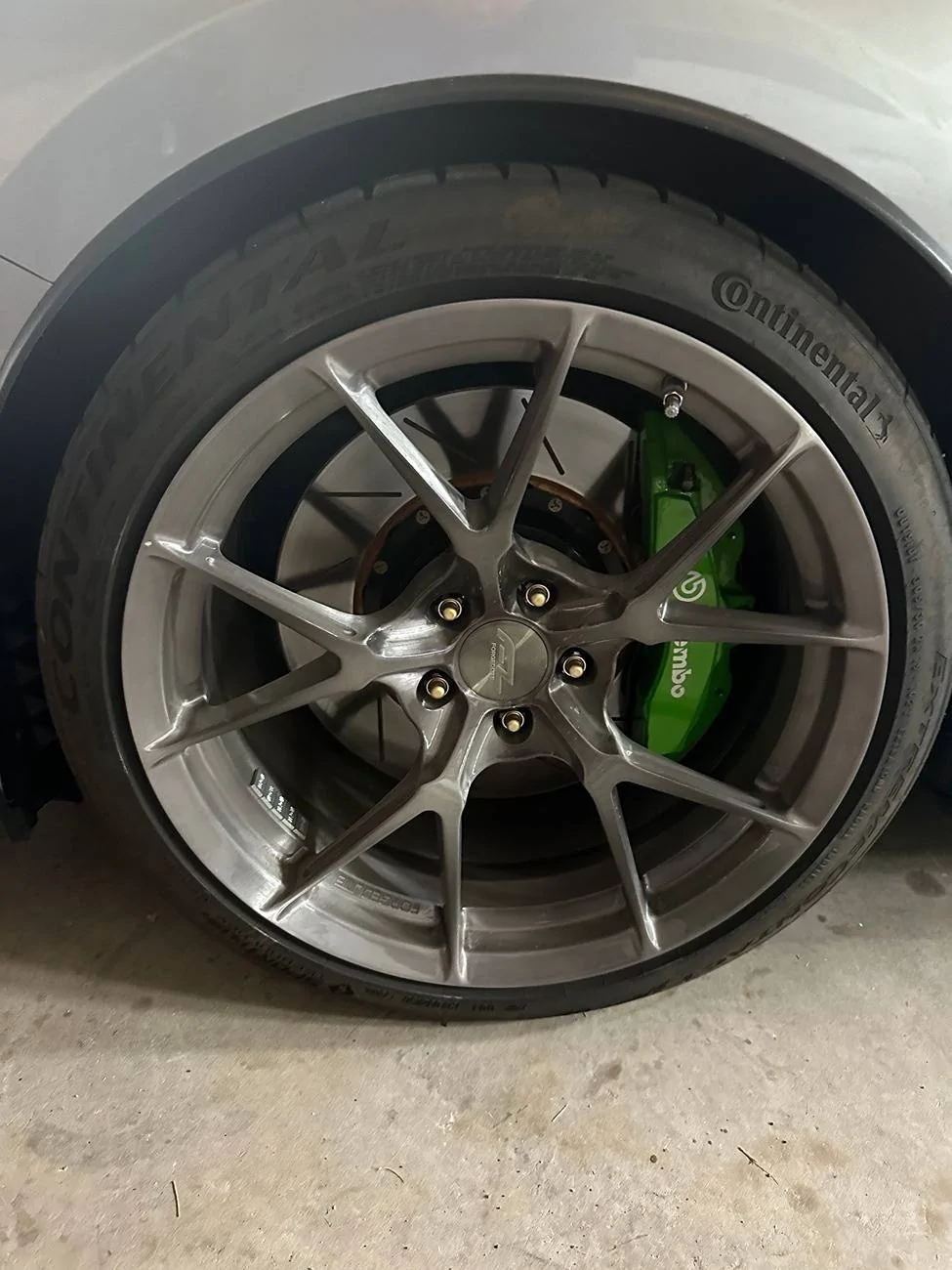

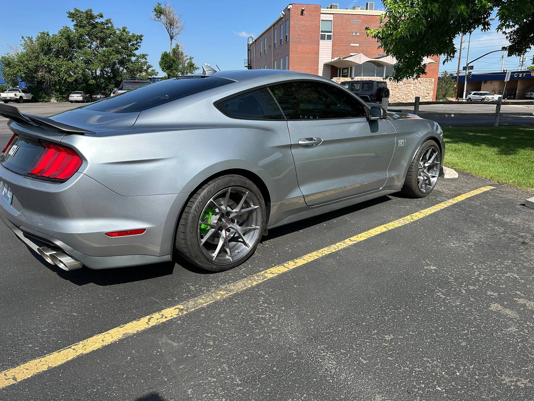

Happy with my ForgedLite MC5's. 10lbs lighter than the HP birdnest, can be made in any diameter, width, offset you want ( I chose the GT350 R fitment - Fronts are 19x11 +24, rears are 19X11.5 +56). in conjuction with 2 piece rotors, I lost 17lbs of unsprung weight off of each front assembly. Yes, you can feel the difference.
