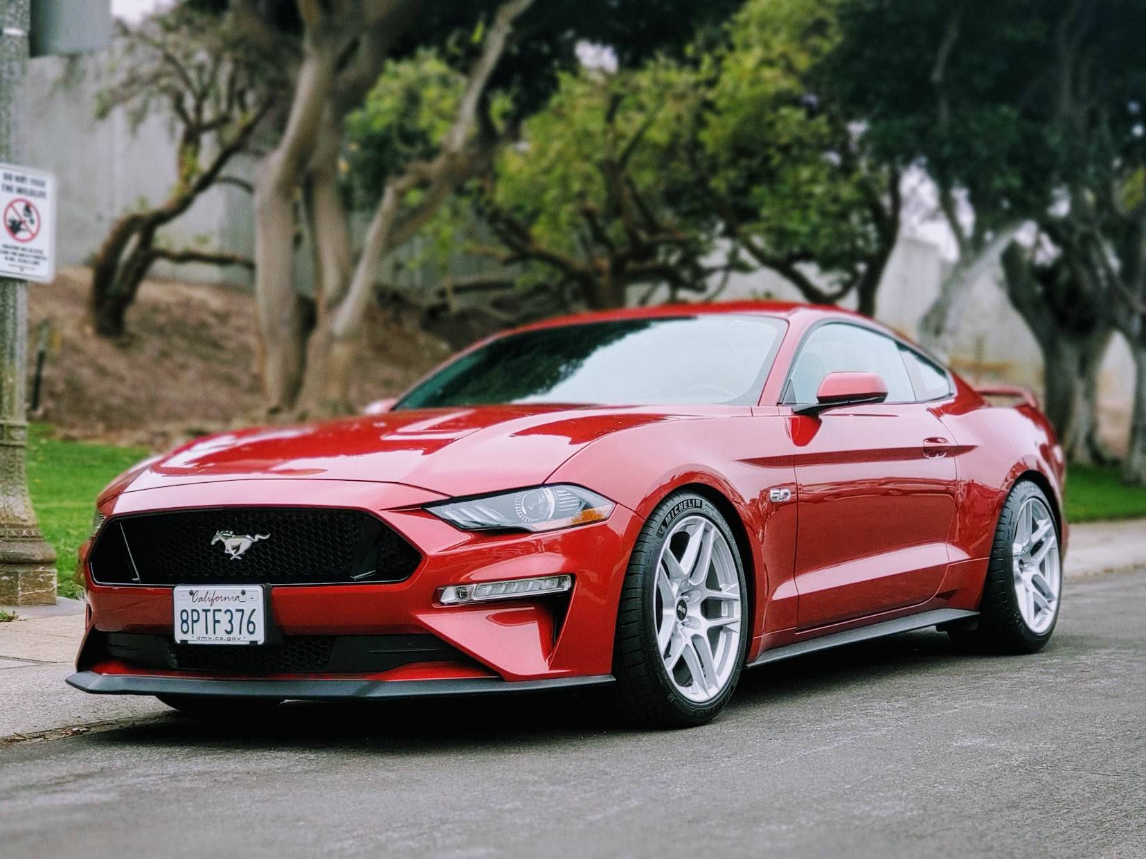

The driveshaft seems to be hit or miss on vibrations and NVH. Also a lot of money for the benefit. I run the SVE X500 in 19X10 ET35 24lbs and 19X11 ET50 23.2lbs. My car is down to 3700lbs with 3/4 a tank of fuel.
I wish my car looked half as good as yours
