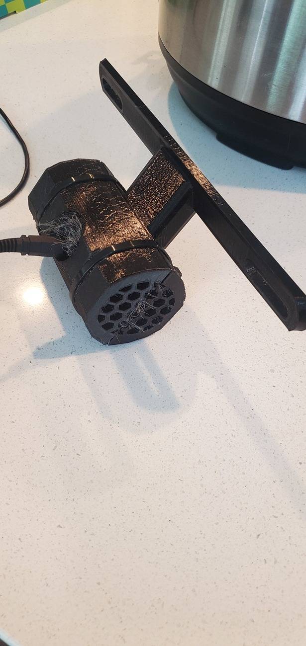

I too run a stereo mic with foam over the mic, inside a windsock, inside a 3d printed case. I also just throw it in to the trunk by wedging it into the foam as well sometimes. Audio quality is much improved, but I can still blow out the high end of the audio sometimes when using the external mic placement leading to pops in the audio.
You can see the 3D printed mount here above my license plate
Mic inside in the trunk
Mic outside on the bumper - you can hear the cracks when the audio blows out the mics.

Where the spare tire inflator goes. GT350's don't get a spare.
Here's the mount.
