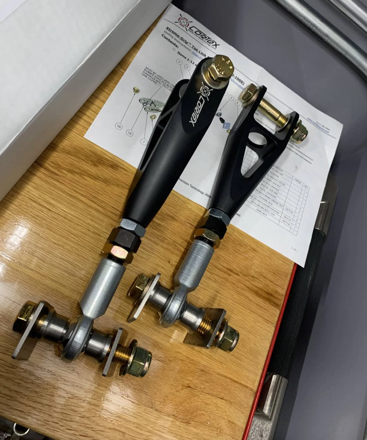

Sadly the Mach 1 comes with the standard bushing. I was under the impression it had the bearing. I installed Cortex links and was depressed to see it's a big soft ole' bushing. In my opinion the adjustable links offer no advantage other than ease and maintenance of toe setting unless you also replace the bushing. I have the Ford Performance bearings ready to be installed in the off-season. There's also a claim that the toe links on the Mach 1 are upgraded to a GT350/500 piece by many, mine are the same as all the GT ones.

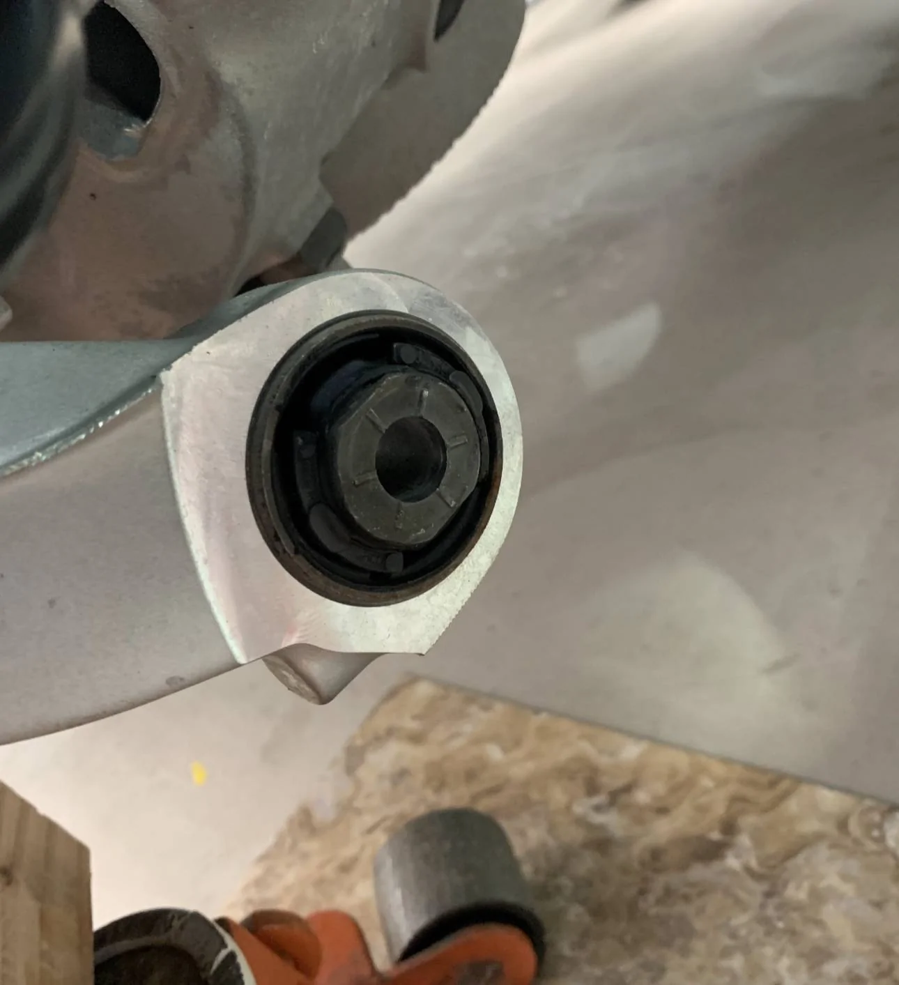

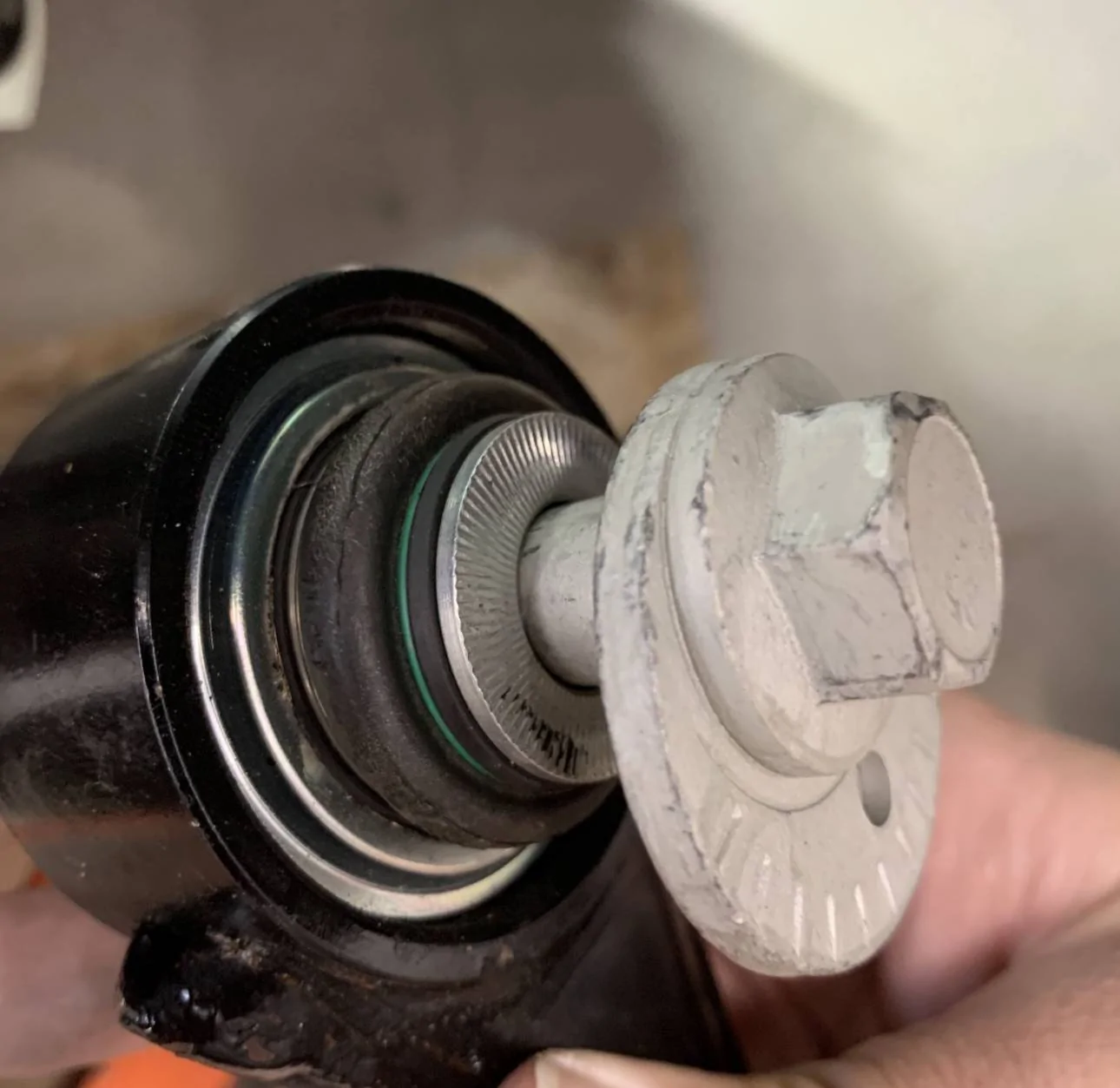

The ones I’ve seen are no different than the Performance Pack ones shown in the attached. The chassis side is a spherical bearing and knuckle side is still a large soft bushing. Aftermarket toe links won’t gain any stiffness or lessen deflection unless you replace the bushing with the FP knuckle to toe link bearing which the Mach 1’s do not have. Perhaps the Mach 1 has a stiffer knuckle bushing but it’s still soft as can be :-).

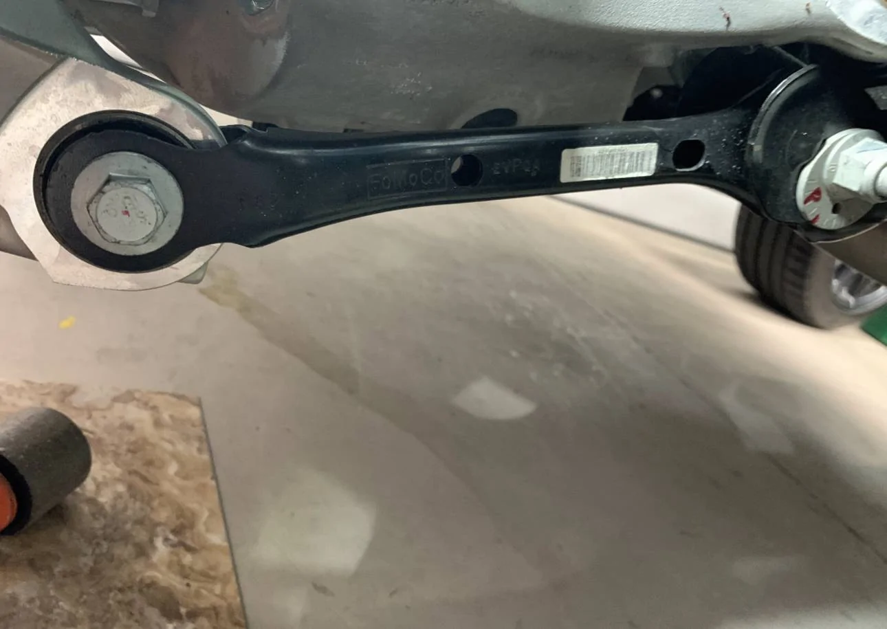

There might be a geometry difference in the GT500 rear subframe that changes something dimension wise on the toe link that connects to it, but functionally no difference: one end is a bearing and the other end bolts to a soft bushing in the knuckle.
Meaning it looks and functions like a regular PP toe link but is a different length/part. In which case I’m wrong, but functionally they’re the same.

Here’s some pics I have when swapping the handling package last summer.

dude those cortex things look dope as hell. is the threaded portion of the assembly smaller than the steeda unit?
also, putting these in but keeping that stock rubber toe bushing isn't doing you any favors. you're better off keeping the stock unit and doing the bushing than vice versa.
