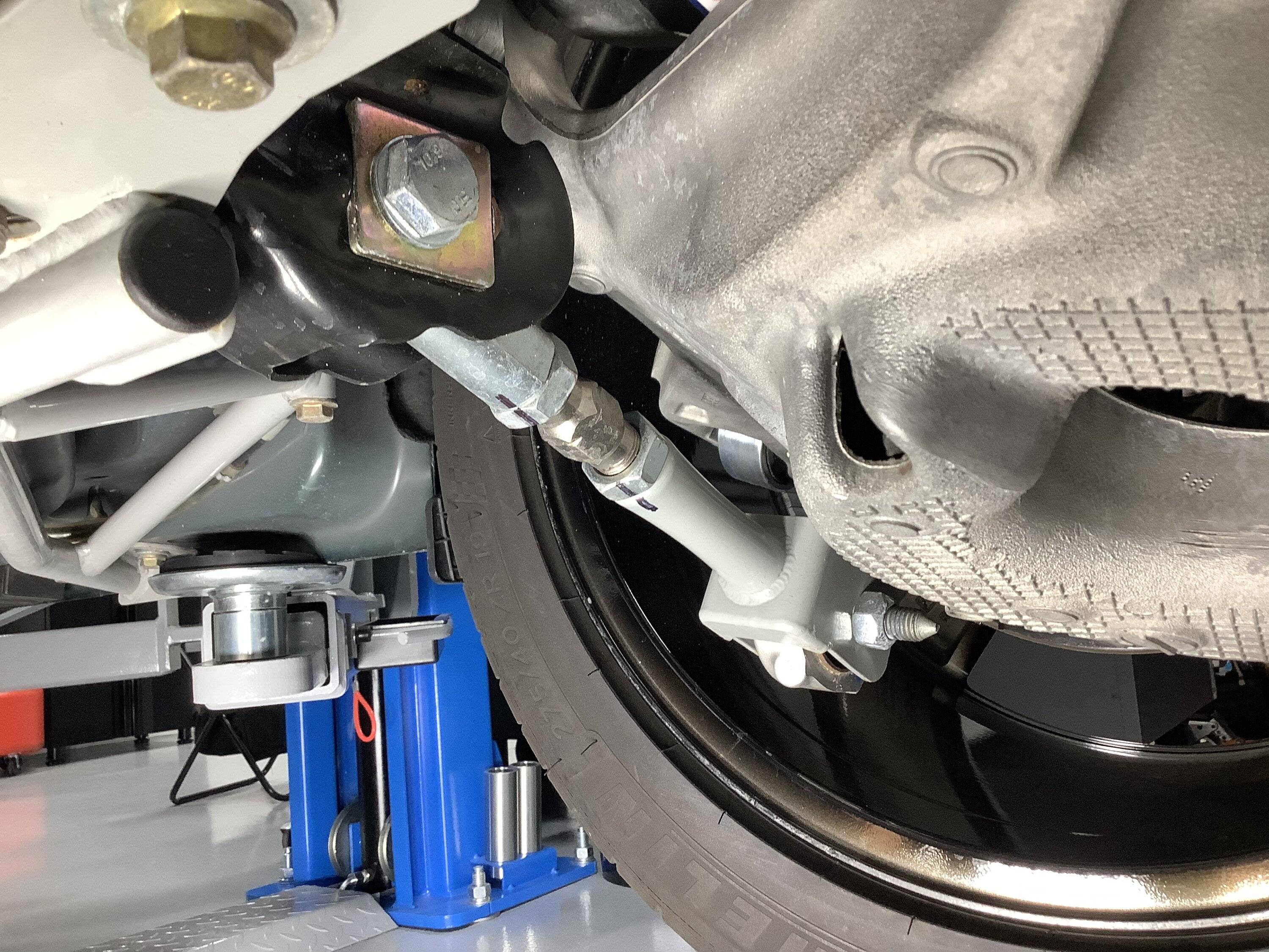

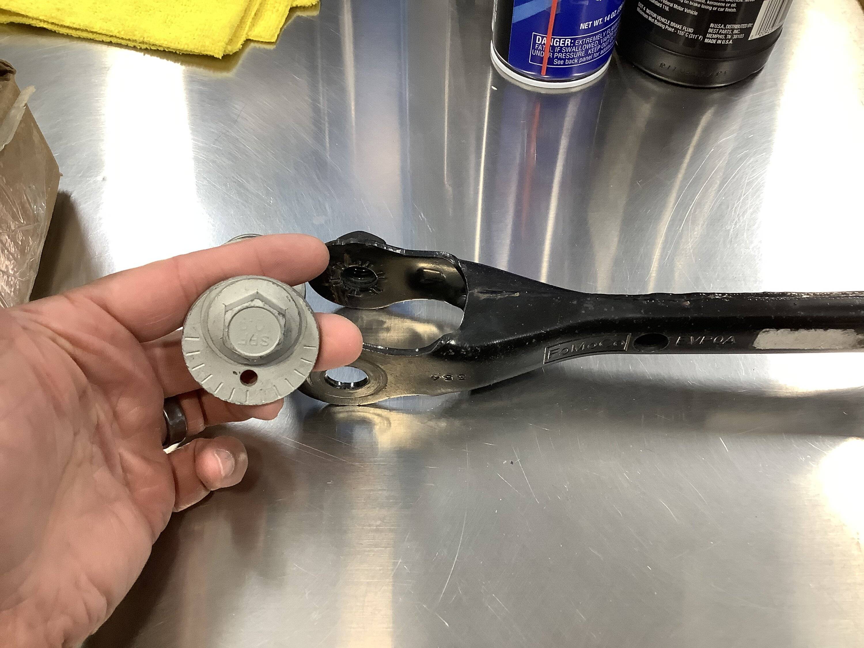

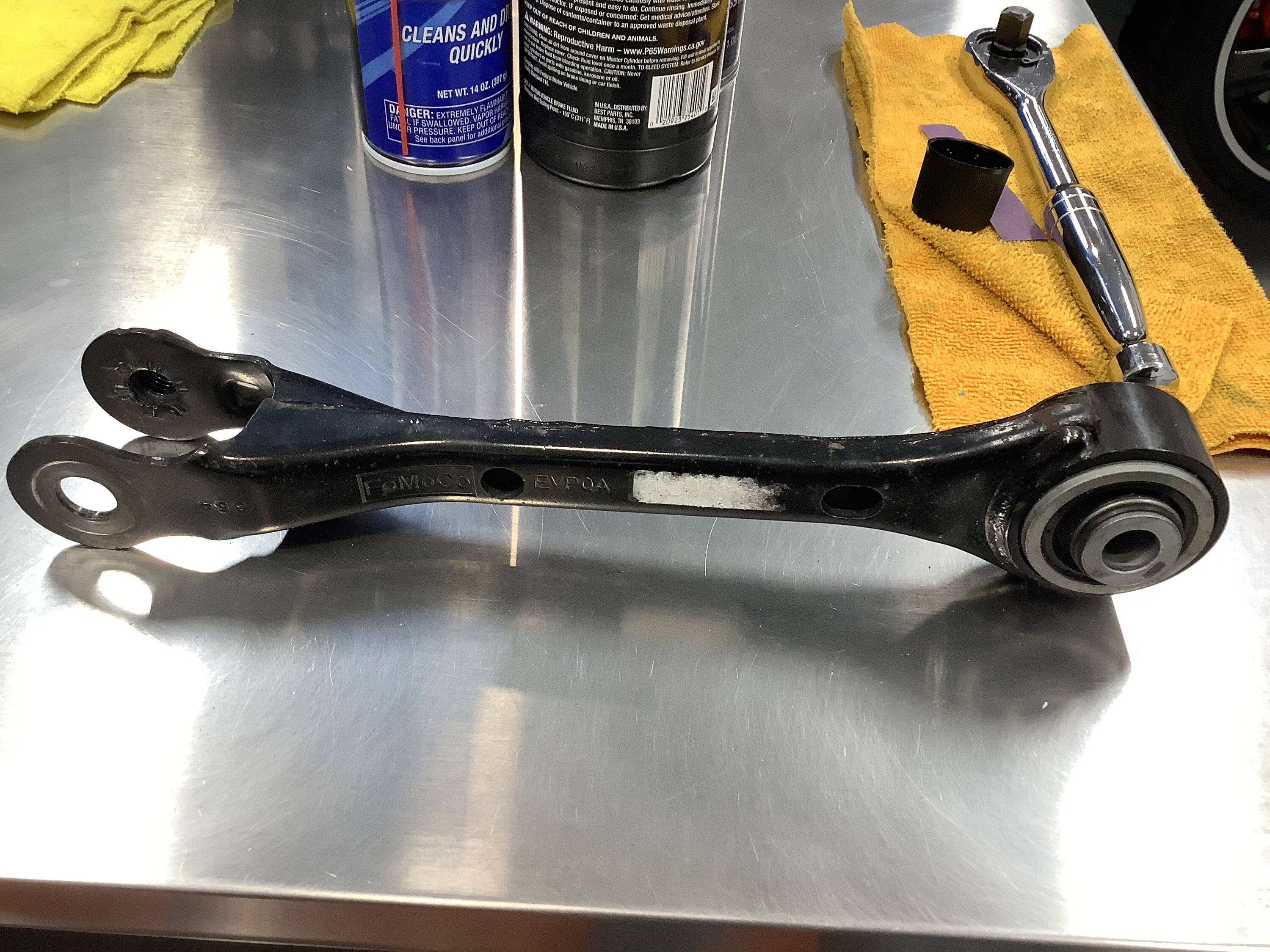

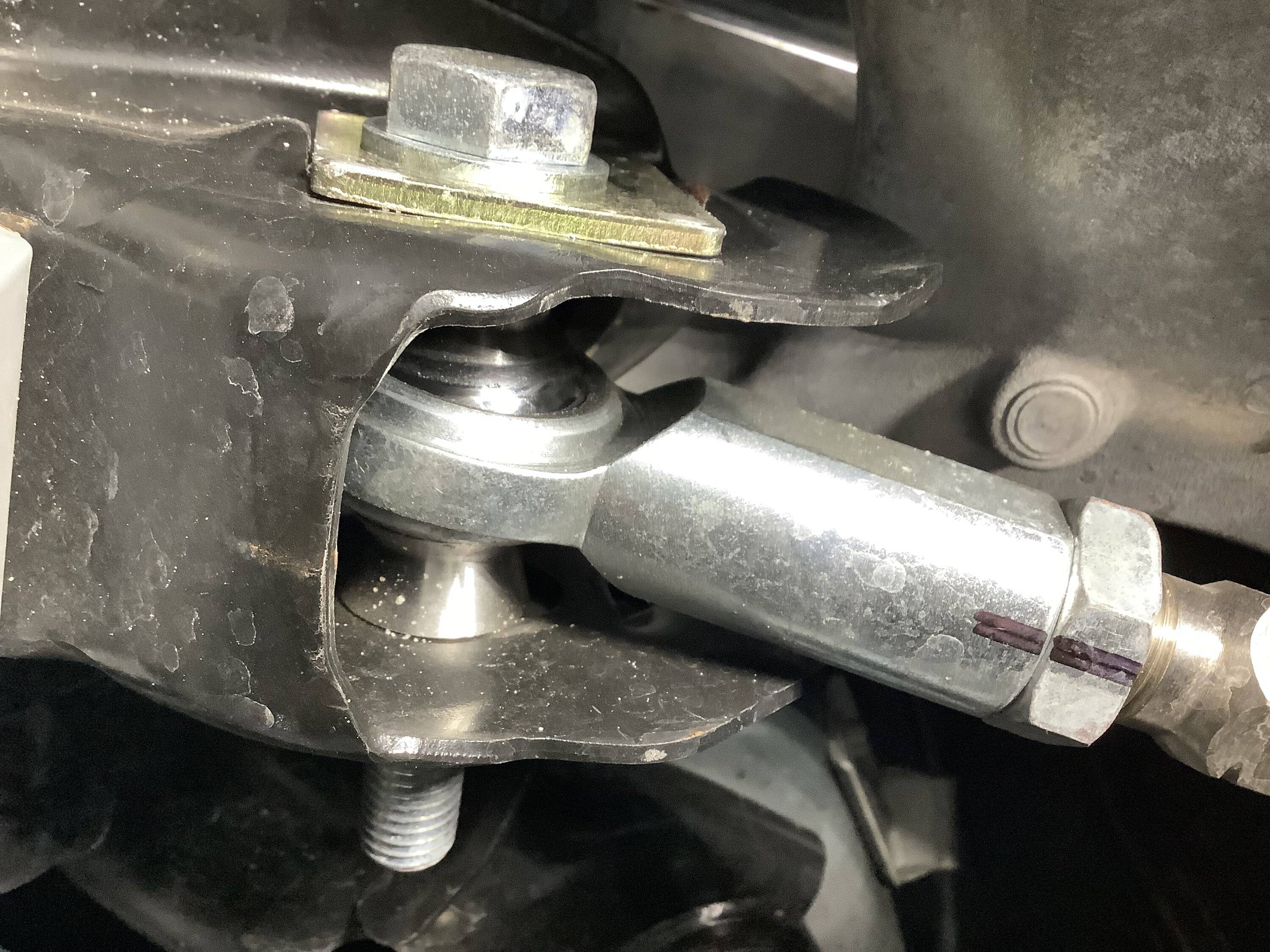

I replaced the factory toe links on my 2019 Bullitt. They do have some adjustability via a cam style adjuster, but they aren’t anything like Steeda’s which have lockout plates to prevent slip.
Factory adjustable toe link
Steeda adjustable toe link

Sorry, I failed for answer your question of ease of adjustability. Yes, the Steeda toe links are easier to adjust than factory, not to mention they are more robust. Stay and let me go pull the factory ones out and get you some better pics.

Okay, here are a few better pics for comparison. Notice the cam style adjuster for the factory links vs the gold colored lockout plate which replaces the factory cam adjuster for the Steeda links.
Behind the Steeda lockout plate is a slotted hole that gets locked out to prevent slip. That slot is used with the factory links and cam adjuster to give you a range of adjustability, but could also slip under extreme conditions and cause a loss of your toe settings.

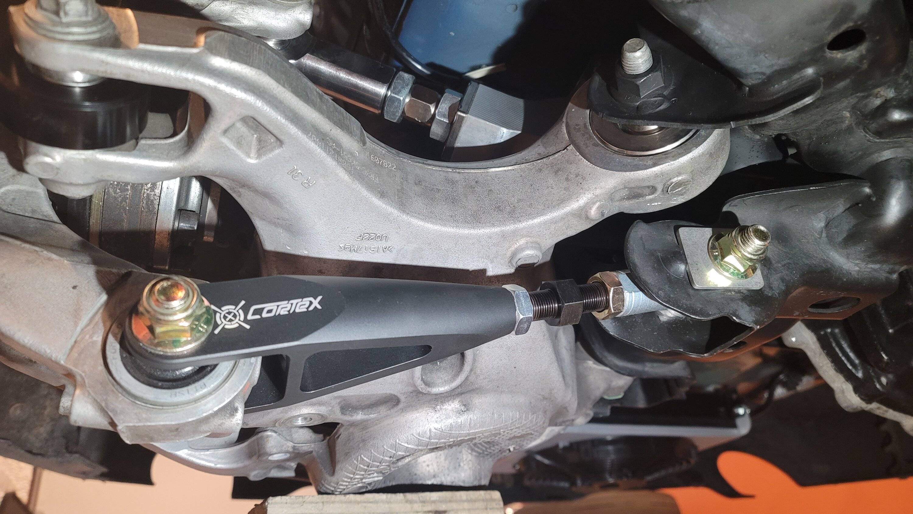

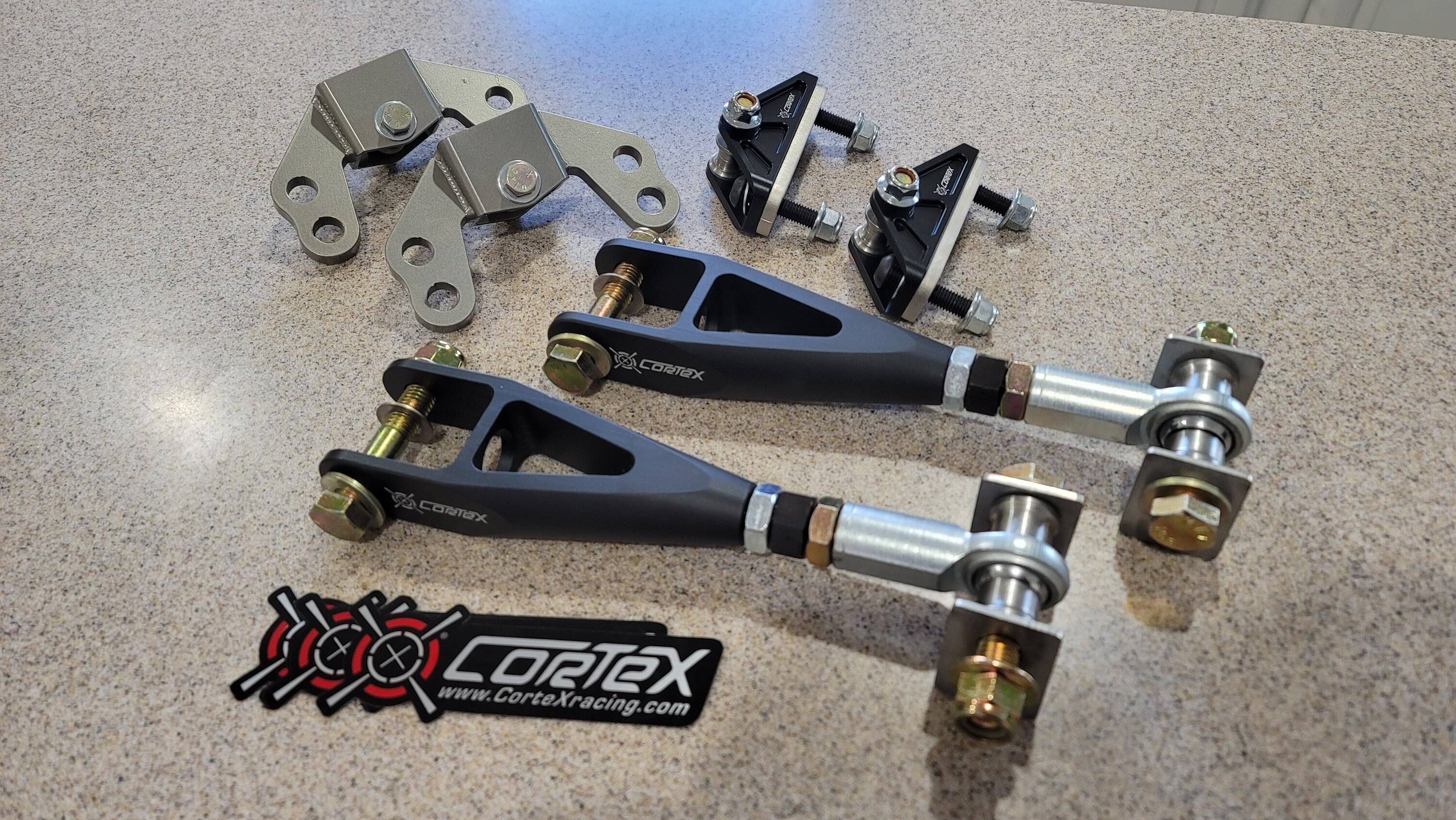

They look really nice :sunglasses:
What are the other pieces towards the top of your photo ?
WD :like:
Top secret!
No jk. It is the Crotex shock mounts. They will require an eyelet kit for my Vikings. I'll have them soon and will show the install on my build thread.

I was going to take a wag at it and say that’s what they were. It looks like you’re also setting up to run the brace inside the trunk too.
I have not looked into those.
