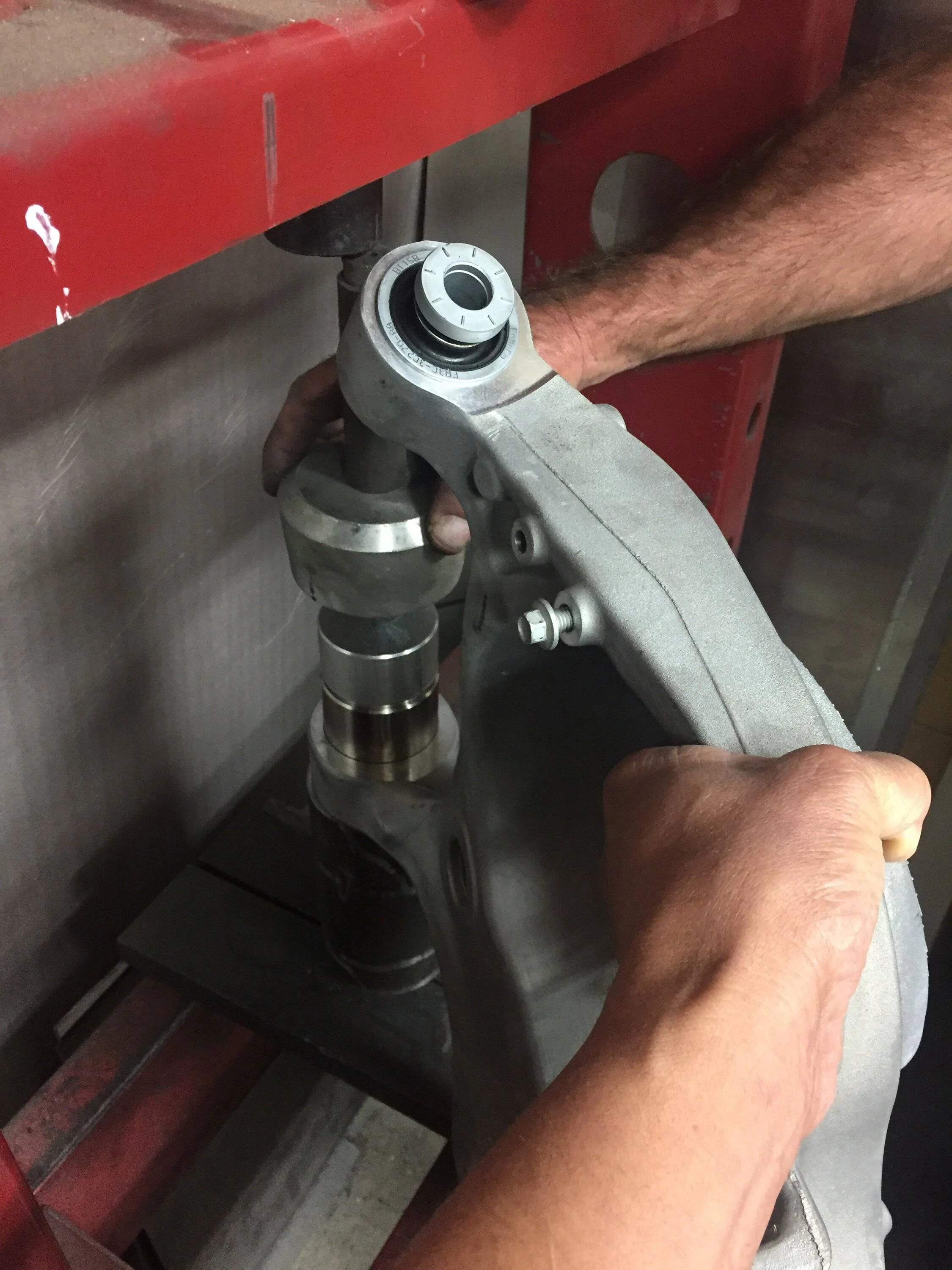

While that bushing is rubber, the center portion is able to articulate almost like a spherical bearing. Now the bushing that gets removed for the spherical bearing does not. See pic here.

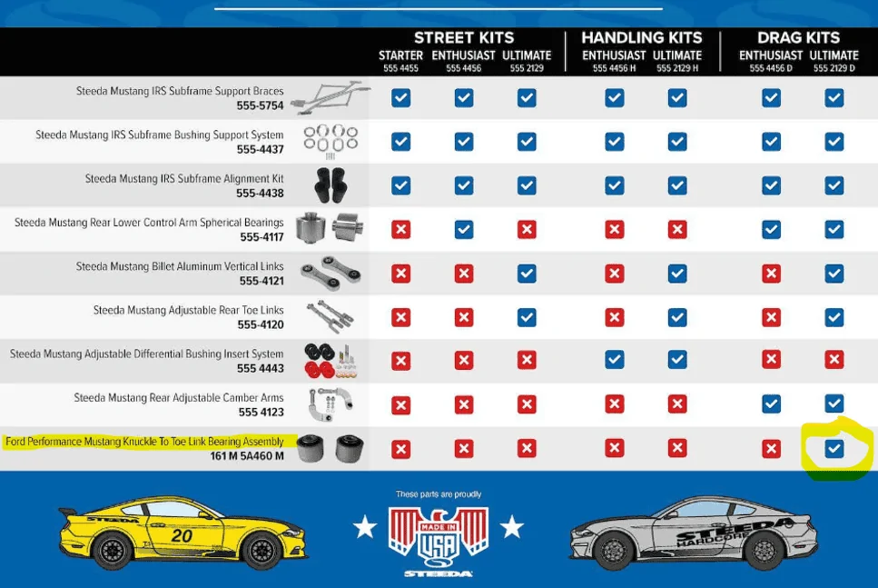

Guys, thanks so much for expanding this thread, it's really helpful. So, just to be clear it seems that many of you are suggesting that in addition to the Ultimate Steeda Street Kit that you would also recommend the Ford Performance Toe Link Bearing Assembly? It's strange that Steeda themselves only recommend it for Ultimate Drag Kits.

2019 Bullitt
i didn’t upgrade that bearing in mine. Maybe certain models come with a different bushing/bearing than what is seen in the pic of my control arm. You can literally grab the sleeve in the middle and move it in any direction you want to without it binding.

I think PP toe link has a bearing on the knuckle side (non-PP car has a bushing ?) as well as pretty much every aftermarket toe link. Probably every Mach got
It is not just the binding - it is also "linear" compliance - try "compressing" the bushing (push the bolt going through it towards outer diameter of the bushing - bearing gives you same or or better rotation with virtually no compliance that effectively changes suspension geometry (in this case toe) - makes sense ?
Is it a recommendation or is it what is in the kits their offer ? None of these mods are really needed / required and from most you'll benefit if you try to push the car towards limits of its grip (which 99.9% of Mustang drivers do not).
Bearings make huge difference but do you need it ? Also with removing compliance they also increase NVH (regardless of what the manufacturers are claiming) and they're major PIA to install (as opposed to basically anything else on that list which is pretty trivial and takes about 30 mins to an hour each at home).
