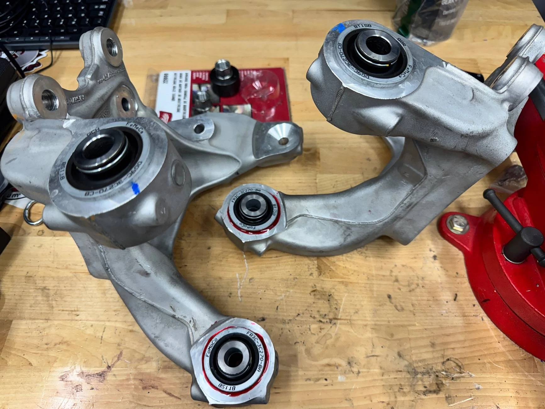

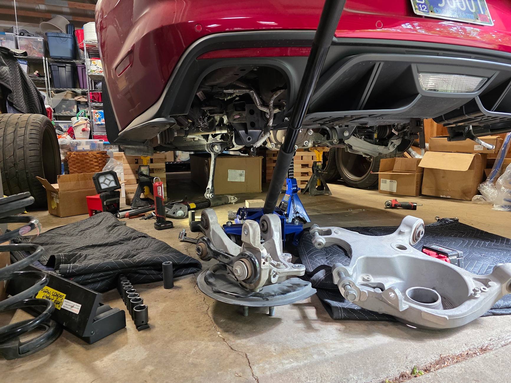

I'm knee deep in this job right now, and figured I'd share what I'm learning while failing to accomplish the OEM bearing removal.
The OEM bearing's outer sleeve external diameter is 1.927", and the ID is roughly 1.8".
The FRPP bearing sleeve's OD is the same 1.927", but the ID is about 1.55".
If you're looking for something to press this out with, I'd recommend a socket with a ~1.8" OD. Not all sockets are sized the same, so one 1 1/4 socket may not be the same as another.
Another item of note, the Harbor Freight/Pittsburgh 32mm deep impact socket is about 1.763" OD, which is just enough to punch out the rubber bushing and inner sleeve, but not enough to bite the outer sleeve and press it out. It will bind in there though.

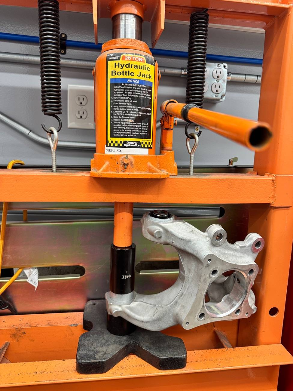

I've done it twice now. Save yourself the headache and get a Harbor Freight Shop press. Removing the knuckle isn't that hard, and you can have the bushing out/in in 5 minutes with a press
A Kobalt 36mm socket works.
I want a press, but I'm about to move a few states over and am trying to minimize the things I need to haul lol. I may do it, but I haven't pulled the knuckles on mine before and am not entirely sure if its gonna be as straightforward as pulling the brakes and axle nut. If it is that easy, I may go that route.

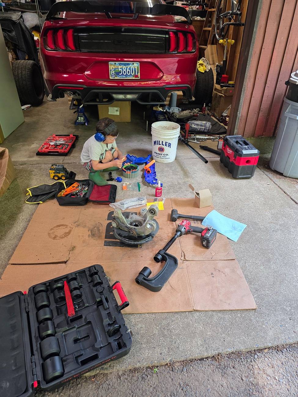

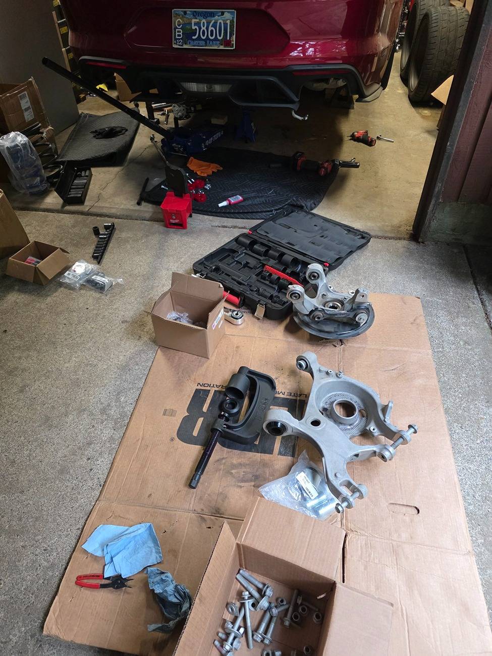

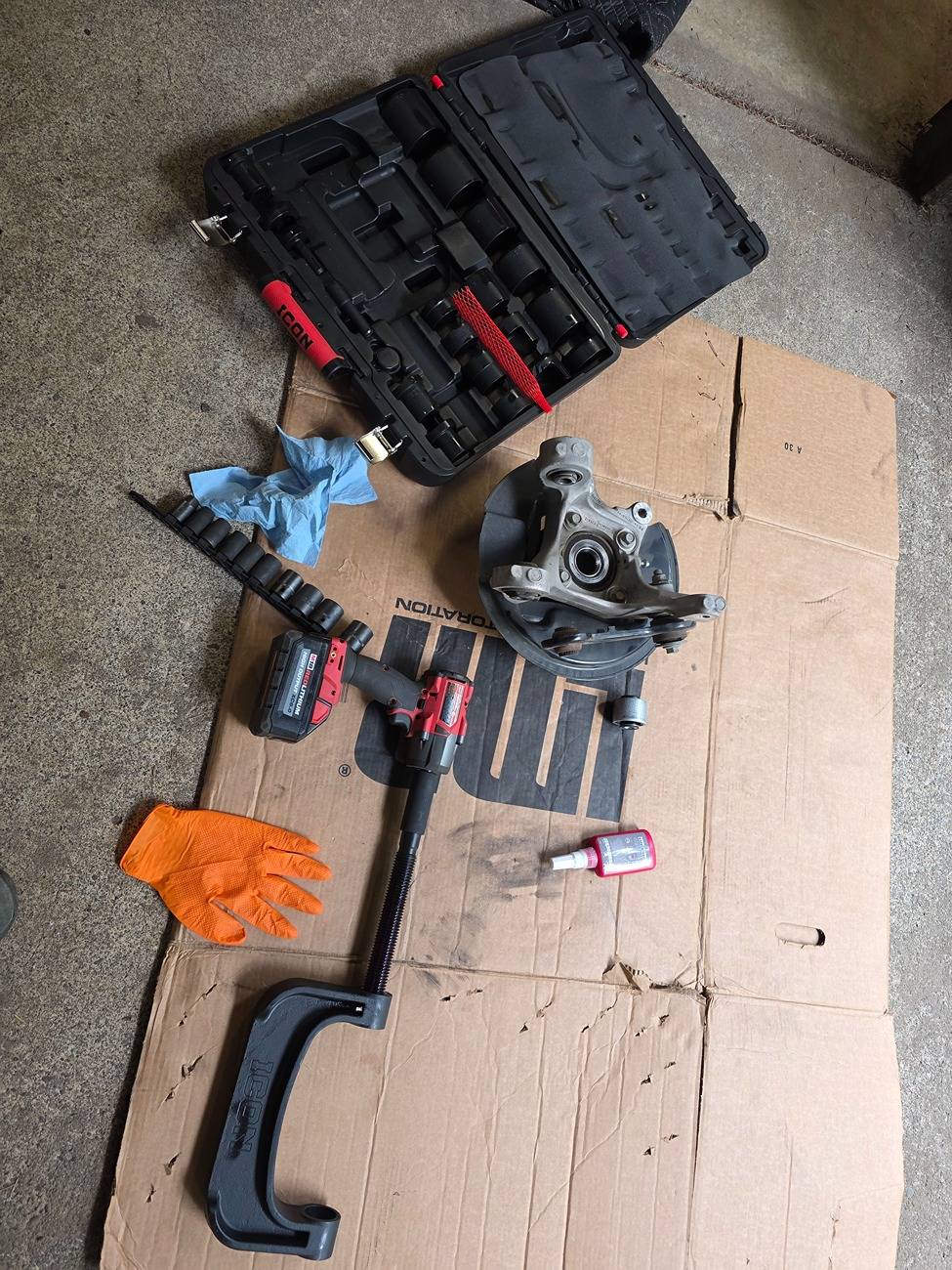

I did not remove the control arm to do this. I used a standard ball joint press with the 36mm socket while the arm was still on the car.
This is plan A. I'm getting the axle nuts and other items so I can R&R the hubs as plan B, but I'm hoping that I can do it on the car.
Agreed! I just pulled both knuckles and it made the job a lot easier. I have a HF press that has paid for itself 10x.

I used the ICON kit. It had every size for pressing in and out all the bushings/bearings I replaced. It was perfect. I highly recommend it.

As others mentioned, a 36mm socket did the trick. Didn't have to pull the knuckles, and it took about 2hrs to r&r both with it.
