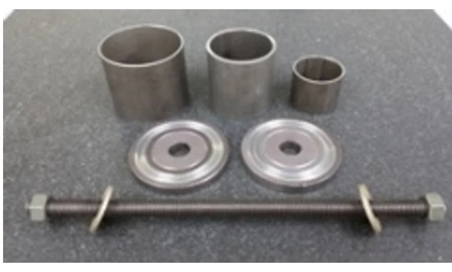

I started on installing mine today. Only got as far as removing the drivers side when I realized I didn't have any red loctite. I will finish up tomorrow. I used the Full Tilt bearing removal tool and a 2 ft breaker bar. The bearing came out with no problem.

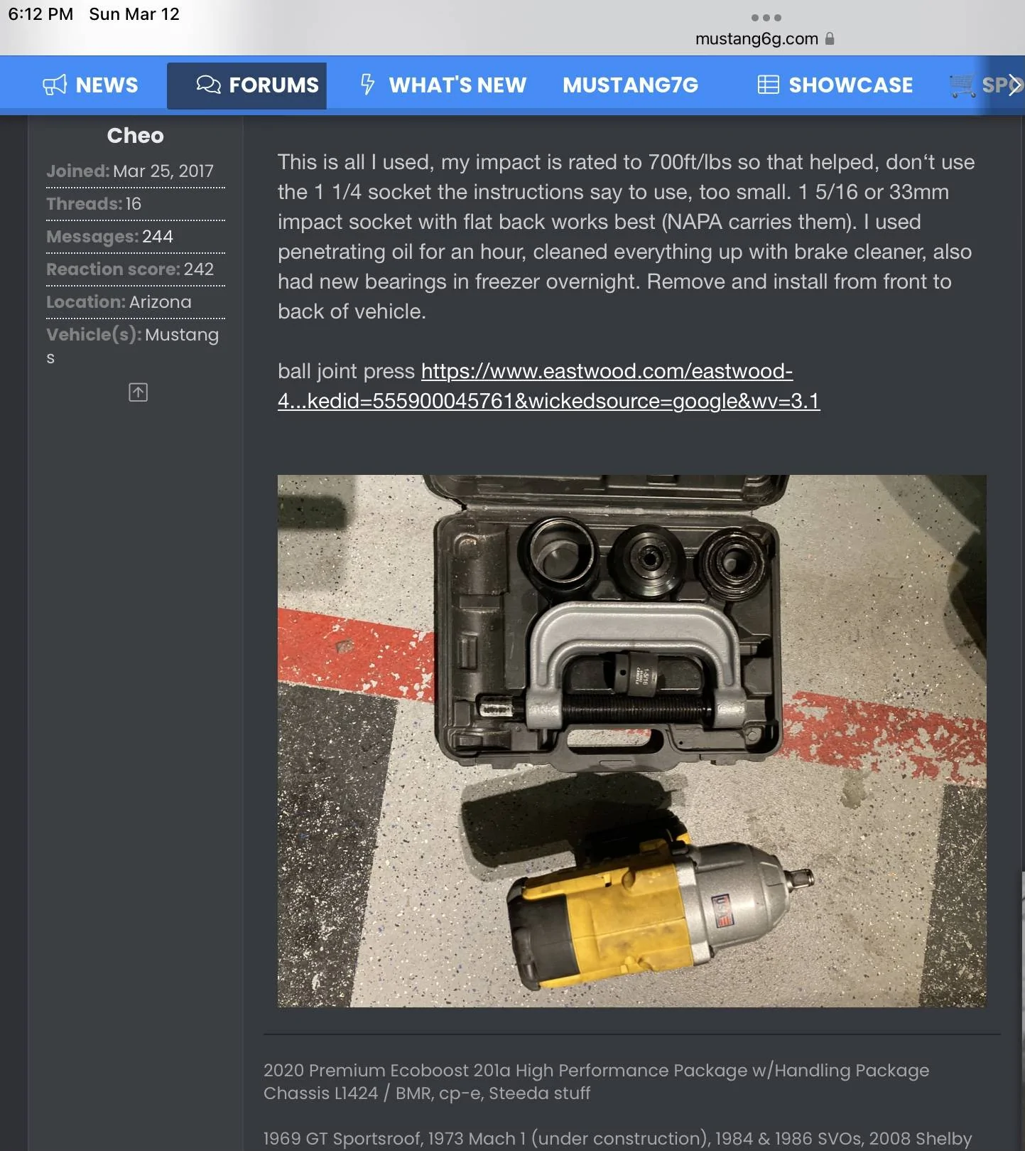

took me two days to remove and install, not an easy job on jack stands. Lots of trial and error finding the right size socket to remove and install them. Freeze the bearing the night before. I fitted a heavy duty torque wrench to the tool I used, it helped a lot!
Please post up comments on your final thoughts once you wrap it all up, much appreciated. Was this the tool you used?

I tried all night with what I had laying around, every combination of big sockets, c clamps, long bolts, gave up and called it a night. Bought a big ball joint press kit from harbor freight next day and had both sides done that afternoon. Not bad with the right tools.
