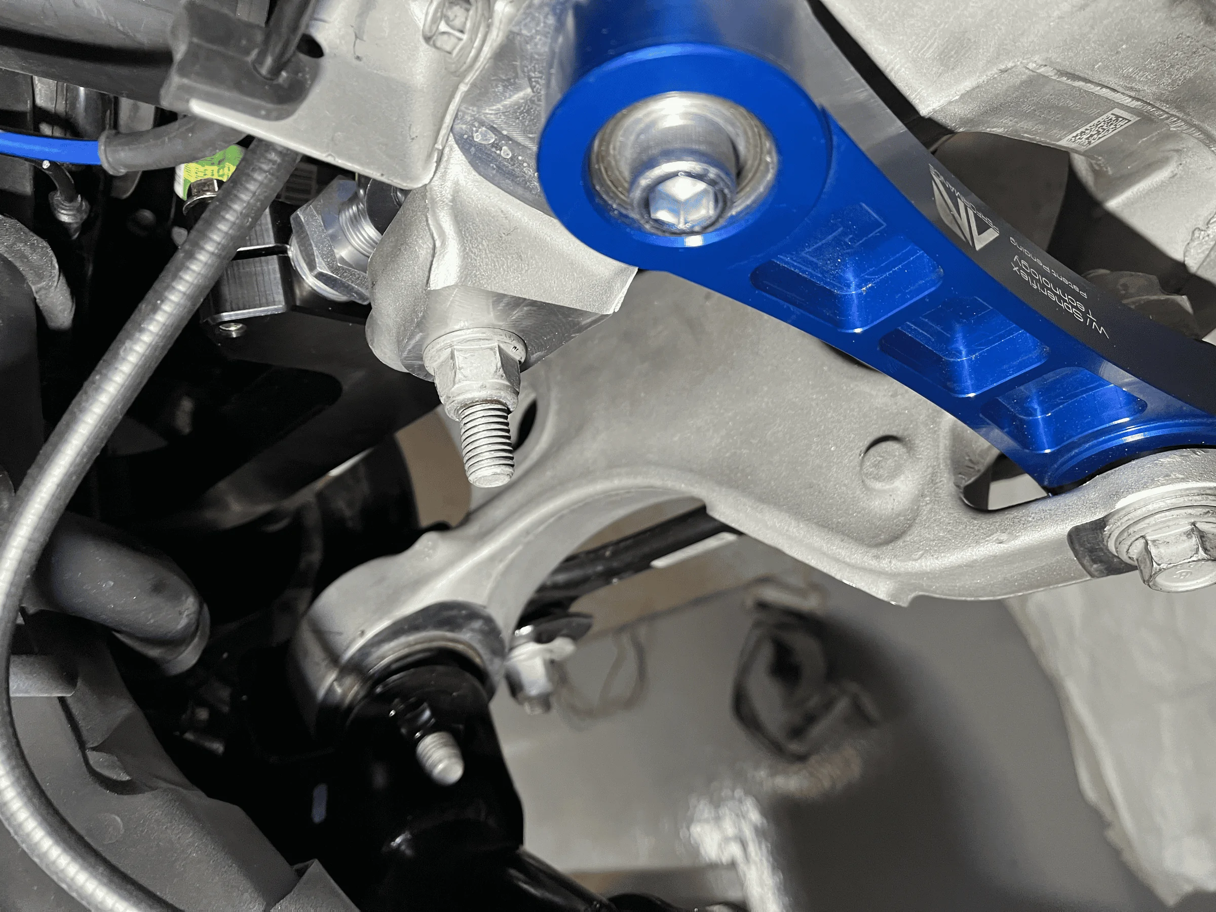

Since I was doing the bushings I decided now was the time to go ahead and install adjustable camber arms and camber lock-out plates. Passenger side much easier to access everything compared to the driver's side. Toe bushings, now that I've done one side just so much easier in a press off the car than on. Just need to torque everything down and then an alignment and all set. I think the rear end is all done now.

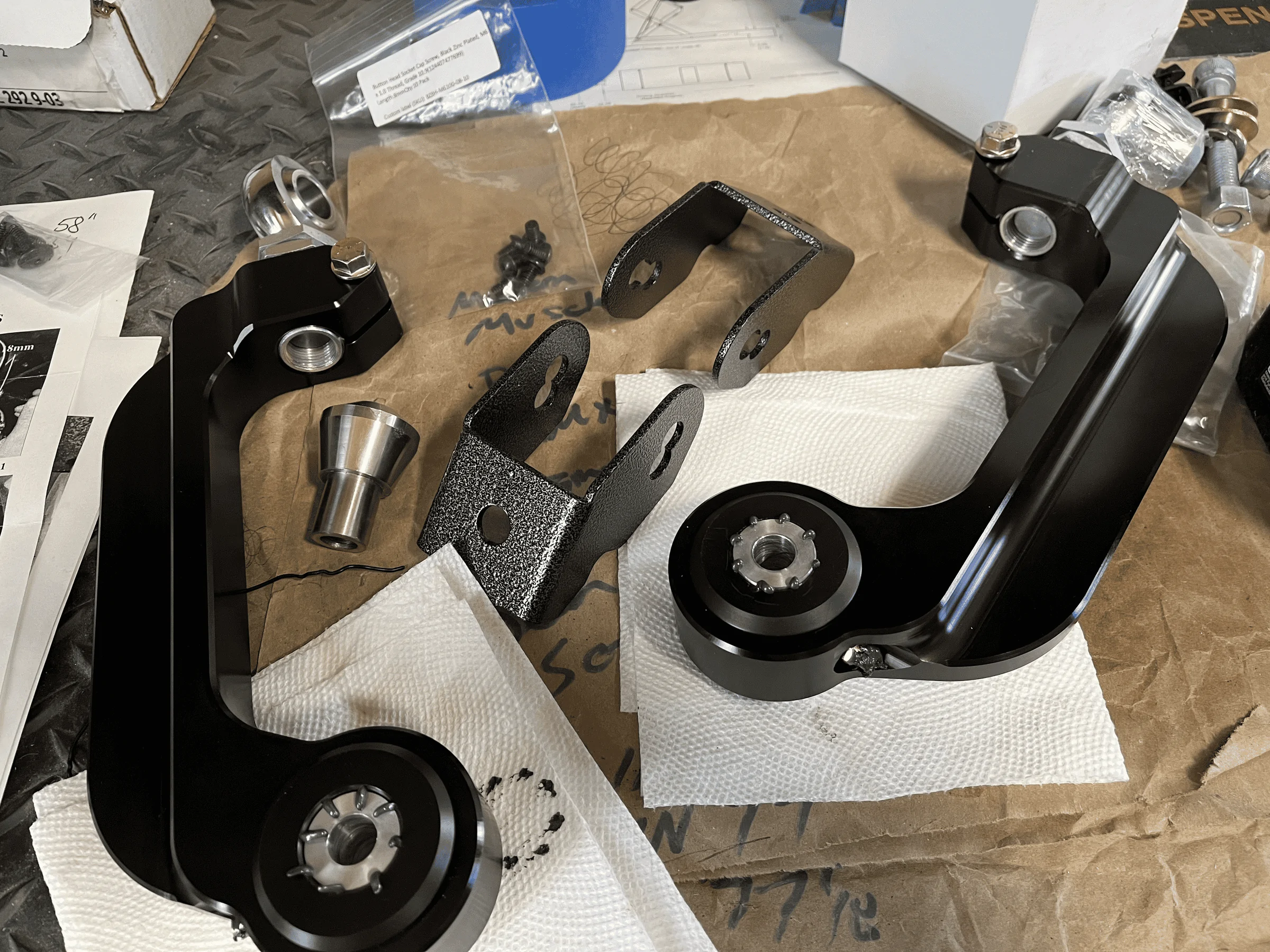

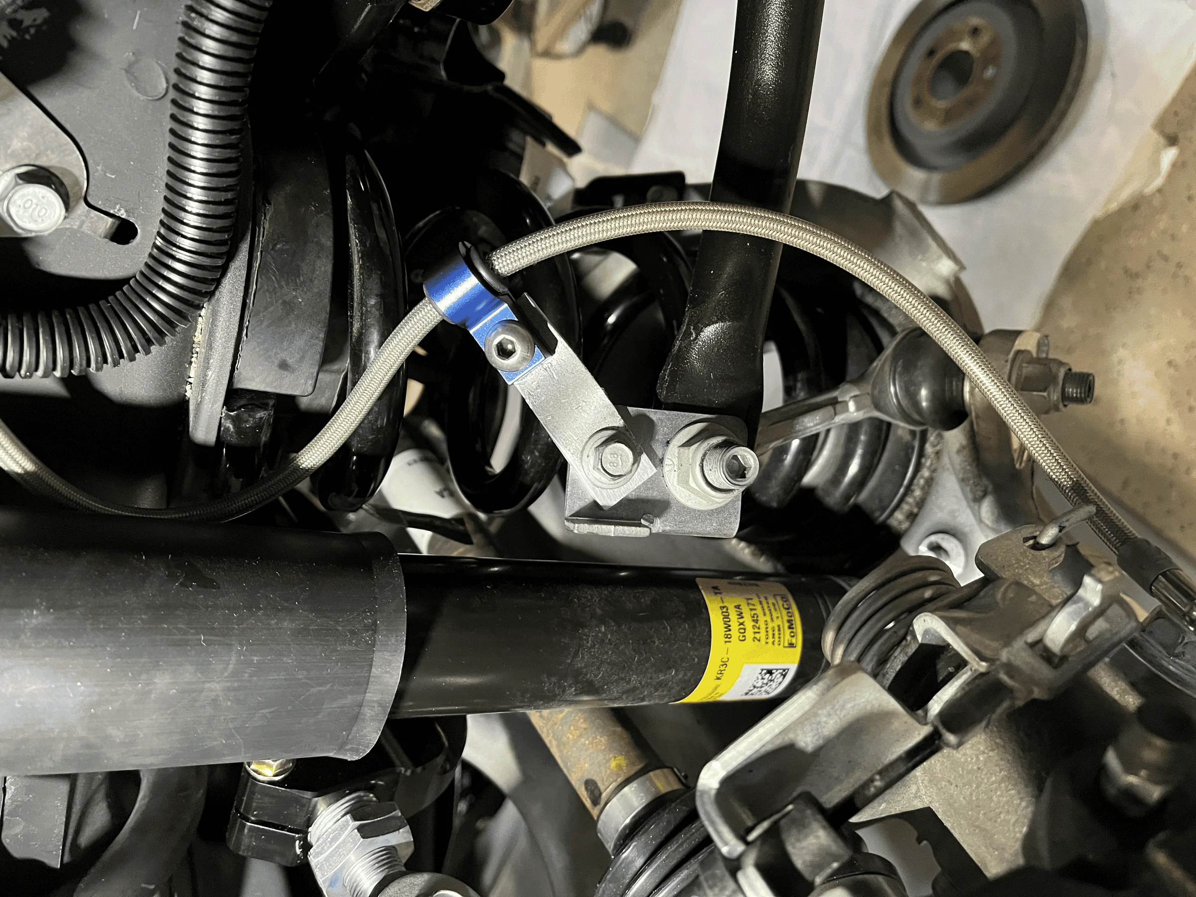

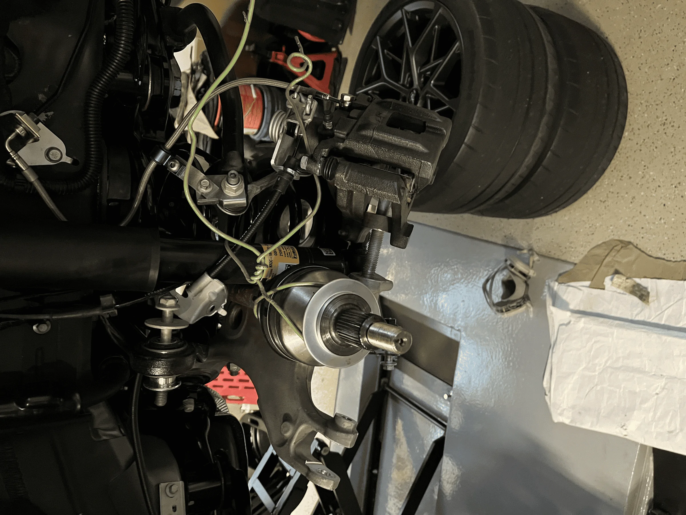

Couple more shots of the rear suspension. I think it's complete for what I need.
1) SS brake lines
2) Adjustable camber arms
3) Ford Performance Toe link bushings
4) Rear sub-frame lock out kit
5) Billet vertical link
6) PFC slotted rear rotors (just ordered, not here yet)
I'm a road track guy and not drag racer so hopefully this will do the trick. Originally was going to run completely stock, but then with price increases on everything thought, I'll move the upgrade program up. First track event VIR end of April.
NGOT8R
Jul 19, 2020
154
9,295
7,799
Adrian
2019 Bullitt
