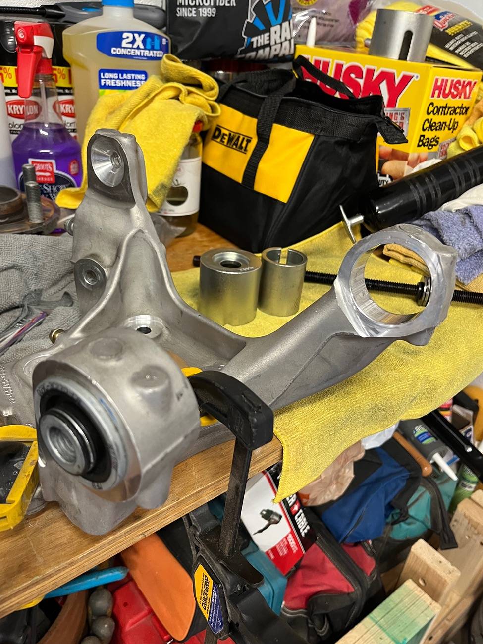

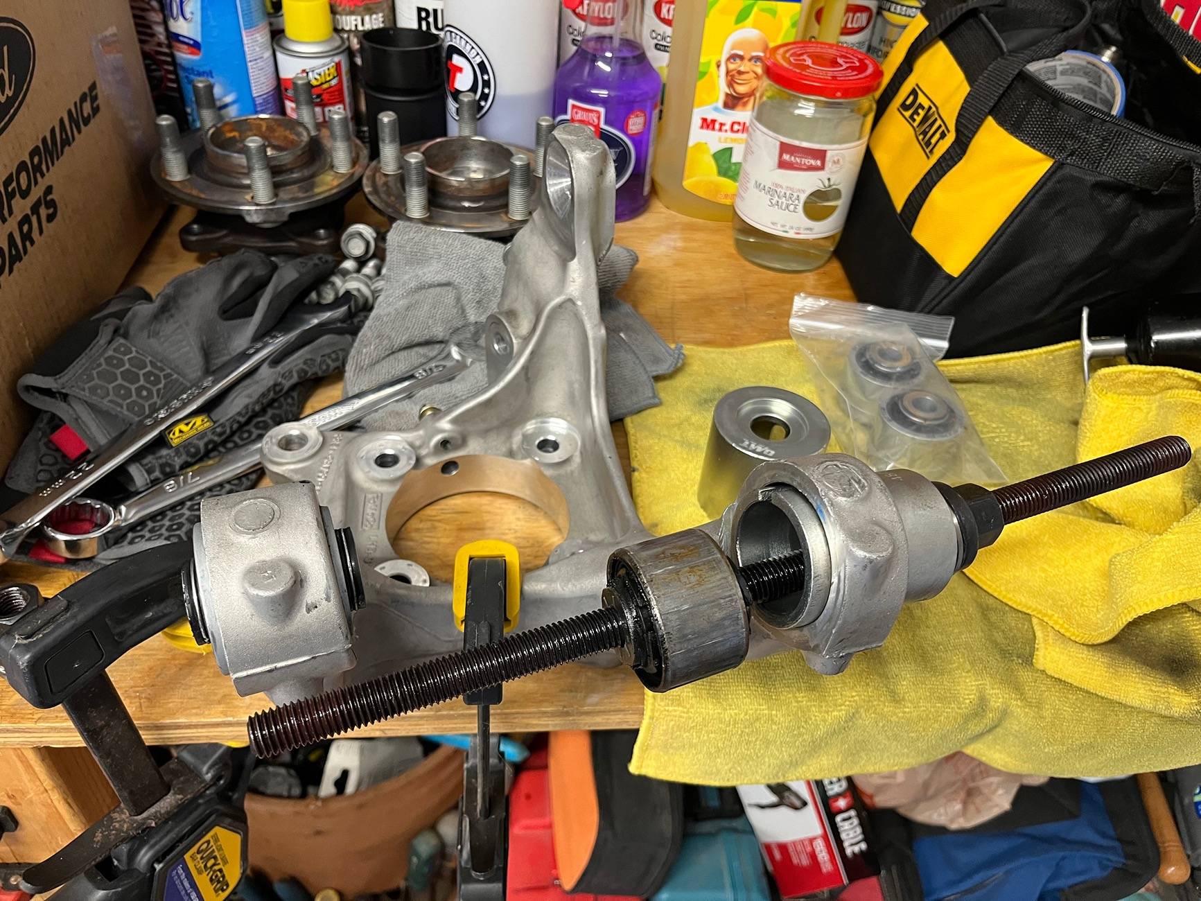

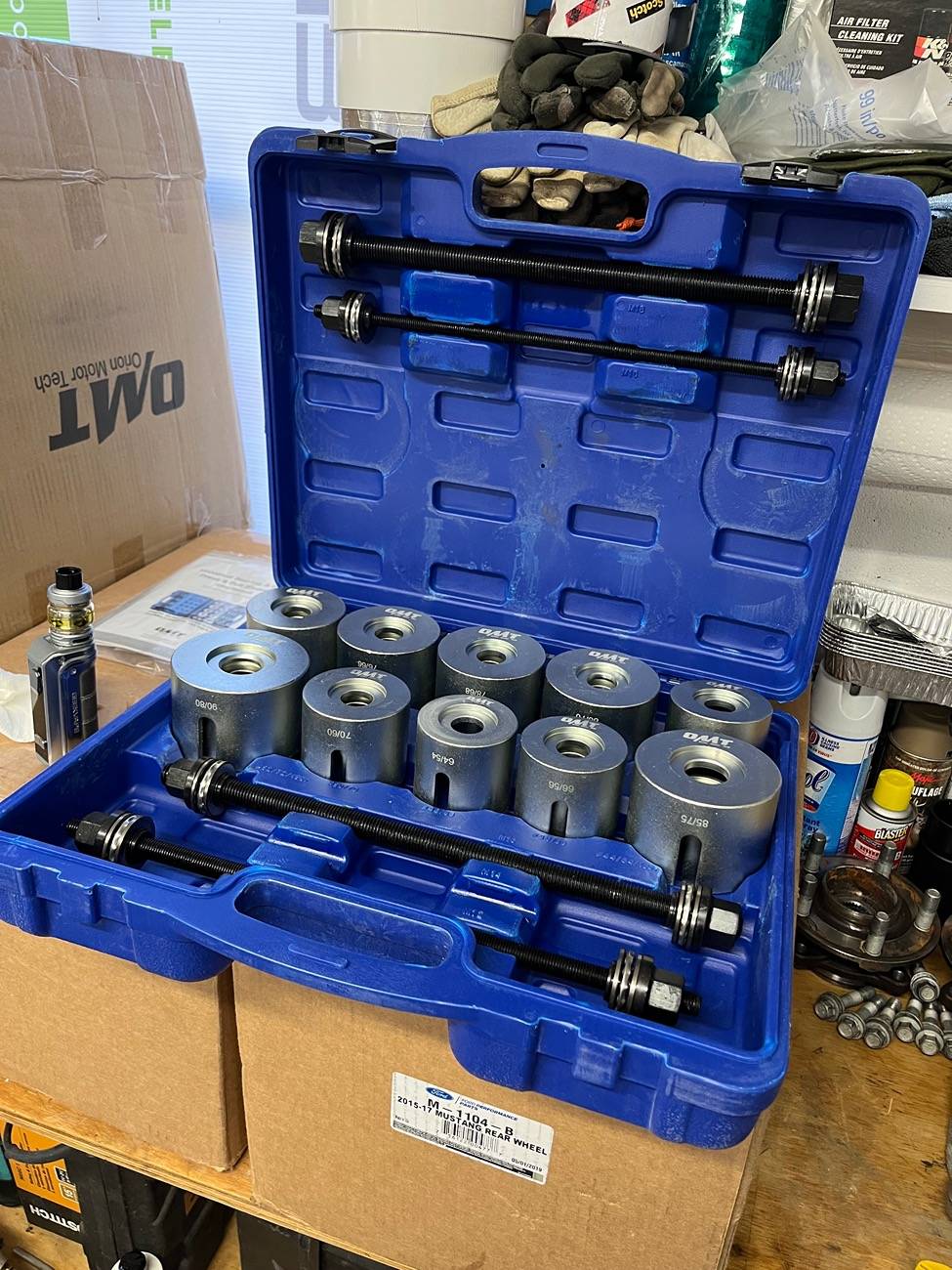

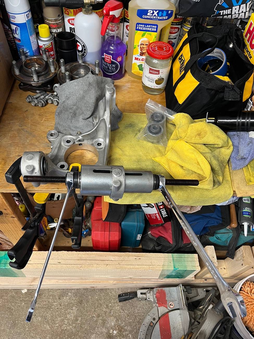

I just did mine over the weekend and it was pretty easy. I bought the OMT bushing press kit. This kit is high quality and made my install a breeze. Had both bushings out in 10 minutes. Highly recommend it.

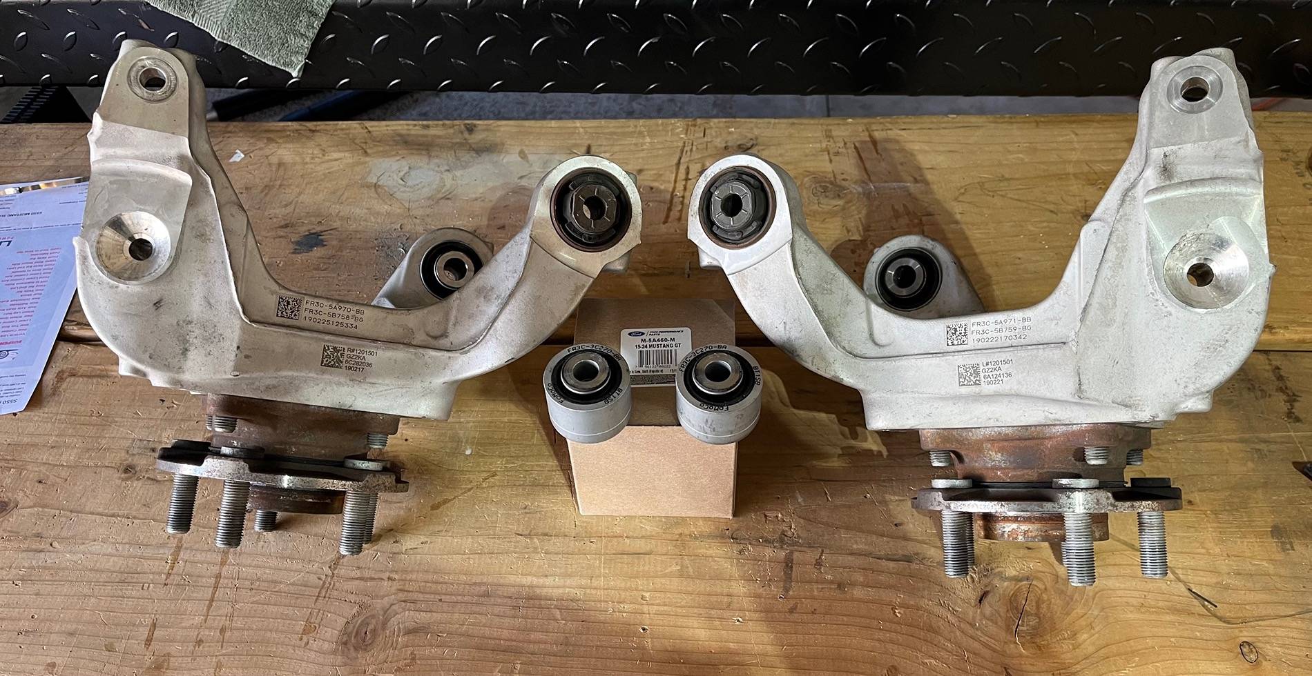

who ever said swapping the toe link bushings out and putting in the Ford Performance ones in was easy, was exactly right. I celebrated taco Tuesday at my favorite Tacoria, had 2 jumbo margaritas, swung by my local mechanics and they were done! Then I went home and took a nap!
