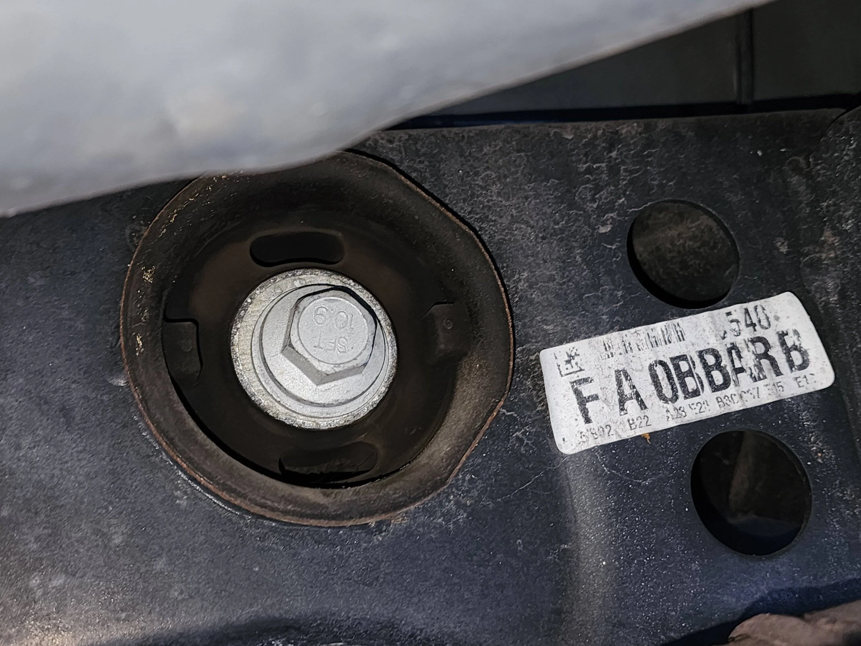

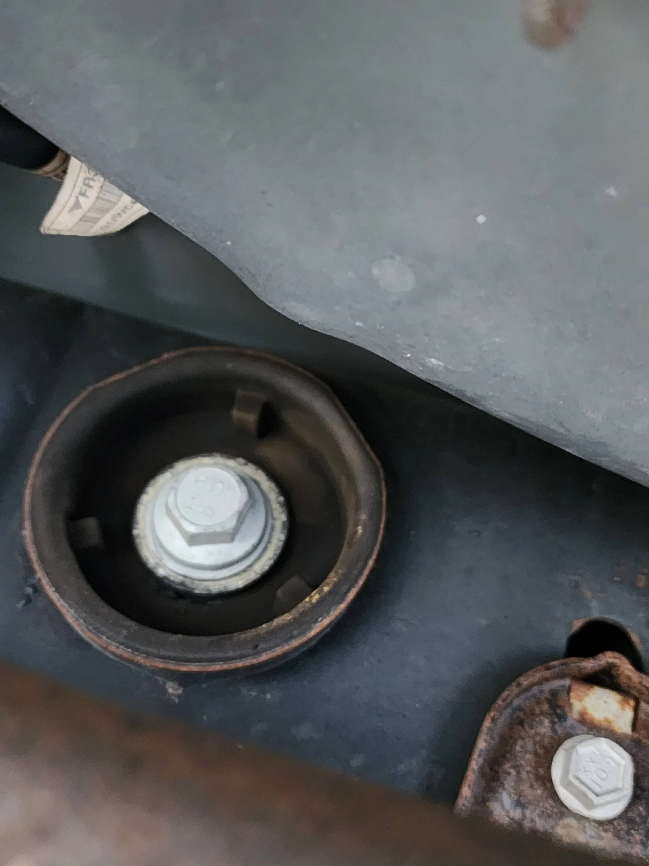

If it’s not that issue noted above, then also try to check the rear diff to pumpkin bushings…. Stock rubber ones are known to rip/tear.
I checked and looked fine. Here is the pic, idk why there is two holes up and down, is that by design. Also only the passenger side has holes and driver side doesnot.
