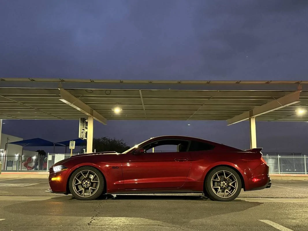

I recently lowered my PP1 on Steeda Progressive springs. At the same time, we did new wheels (LMR SP2 staggered set) and Nitto NT555 G2 in 285/35r19 and 305/35r19. For reference, too- this is a new car to me and my first S550. I had one Mustang long ago, but it was a 5.0 LX Fox Body.
Anyways- the car feels great- it's more planted, sharp, and of course looks the part. Thing is, I have noticed one new characteristic that bugs me. It's more obvious while turning left. Say I'm on a long sweeping left hand corner, foot on gas, car feels great until I let off the gas. When I let off, I get this loose, disconnected feeling from the rear end. It sort of sways to the outside of the corner. It's not a sharp or dangerous snap or anything, it just feels like what a bad bushing might feel like. It's not like the car is going to fall apart either- it's a small movement overall. Maybe it's just the character of a lowerered but otherwise stock S550. Oh, and it does it while coasting and turning right too, just doesn't feel as pronounced.
I have noticed one thing- and I didn't know about this until we (my friend and I who installed the springs) were done, but the rear subframe is shifted ever so slightly to the left side now. You can tell just by looking at the rear of the car and paying close attention. The left side tire is just a little more flush than the right. We loosened the 4 main bolts to be able to drop the rear springs out. I already have the Steeda centering kit on order, but maybe this is related? I feel like it has to be.
I'd appreciate any and all input on this. I'd really like to know where to look or know if I'm thinking too hard about this.
(Picture for your time)

Do you have the Steeda rear cradle lock-out bushings? The ones that lock the IRS to frame? I would do these at the same time you do the alignment bushings. Your loose caboose will be gone after that.
P.S. your car looks badass!

Looks like a lot of camber on that rear tire. Did you get an alignment after installing the springs? The alignment bushings will center the cradle.
It sounds like the IRS moving. Try the IRS braces if it still feels off after fixing the alignment.
