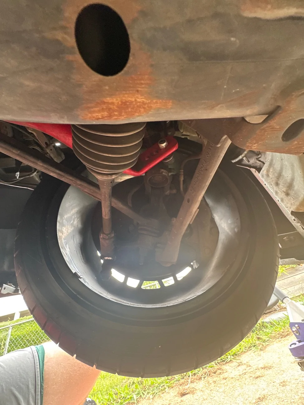

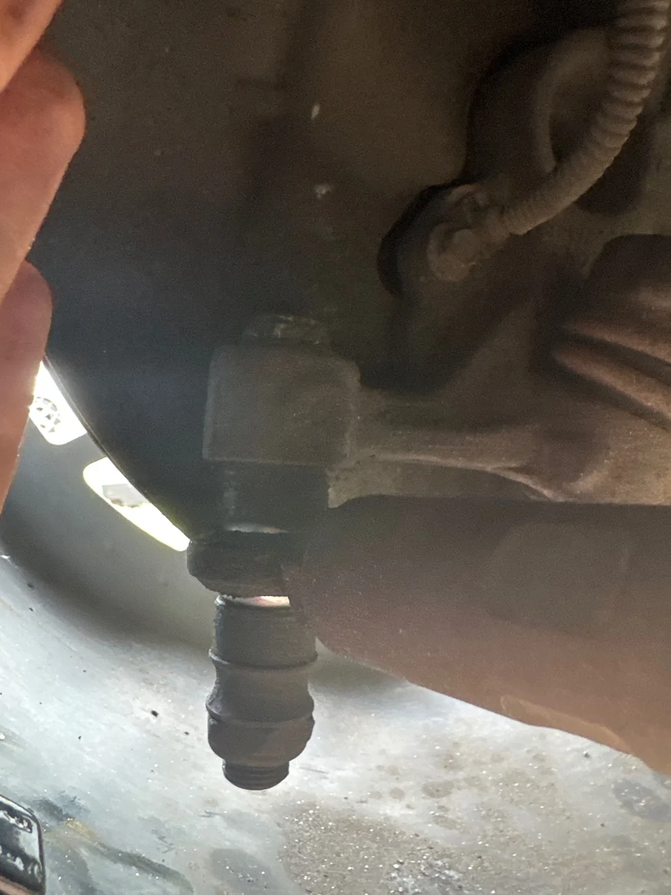

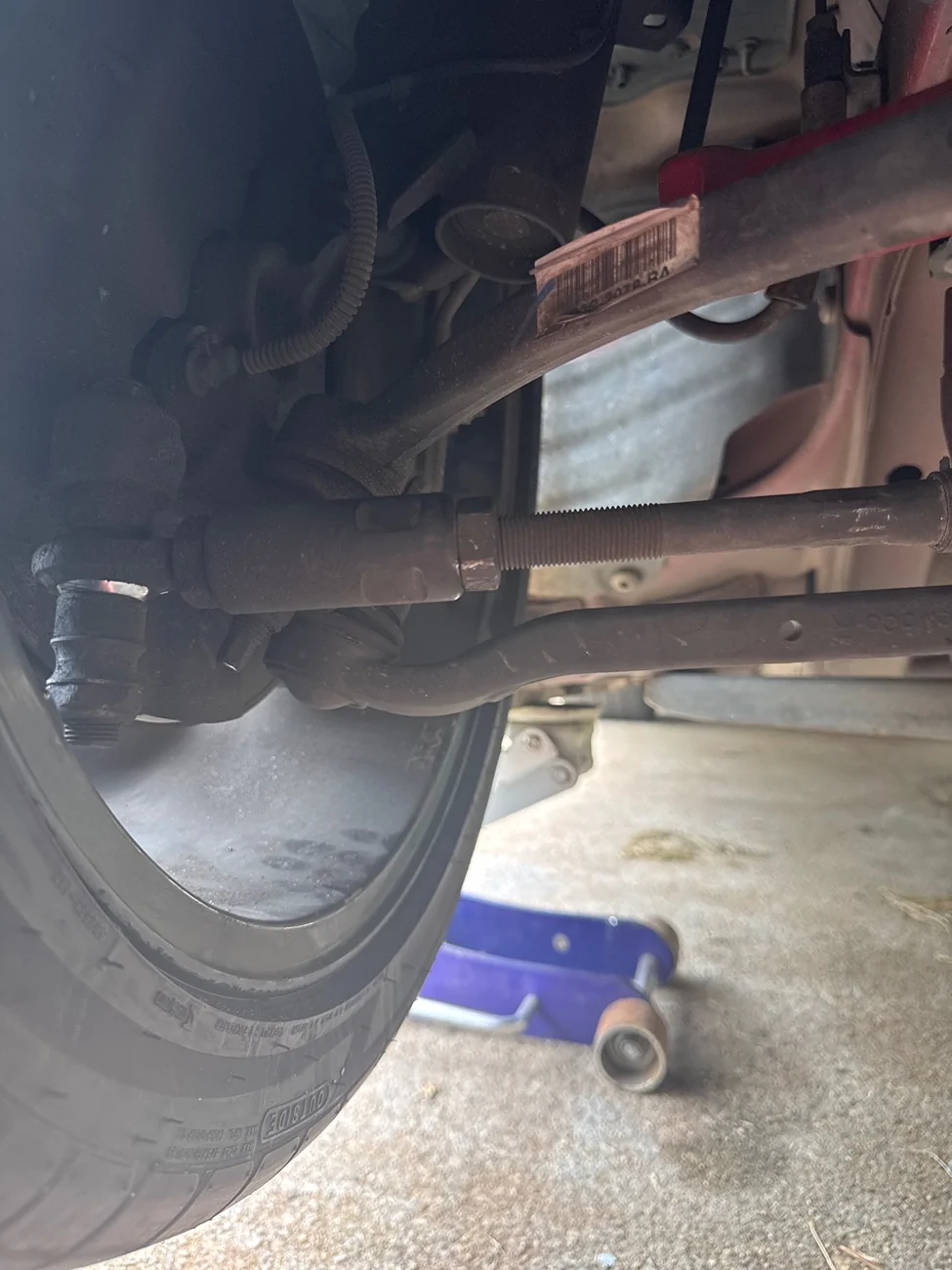

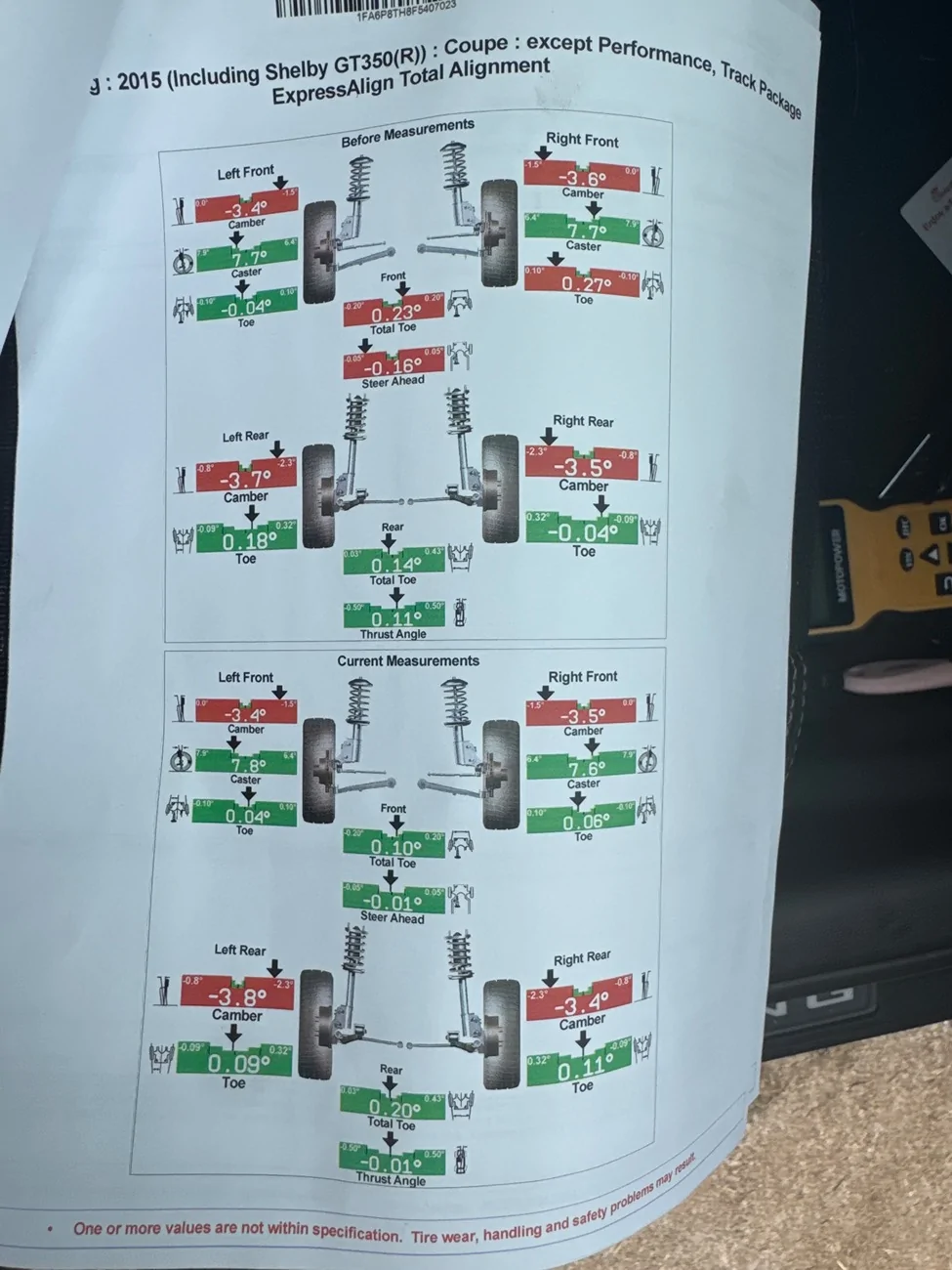

I recently got an alignment done and the only thing that was off since my last alignment was the toe. I believe this was because of the top nut on my bumpsteer kit on passenger side was not tightened properly. The car is lowered and cambered on bc coilovers with a j&m bumpsteer kit. running 285 tire all around. while driving after the alignment was done i noticed heavy bumpsteer going over any uneven part of the road almost as if my car was in a death wobble. i will upload photos of the alignment sheet and of the setup underneath.
