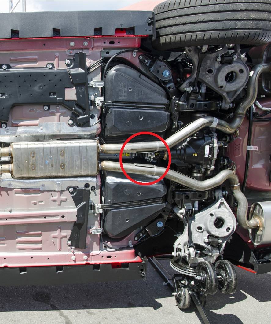

While getting my rear diff fluid changed, I had my mechanic check out that exact same noise, and he said the CV joint connecting the driveshaft and rear diff had a lot of play.
I'm pretty ignorant when it comes to driveline stuff, but I get the exact same sound when shifting into D or R from a stop.
