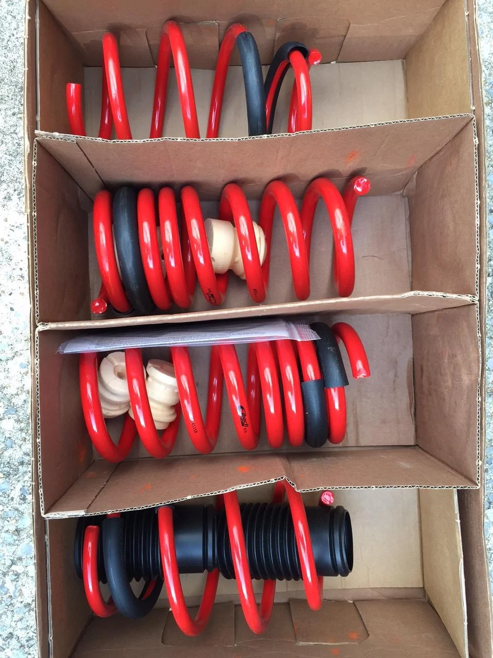

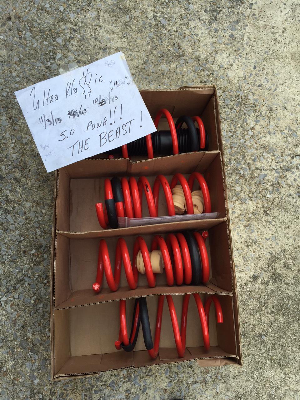

Ok either you guys got ripped off, or lost your insulators or paid somebody to do the install for you and the moron didn't use the insulators that come with the springs because here are mine STRAIGHT OUT OF THE BOX about to go on my nephews car.
I'm not saying that IS your problem but I've used Eibach Sportlines on every Mustang I've owned and they've ALWAYS come with these insulators wrapped around the springs.
