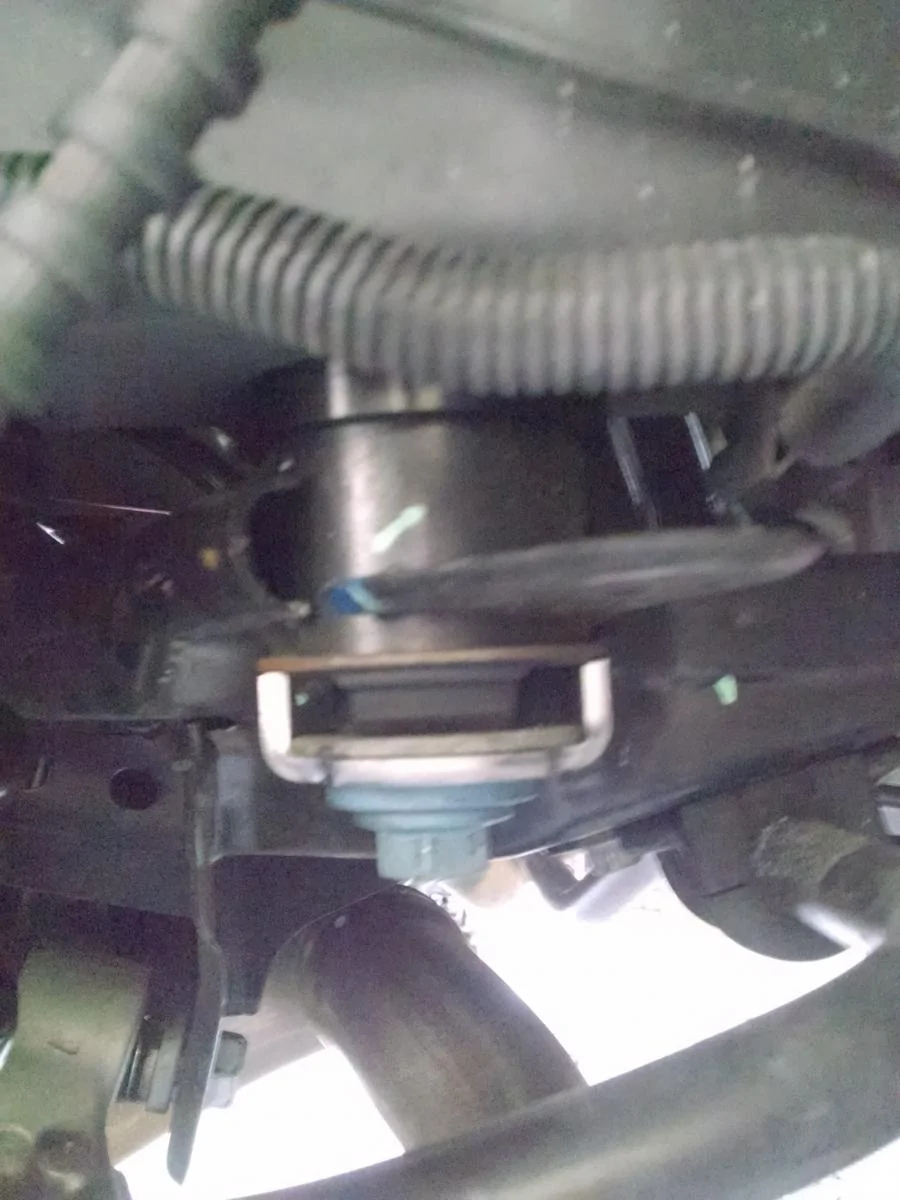

turns out it was a loose bolt on the rear driverside control arm. Strange as it's not a bolt that has been touched during any of my installs. after looking at the two bolts only one of them was kinda accessible to me and it was this one. i don't have any wrenches that big and the exhaust is in the way of using a socket so i had went with an adjustable wrench. it was definitely able to be tightened down. The Passenger side however was already as tightened down as would be able to get it by hand.
This is the bolt:

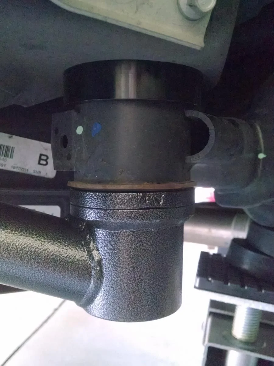

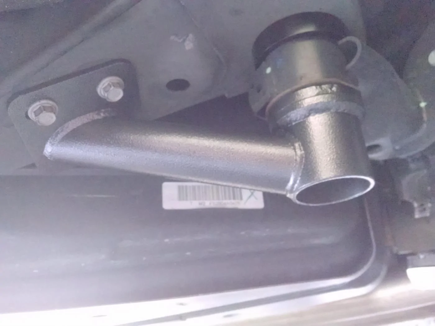

Also just because i installed the kit today, i figured i'd include pics of the CB005 kit installed. Sorry for the terrible pics. I choose to carry around a busted phone.

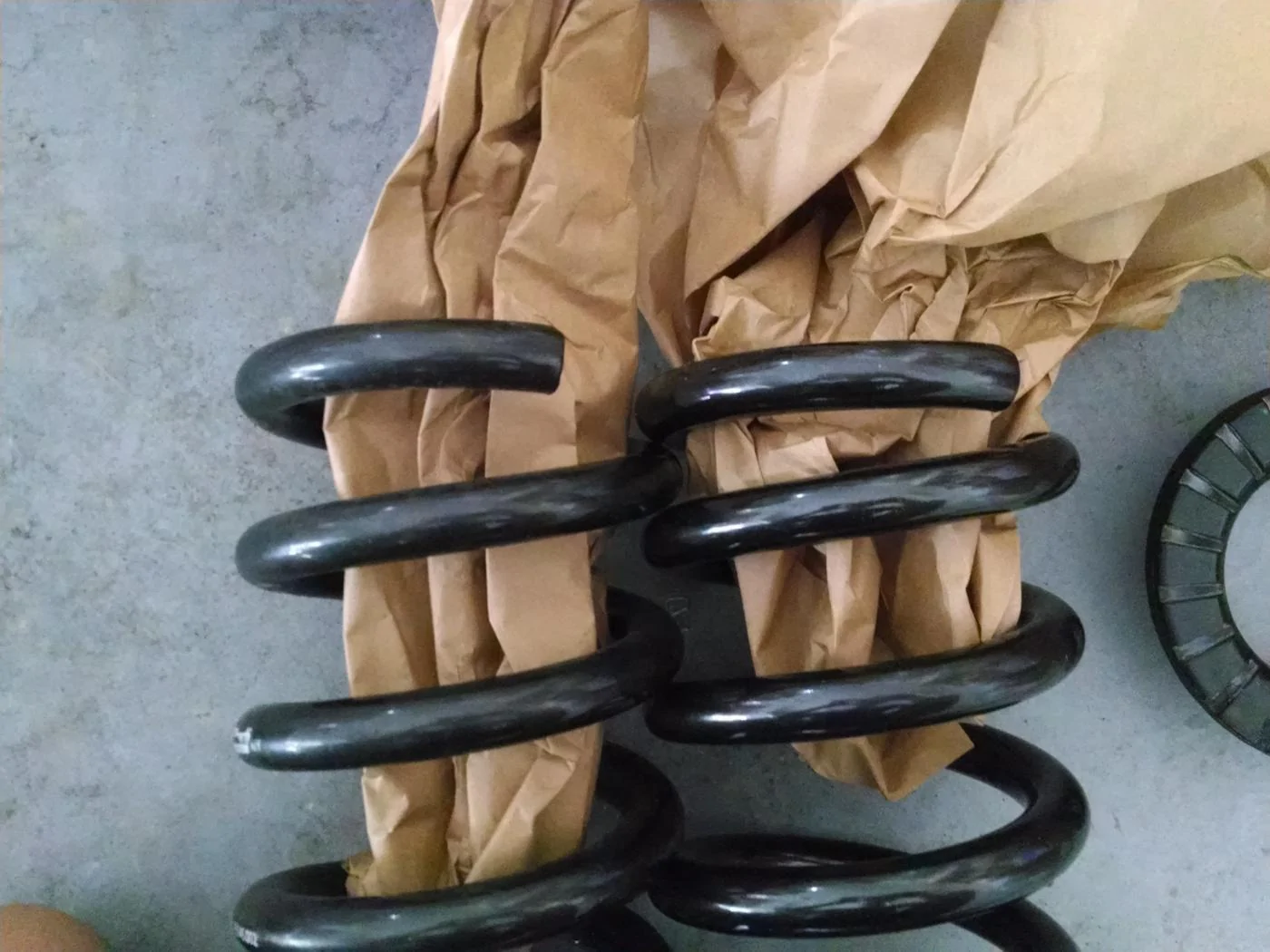

Also for good measure a pic of the springs. Original on the left, replacement on the right. The gap up top at the end of the spring is considerably smaller, not that i'm sure that really means anything..
