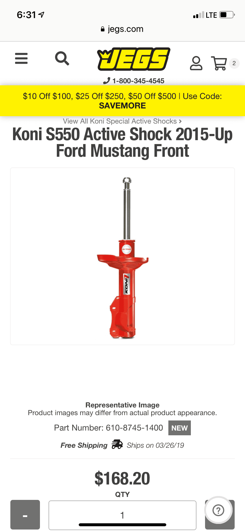

So Jegs is selling them but Koni says they won't be available until May/June? The only thing I can see that might explain it is that the Jegs listing is for 'Active' whereas the email from Koni refers to 'Special Active'. Otherwise it doesn't make sense or I'm missing something.
@Humphammer would you possibly be able to go back to Lee Grimes @Koni please and ask if these dampers will work optimally with cars that have higher spring rates or have been lowered, or if they've been developed for stock springs only. If so would that be for PP or base GT? Happy to do so myself but he seems happy to respond to you and would probably refer me to the Australian distributor.
I don't have an answer for why JEGS supposedly has them, but the Koni's have been developed for the PP and base with stock springs only. There are so many combinations of lowered springs Koni would have a hard time developing them to work with all. If you want the Koni Active to work well with lowered springs I would suggest going with Steeda. I am mostly interested in improved ride quality and will opt for the Koni's when they become available.
