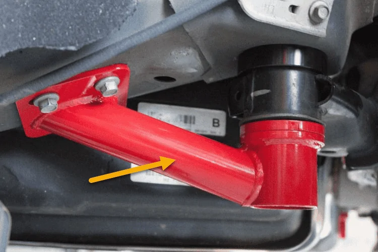

Ah dang. Thanks @StangTime.
Keep me posted. I may end up doing the same because I've replaced and/or re-greased nearly part beside this piece, took off all my interior panels and lined them with jute... but this persistent squeak/creak always comes back some how only in the rear passenger side.
Hey @baevid I had some time last night to investigate. I placed my floor jack under the passenger side lower control arm and started lifting. The resulting noise transmitted through the body was hideous. Lowered and raised it a couple times and the noise persisted. So I removed the BMR brace (I left the bushing lockouts in place) and put the stock one back on. Lowered it and raised it a few times. No more creaking! Hmmm... Didn't have time to road test. Loading the suspension by lifting the control arm is quiet now. Hopefully it stays like that.

I'll definitely have to sift through my parts bucket to find my stock braces then, it's been some time. These still fit fine as is with the bushing lockouts?
Yes. Just remove the large subframe bolt and two smaller bolts. Take the BMR brace off and re-install the OEM brace and torque the bolts. Large bolt is 129ft-lbs and the small are 41ft-lbs.
Try jacking the lower control arm first to see if you can reproduce the creak.

@StangTime Just to be sure since I forgot how to OEM stamped metal brace sits, you only swapped this brace out? I'll have to go look under my car after work today since I'm having a brain fart but I think I have the CB762 in addition to this.
That's correct. But I did this on the passenger side. The drivers side was already off the car for another reason and the noise was all on the passenger side.
The CB762 will still work with the factory brace like this:

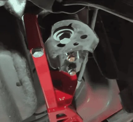

Update. After removing the CB005 brace and replacing it with the original factory brace, leaving all other IRS cradle lock out parts on the car, the squeak is gone. Verified this by rolling in and out of my driveway. There is a little drop off that would induce the squeak consistently as the weight of the car body would load the suspension. I went back and forth a few times and heard nothing. I'm going to post a picture later of the CB005 and the contact marks that are inside the cup where it touches the rubber IRS bushing.

Good luck. I'm confident the noise is coming from the bushing rubbing inside the metal cup of the CB005 brace. I even tried fluid film to lubricate it and that didn't help.

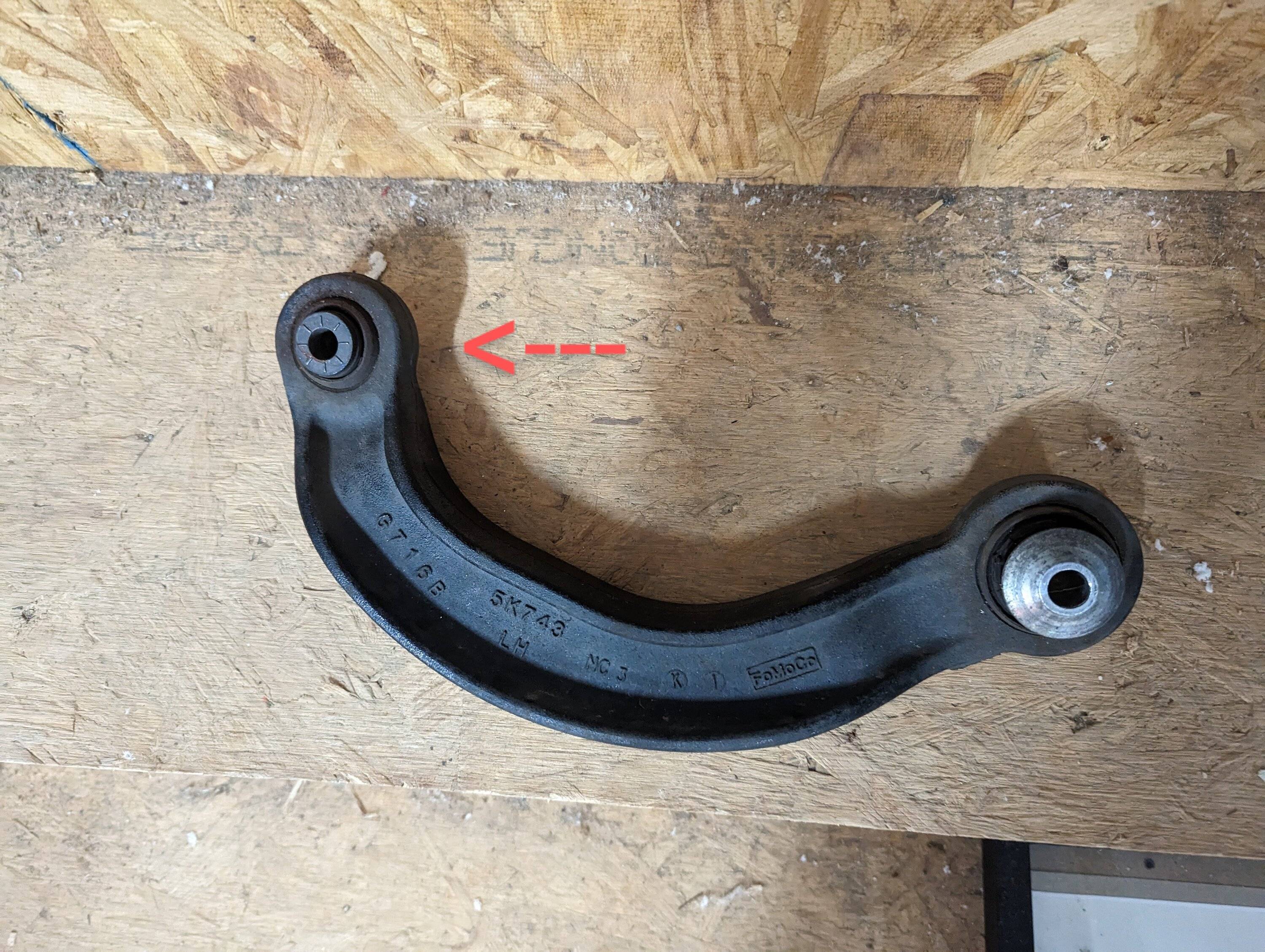

Edit: I have had the bmr cradle lockout kit, diff bushing inserts, and vertical links for almost 8 years/65k miles.
I'm pretty sure mine was the rear camber arm bushing on the body side. But I could be wrong. To diagnose I removed the spring and shock and moved and whole knuckle assembly up and down manually (it's heavy) to verify the creak. Then I started disconnecting links one at a time until it stopped. Mine stopped by disconnecting that arm. I replaced it with an O'Reilly's part (Precision Control Arms) and it did completely disappear. BUT it seems to have returned 6 months later. So I might have been fooled, or gotten a bad cheap part. It's got a 1 year warranty so I'll be taking it apart again soon. BTW this is the drivers side camber arm. The expensive aftermarket ones have a grease fitting here.
