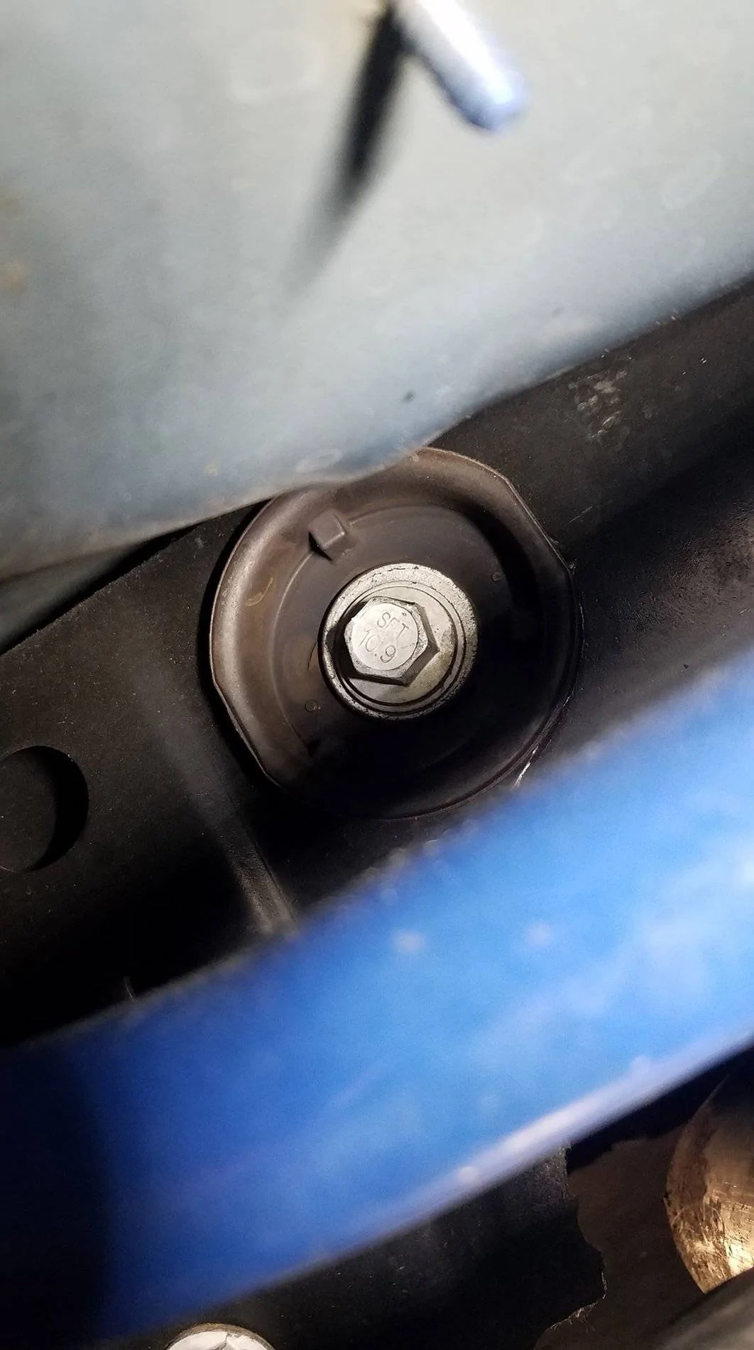

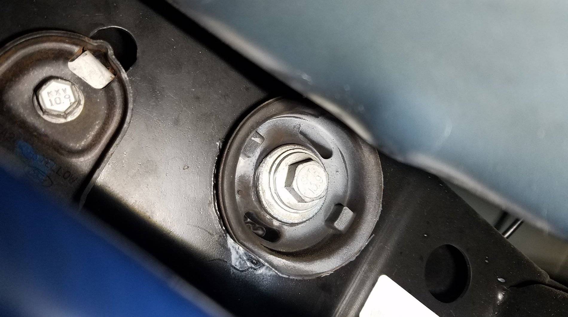

Best I could do today is to send these pics laying on the ground lol, no time to jack the car up. Drivers side might have a tear

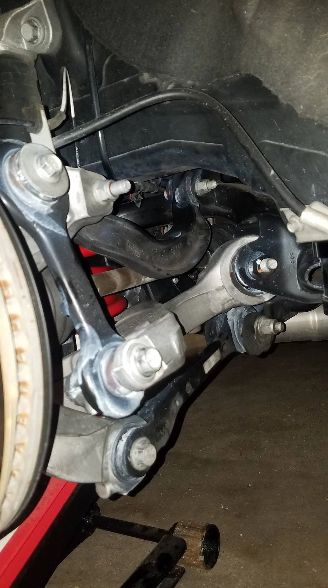

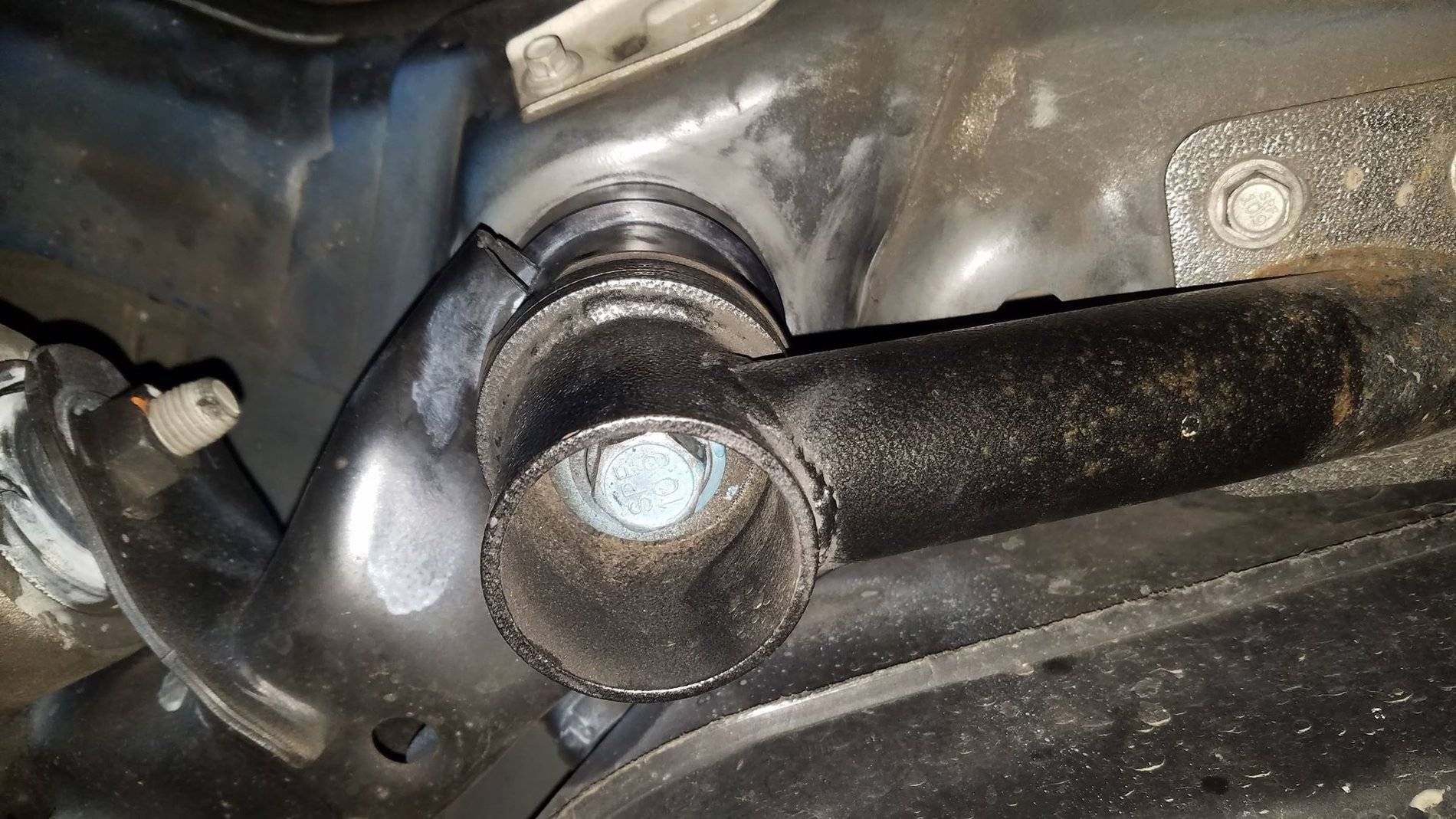

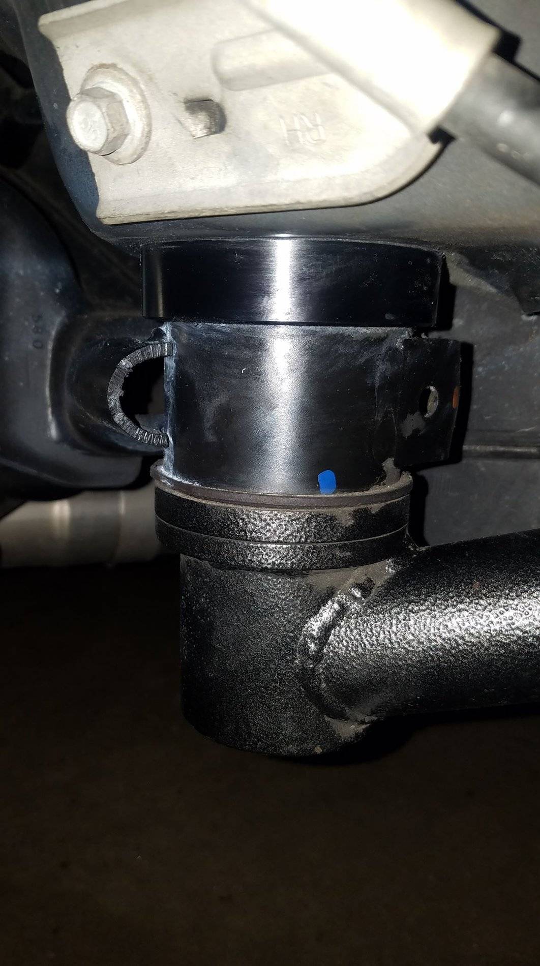

Update! I got out and felt like I really narrowed it down tonight after playing with the jack and getting the sound to happen. It really sounds like its coming from the cradle lockout or very close to that area. Please see my video and pictures and let me know

What are you doing in the video that replicates the creaking?
Jacking the passenger rear suspension up and down with a floor jack. It also made the sound when jacking up the front passengers side frame rail earlier in the night, almost more.

If you still have the factory brackets that BMR CB005 replaced, I would try removing the kit from the car both on front and rear of the subframe and mount the factory brackets back completely and see if the noise will persist, Just to rule out the BMR kit. If the noise goes away you want to thoroughly clean the kit and the body before mounting it back on the car.

Any other ideas? I couldn't get my ear close enough to confirm the lockout

I don't think you need grease, because you want the cradle to lock onto the body, my guess is that dirt and debris made their way between the mating surfaces and they cause the squeak. But before you do any of that try having your car's under carriage thoroughly pressure washed to get rid of all the grease and dirt from underneath the car. having grease on some of the pressed bushings( like the ones on stock vertical links) is not good. I did that mistake on my dad's Mercedes trying to silence a squeak and its lower control arm slipped off of the pressed bushing(Granted it was a worn control arm but had I not silicon greased it, it wouldn't have slipped off.)
