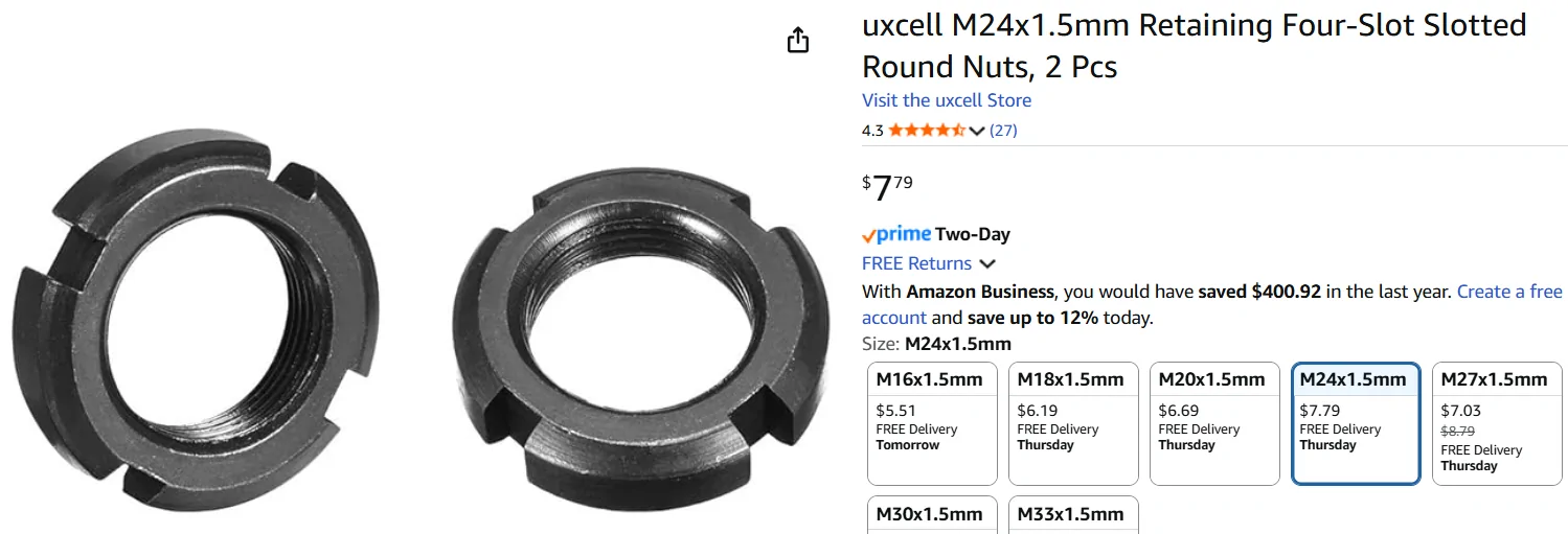

If it’s the driver’s side and you didn’t threadlock the hell out of that nut, then the issue is not the bearing, it’s ford’s choice of axle nut system.

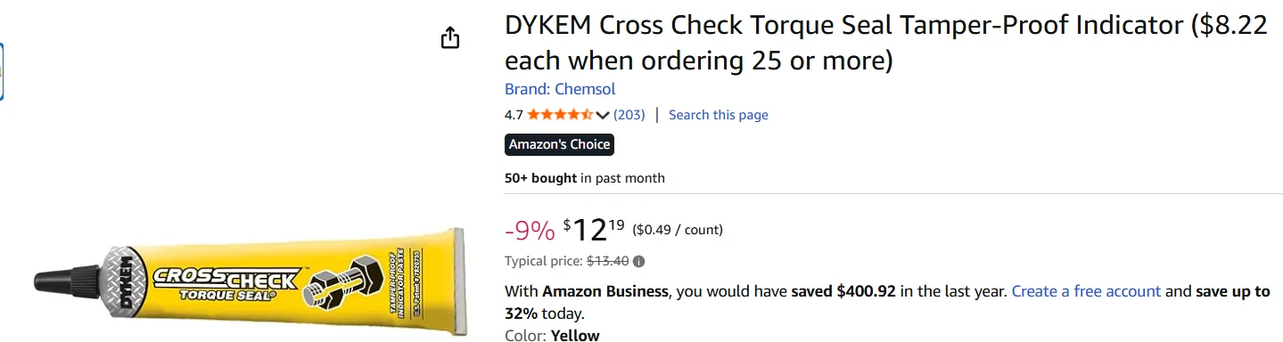

I use These thin jam nuts Carbon Steel and Torque Seal. Good Luck
