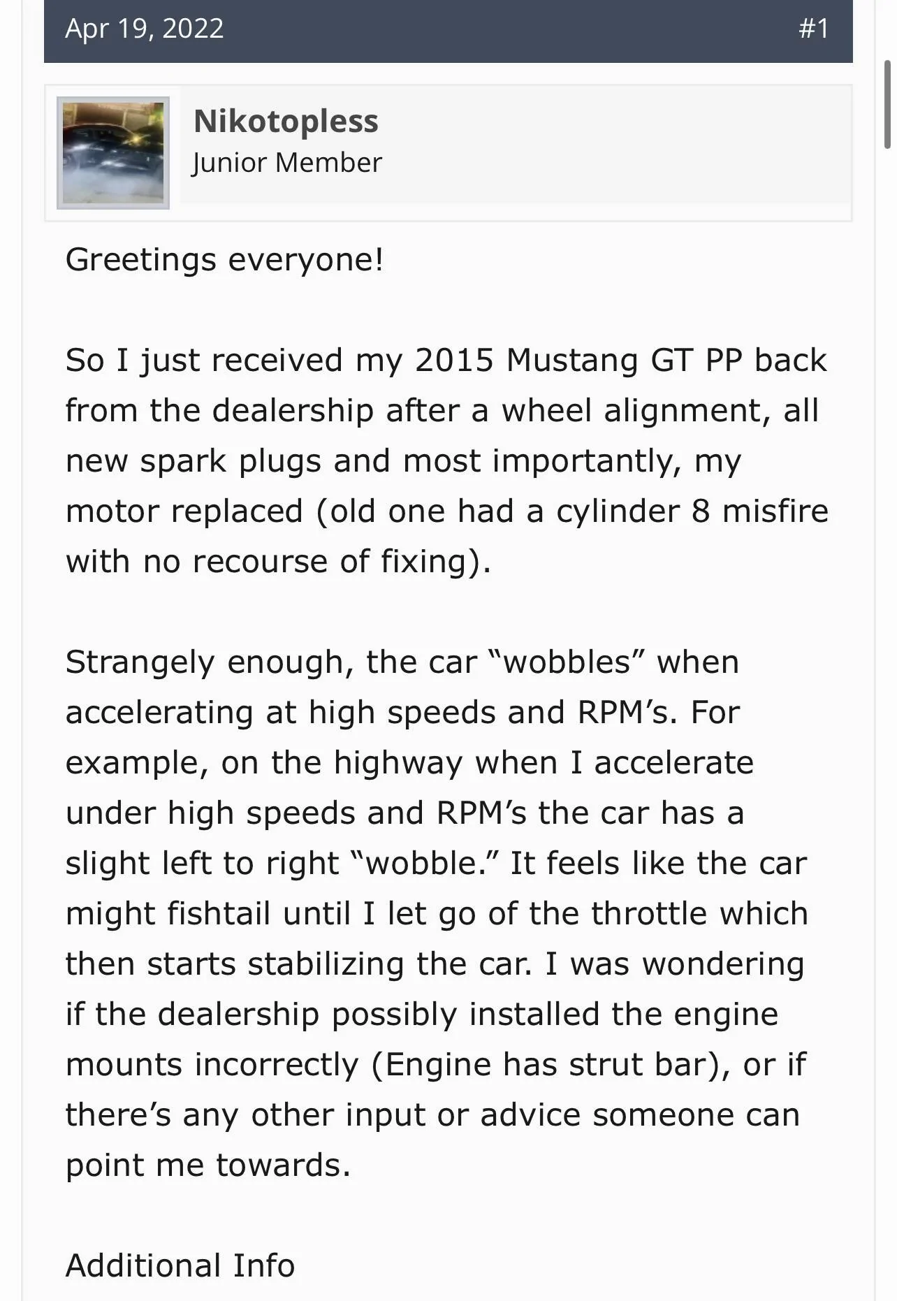

The picture below is an accurate description of what I’m experiencing. But still can’t find a solution.
