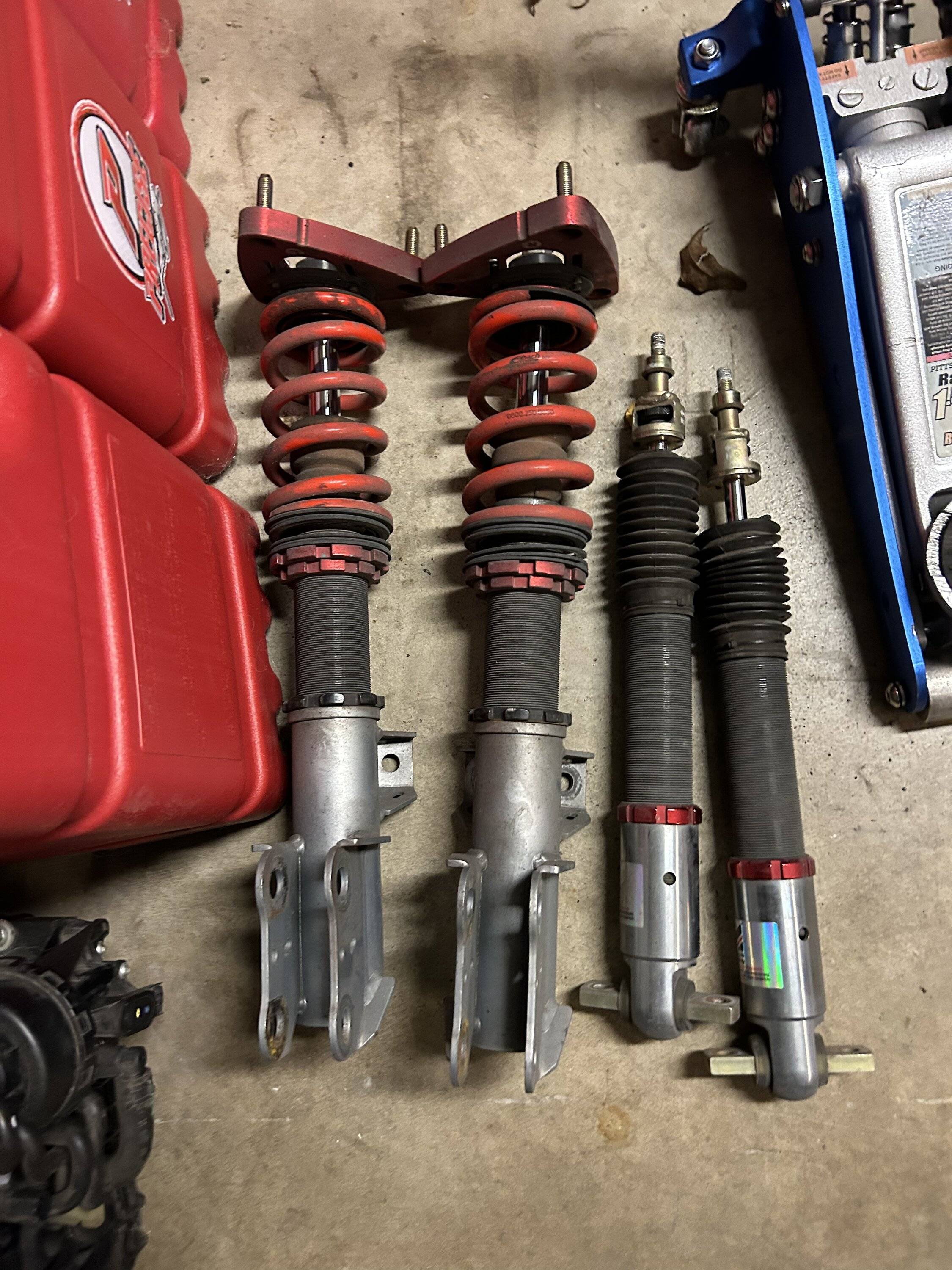

Its just all road grime back there.

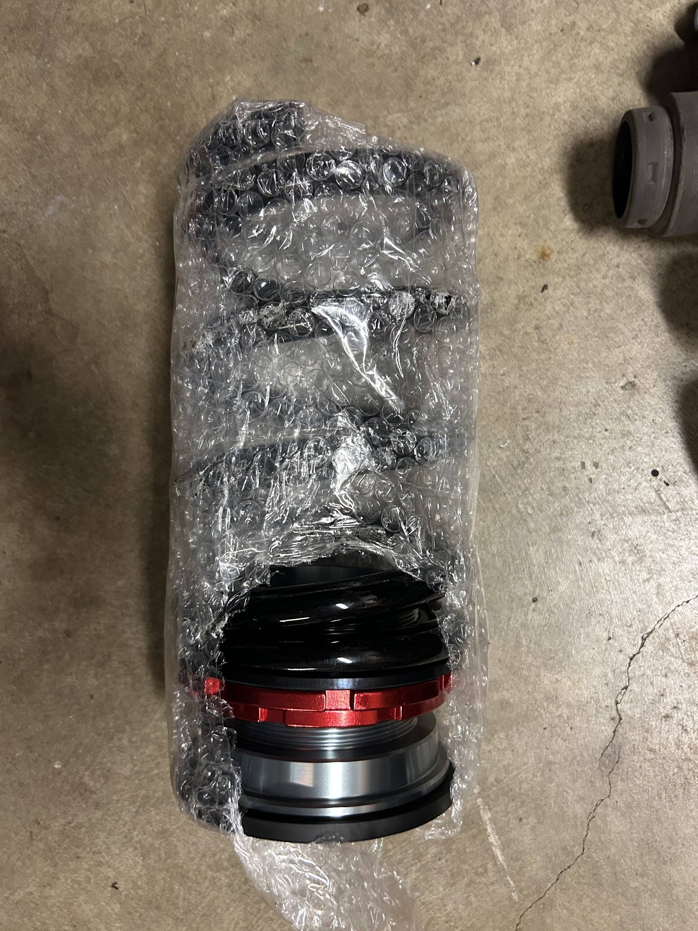

Heres the coilovers off the car. I’m running a stock like spring in the rear (steeda dual rate) cause it works fine for my application. The coilovers came with adapters for std springs but I just left em in the box cause I like the rates I’m on.
I thought u were running the spring conversion you spoke of, I must have misread that.
