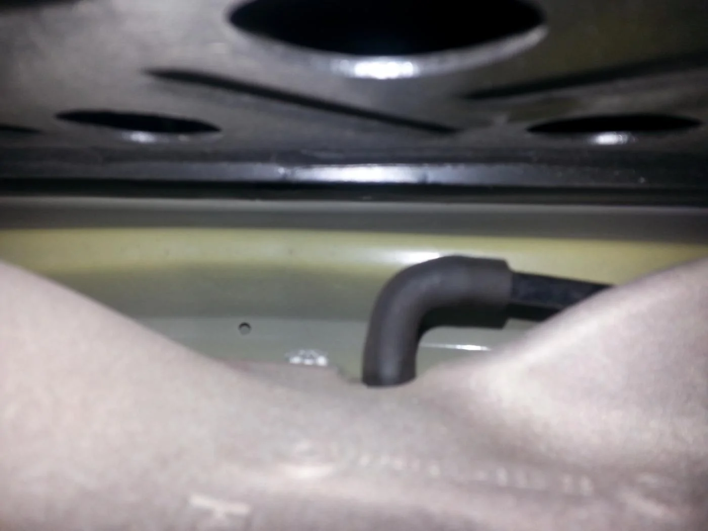

This is a photo looking up at the 3.15 diff on my 2016 auto car. Is the black line with elbow the temp sensor?

I wonder if Ford did anything in the 17's to improve on the diff cooling ?

As I was trying to figure out what model cars had the diff sensor, I walked around a large ford dealership with quote a few 17's. It appears there is no change for 17. FWIW, I think changing the fluid to a 75w110 or higher makes it good enough for track days in the summer.

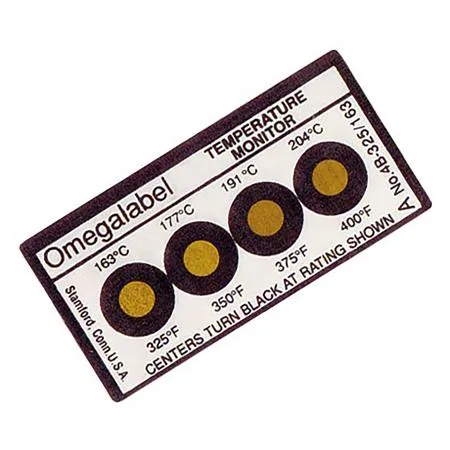

Also, I looked into stick-on temperature strip gauges and found these (for non-PP cars):
P/N 4A-280 provides 280-290-300-310F dots (~$30 with shipping for a pack of 10). The center turns black upon reaching the labeled temperature.

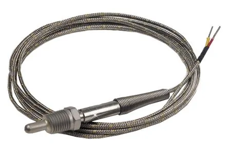

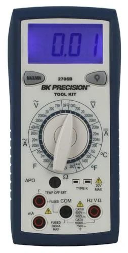

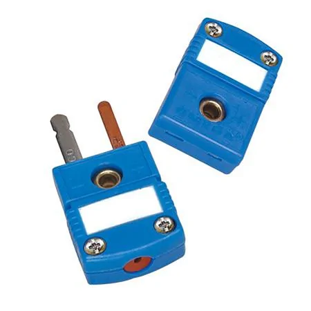

Also available from Omega, and having the potential for a more exotic setup is this temp probe. I don't know if the diff casing is tapped for a NPT hole, but I suppose one could be put in it.
Either run the leads to a data input somewhere, or at least run the cable to the rear wheel opening, and then put on the K-type connector. Then you could simply plug in your K-type DVM to get a reading in the pits, lol.
