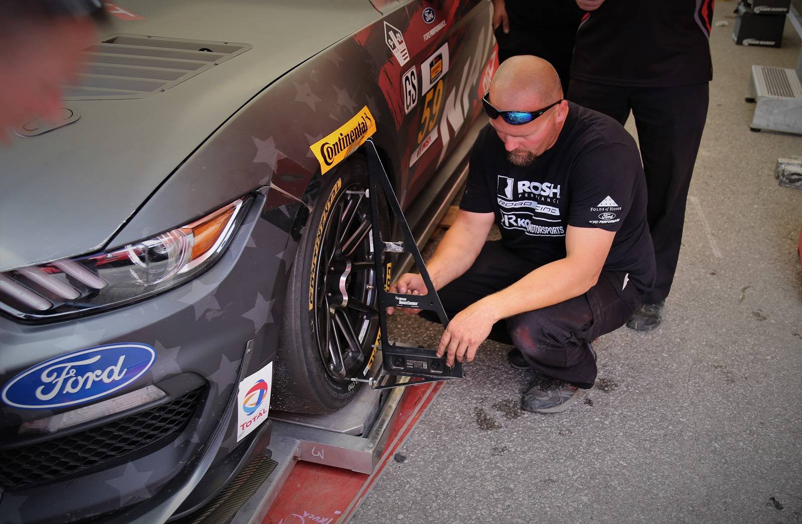

Everyone has their opinion or point of view, I get it. I was lucky enough to have been embedded with a GT4 effort during the 2018 season (the last for Continental). You see first hand and near immediately the changes on the track as a result of a tire change or a suspension adjustment. I talked to the drivers at every race about the track itself and listened firsthand when they commented on track conditions as well as that of the car, etc. You can dial in the suspension settings, alignment, etc, prior to the race but when it counts it is all about the tires.
Here's my good friend Tom at Road Atlanta checking camber. They were running near -4*.

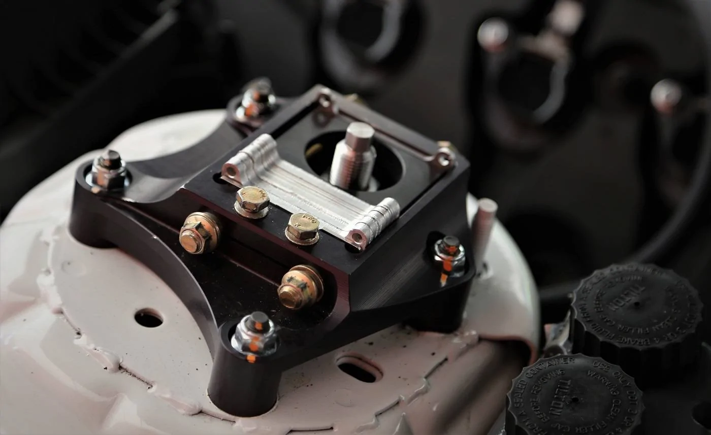

And of course, accurate and repeatable (as well as quick) camber changes can benefit the car and be used to tune for different tracks, etc. The "plates" from Multimatic are fantastic in this regard.

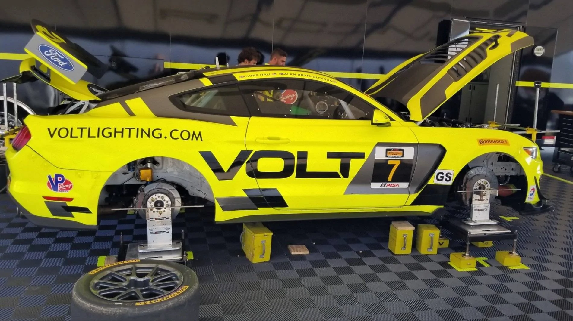

I watched different teams set their cars up at the same tracks. It was interesting to watch and talk to the Volt team in '18 as they strung up their car. I set my own car up the same way, albeit without the $hiny equipment they use.
