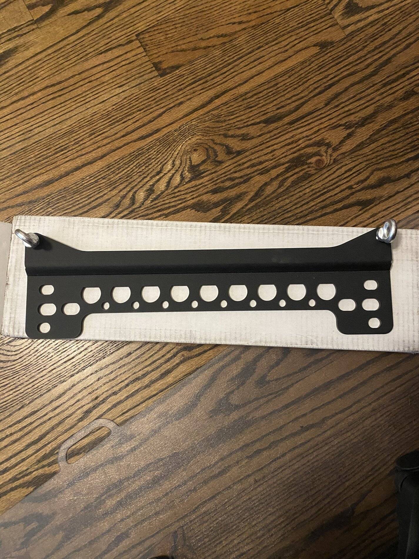

Who knows what it is????

Aftermarket seat rail

Racing harness going in. Are you going with the Schroth Quick Fit Pro and adding the anti submarine belts, or the roll bar wrap around version?

An anti submarine belt should work perfectly with the Recaros and that Watson bracket. You can run the belts between the seat cushion and seat back.

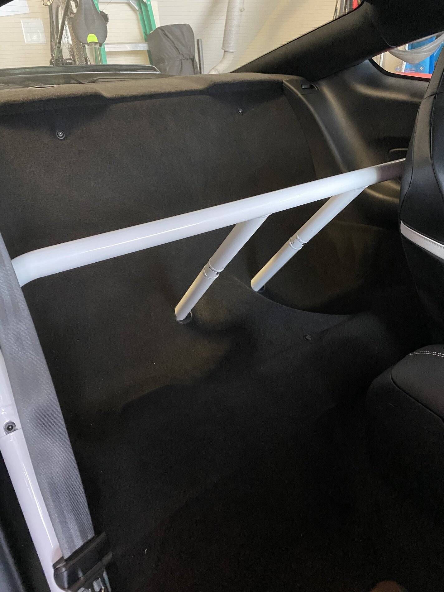

Winner. I put in a harness bar with the intent of a crotch belt but that plan just wont work with the factory Racero seats. For now it's a 4 point with the ability to add a HANS device.
https://www.mustang6g.com/forums/threads/harness-mount-going-in.159210/#post-3243530
Looks great. Got mine last week from Watson as well. I don't want to be that guy...I have no choice, how far below the collars in the seat does that bar sit? I only ask because I had a long convo with Scroth rep and he was adamant that the ASM wouldn't work as designed if the shoulder belts made a hard "^" angle. Im not trying to mess you up, just a saftey thing im concerned about
