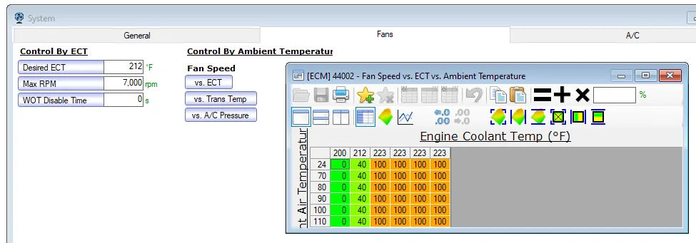

For those that are actually looking for accurate info, here is some.
This is a screen shot of a factory tune on an '16 GT. The graph shows desired fan speed (as a %). Vertical axis is ambient temp, horizontal axis is engine coolant temp.
The only way I know of to change this is to reflash the tune. The comment about using Forscan to make this change is in error.

I'm certainly not new to cars, but relatively new to S550 Mustangs. I'm just trying to post the content I wish others would post so we can all actually learn something, hence the HP Tuners screen shots etc.
