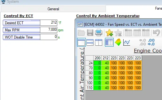

When the AC is on, fans are just about full blast so yes you'll experience cooler temps.
Otherwise the ECU targets 212* (100* C) engine temperature, so you getting to 103* then coming back down seems perfectly in order.
Fans are completely off until 212* at which point they come on 40%. By 223* they are full power.
Thank you so much for this detailed information. MUCH APPRECIATED
