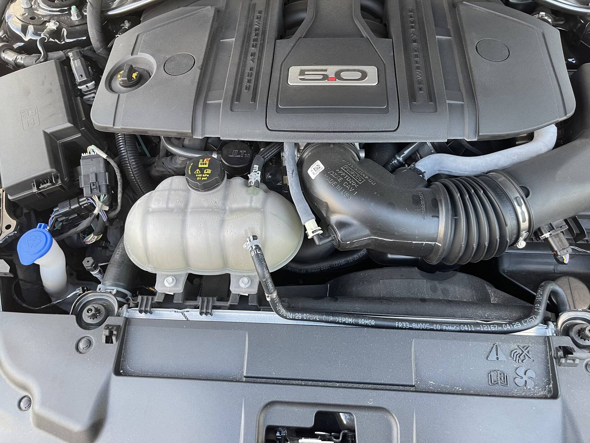

Okay so when I just had the motor on only the fan on the right would run. It will be on your right when facing the engine bay. The left fan which is the lower fan only turned on when I turned on the AC. That fan is under the coolant tank.

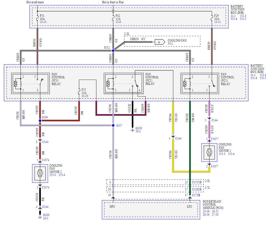

Abit long reply, but I was doing same thing ( going from 2 -> 1 fan ). Here is electrical circuit. So its either one of them working, or 2 at the same time, but in 2-fan mode first fan gets ground in series through second fan. To fix that, first FAN should have permanent ground as its controlled with 12v side.

That's not how the ECU actually actuates them.
The norm is that for low speed operation it's both of them at low speed (series), high speed is both them at high speed (parallel).
They are arranged this way for simplicity of operation, fault tolerance and lower noise.

You are right. I've looked again at the schematics, They achievie switching between series and parallel mode with FC2 relay, which makes fans run faster/slower
